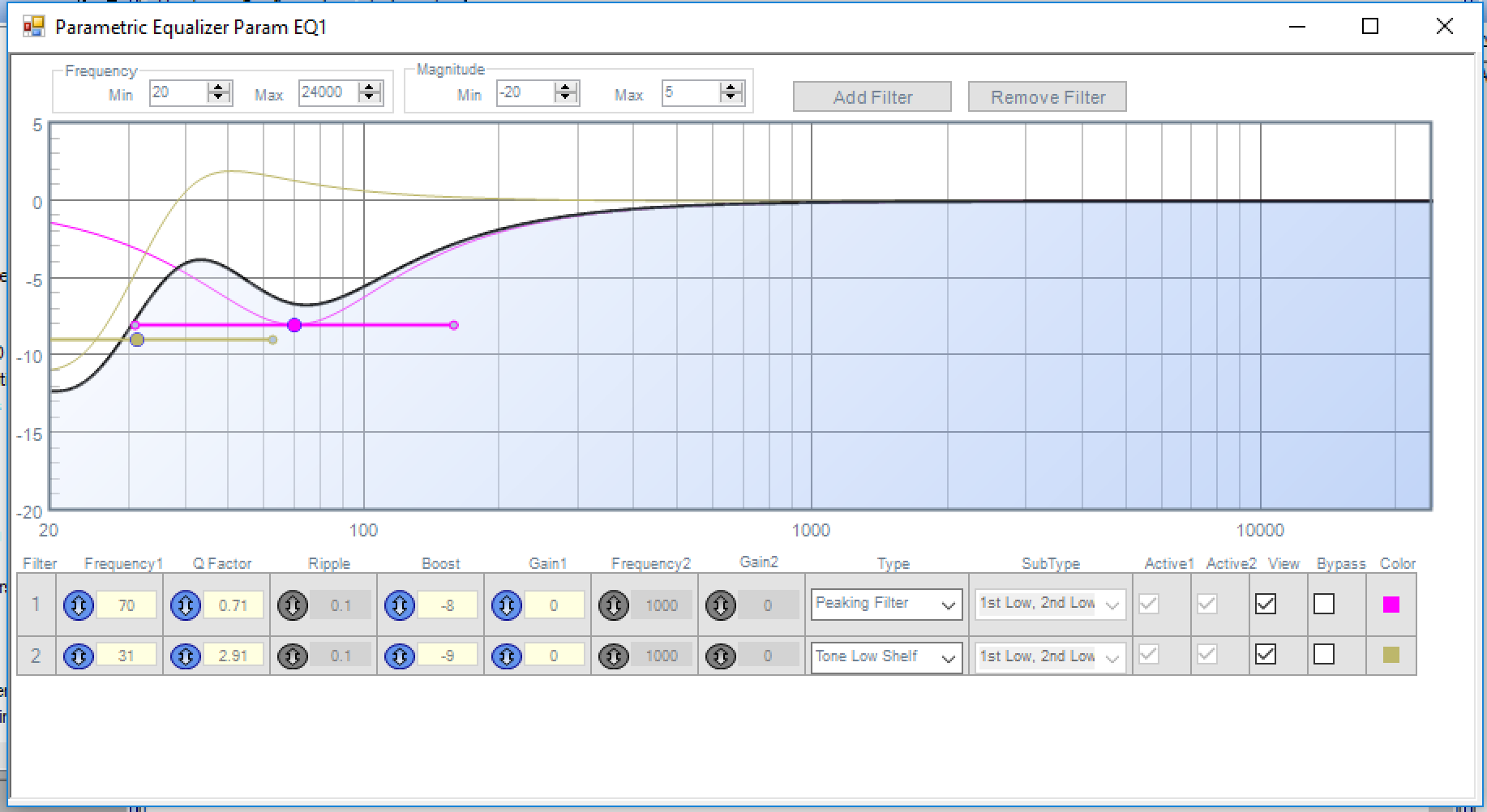

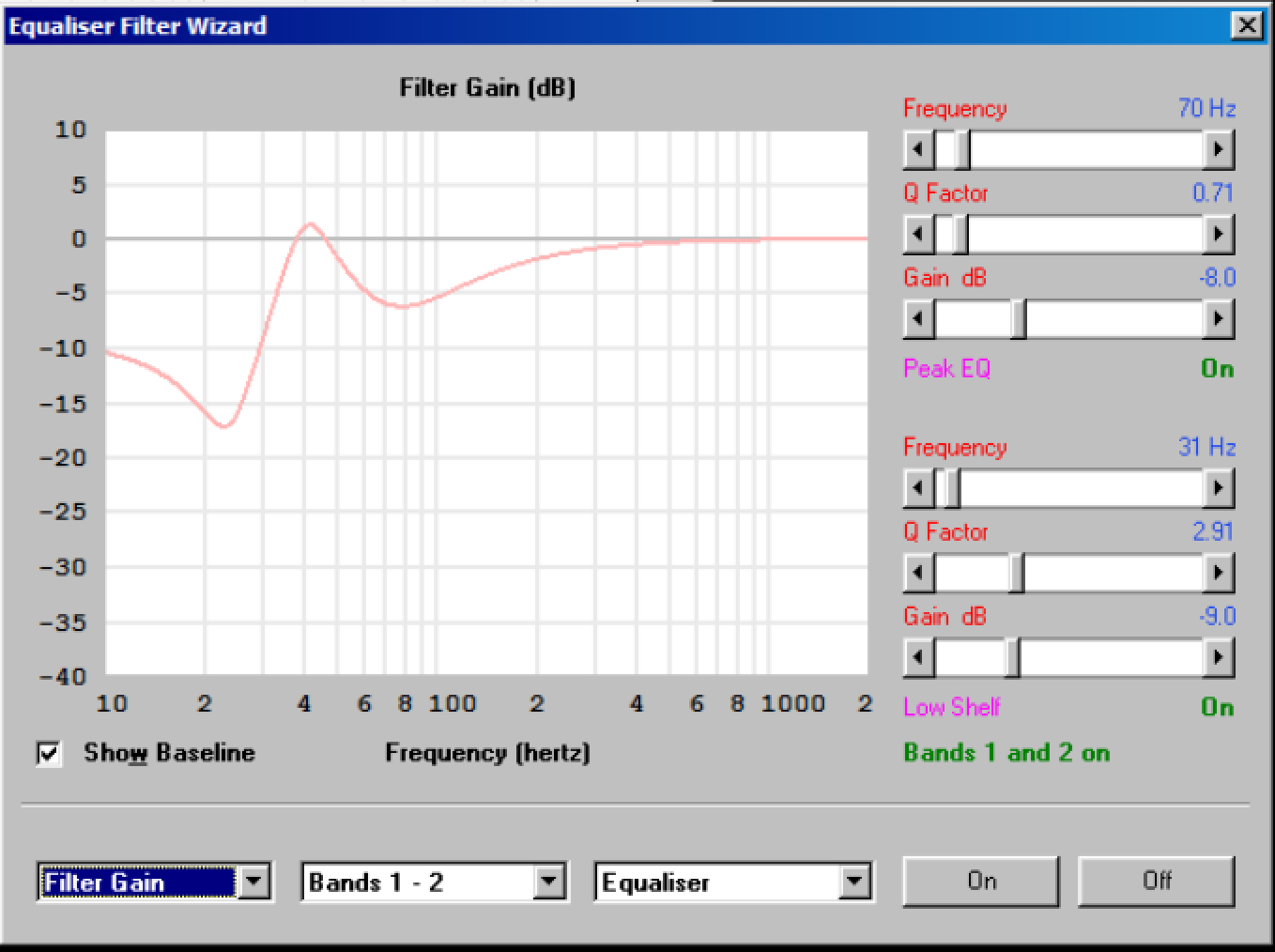

I used the same numbers in horn response and in sigma studio to optimize the low end for a super low budget speaker system I am working on for the 'silk purse' contest in the multi-way forum. Unfortunately I see very wildly different graphs of what is going on. I have attached screenshots of both.
Did I screw something obvious up? Which one seems more correct? Unsure how to model this as the whole point of this was to keep it at xmax and if the sim is wildly off then maybe I should just say screw it and go by REW measurements entirely, ignore xmax entirely, and just keep an eye on distortion?

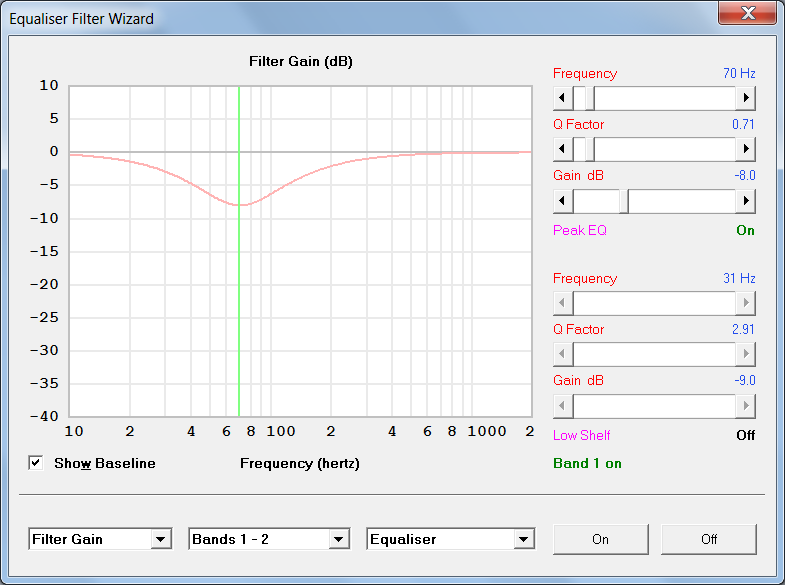

It is interesting that there should be such a difference. Have you tried comparing each of the equaliser gains separately? I suspect that the low shelf responses may not be the same. The sanity check Hornresp low shelf response shown in the third attachment seems about right, although I must confess that I am no expert when it comes to electronic filters 🙂

EDIT - Looking more closely at your Sigma Studio chart, I can see now that the low shelf gain is indeed different to that of Hornresp.
Thanks for responding David. What does this mean then? I did not put -20 into hornresp, I put -9 in ? Maybe I have an out dated version?

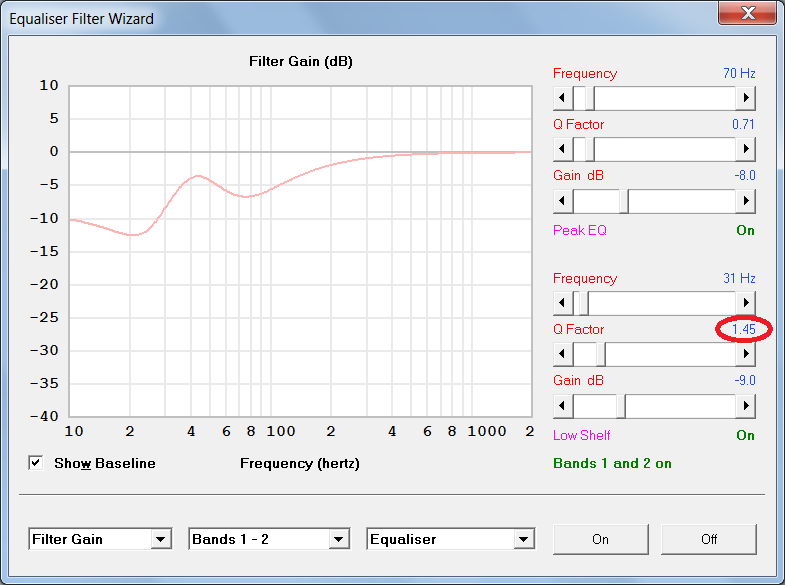

Hi Jared,
The -20 dB test example I included was simply to show more clearly that the Hornresp result for a low shelving filter was as one would expect. It seems that the Sigma Studio Q Factor values for shelf filters are calibrated differently to those in Hornresp, and to match the results you need to either halve the Hornresp value or double the Sigma Studio value. For example, if you change your Sigma Studio Q value from 2.91 to 5. 82, or your Hornresp value from 2.91 to 1.45, you will see that the results become the same.
I have no idea why the Sigma Studio shelf filter Q calibrations should be different to those used in Hornresp 🙂.

Hi Jared,
I did some more investigating. It turns out that the Sigma Studio "Q Factor" is actually S, a "shelf slope" parameter.
The relationship between Q and S is given by the expression:
S = 1/((((1/Q)^2-2)/((10^(G/40))+1/(10^(G/40))))+1)
Where:
S = shelf slope parameter
Q = Q factor
G = gain
A setting of 2.91 for "Q factor" in Sigma Studio is actually a setting of 2.91 for S. From the above equation, when the gain is -9 dB, the equivalent value of Q works out to be 1.403, which is the value that needs to be entered into Hornresp (rounded to 2 decimal places) for the results to match.
The Sigma Studio labeling is very confusing indeed. Rest assured, the Hornresp filter response results are correct 🙂.

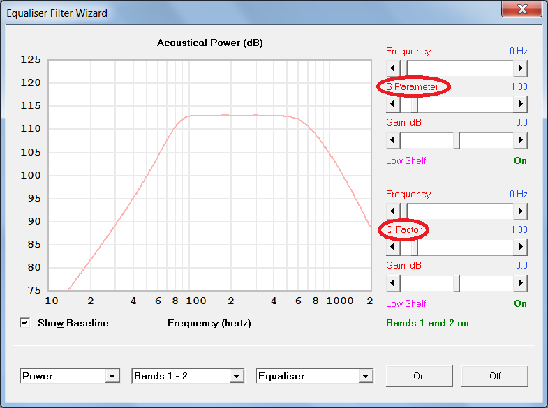

If all goes according to plan, the next release of Hornresp will enable the user to input either "Q Factor" or "S Parameter" shelving filter values.
