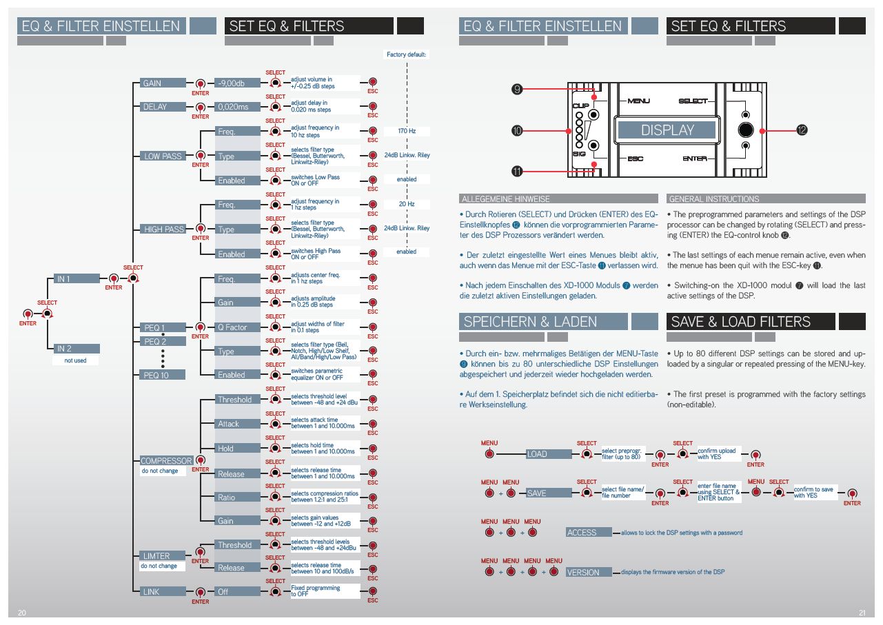

The Avantgarde Duo Mezzo has an attached 3-way programmable DSP with a 1000-watt Class-D bass power amp which uses a switching power supply to reduce size and heat. Simple setup for tube amps on top, big watts on two 12" woofers. Philosophy: Good in-room bass requires hi-tech Voodoo
LineSource, only the latest Avantgarde Duo Mezzo has this DSP, Class-D capabilities. And for that reason and cost I am looking to buy last generation Avantgarde Duo Mezzo which used 500 watt class AB amplifier with crossover and volume adjustment.
And I am not sure how to compare 107 dB sensitivity of Avantgarde Duo Mezzo with 96 dB sensitivity of JBL DD67000. Below 170 Hz, Avantgarde has it's own 500 watts Class AB amplifier, thus, it is a semi-active loudspeaker whereas JBL is fully passive.
I am also confused what role the voicing of external and internal amplifier plays in Avantgarde final sound. Can one hear two different amplifier at this crossover point?
