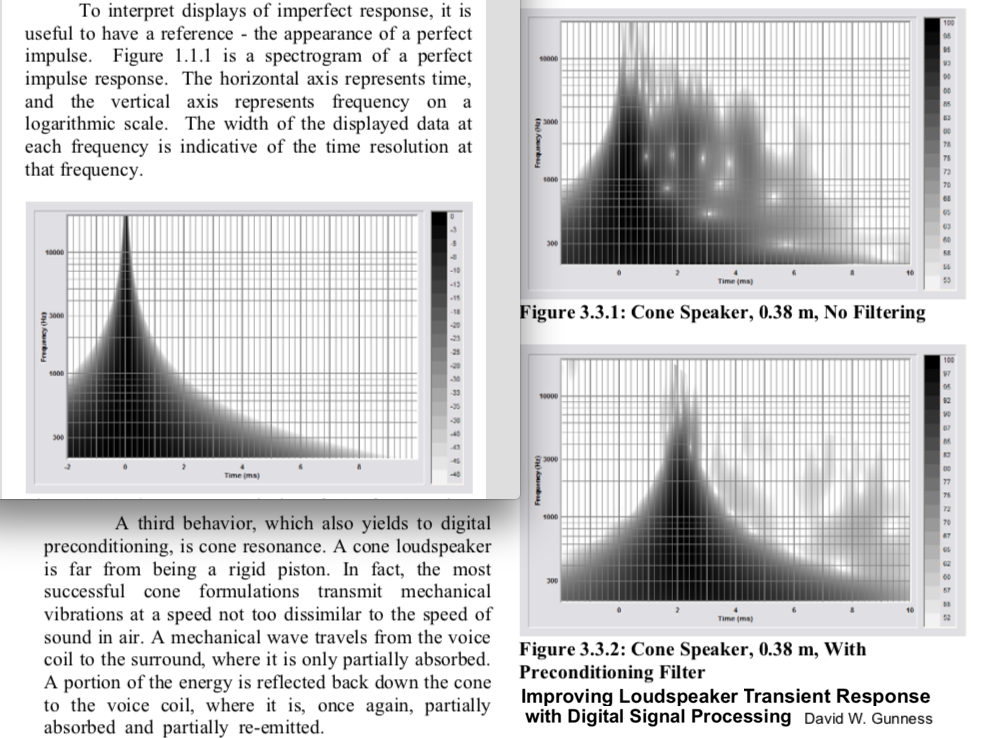

This paper goes into some of the aspects affecting transient response:
https://www.bksv.com/media/doc/17-198.pdf
This paper goes into how transient problems can be addressed electronically:And what could I do to encourage Revox four tiny cones to show more silent nuances of the sound - no idea as this is not about sensitivity of a speaker.
https://www.fulcrum-acoustic.com/wp...dspeaker-transient-response-with-dsp-2005.pdf

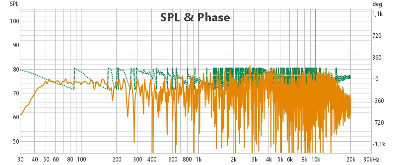

A pair of Revox BX-350 raw in a listening room, listening position:
...same pair after parametric EQ:
Speakers with similar FR plots in REW in the same room and positions can bring a very different listening experience. That's why I'm looking for that one missing parameter - if one exists - determining decay/reverb phase reproduction by the speaker. From my experience and experimenting it is not matter of frequency response characteristic. Of course, dark sounding speakers can kill HF reverb but that's extreme. With Revox and Wega examples I consider two pairs of speakers, each pair with its own EW as far to the neutral as possible without filter ringing or messing with phase. The EQ is an APO.

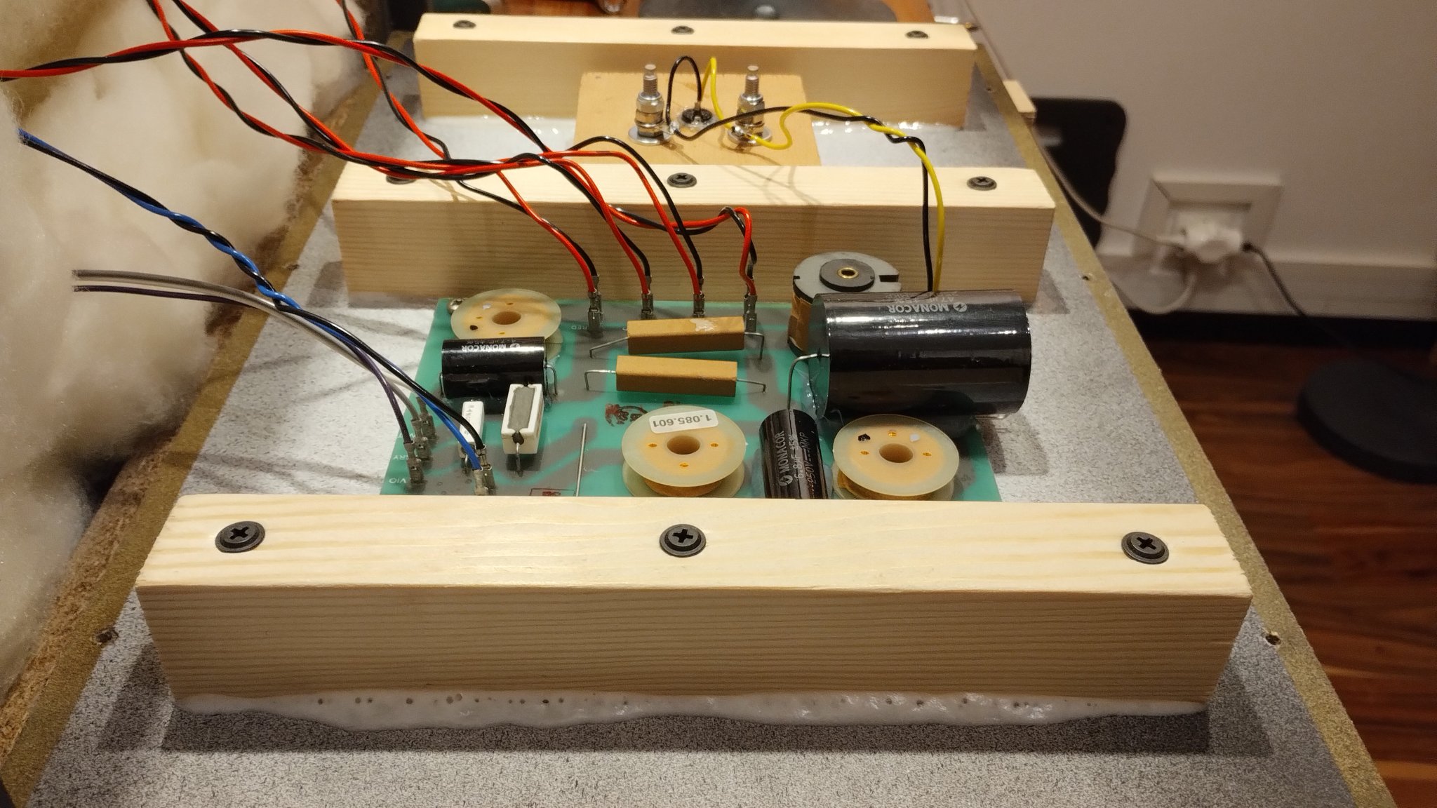

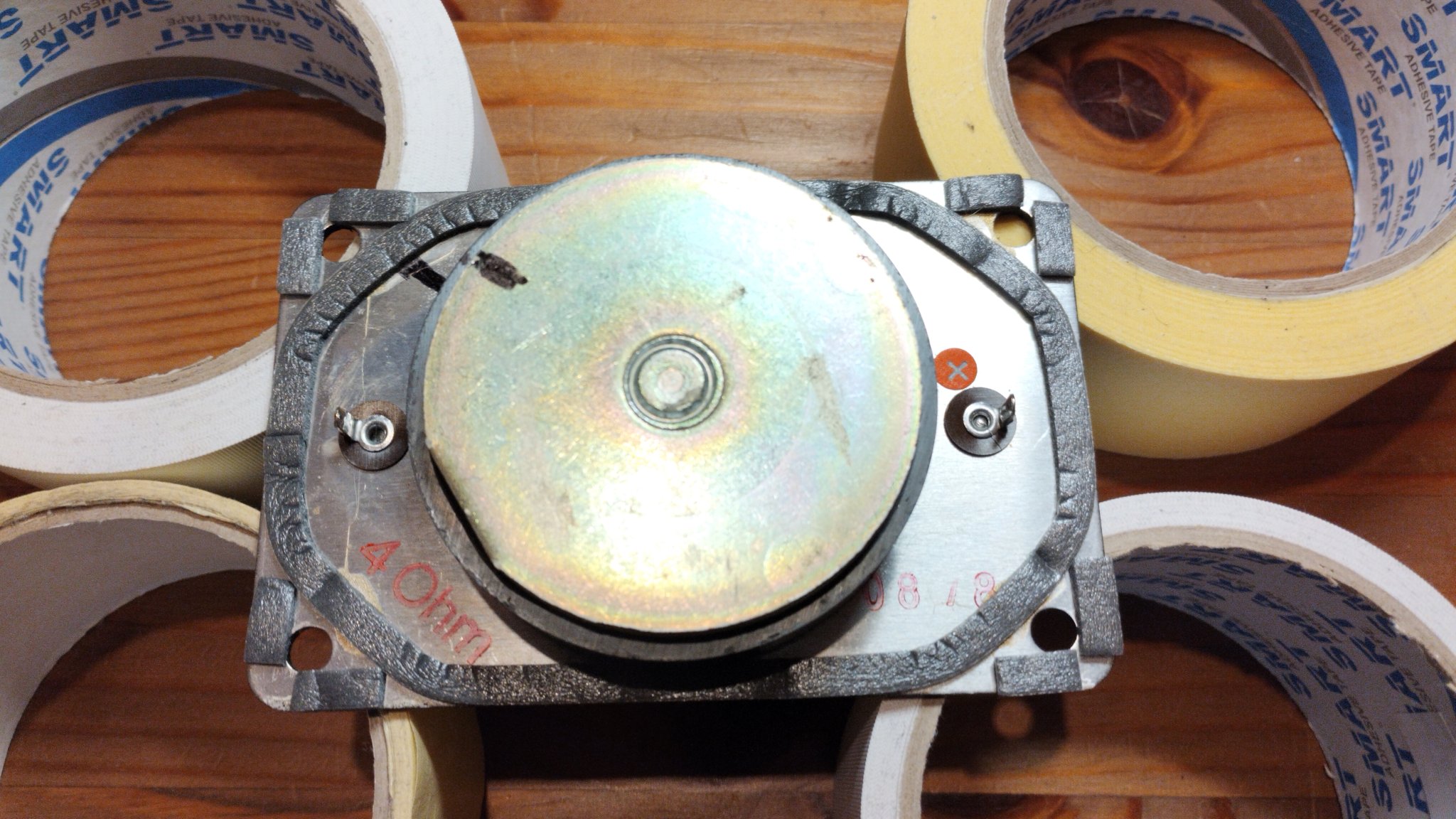

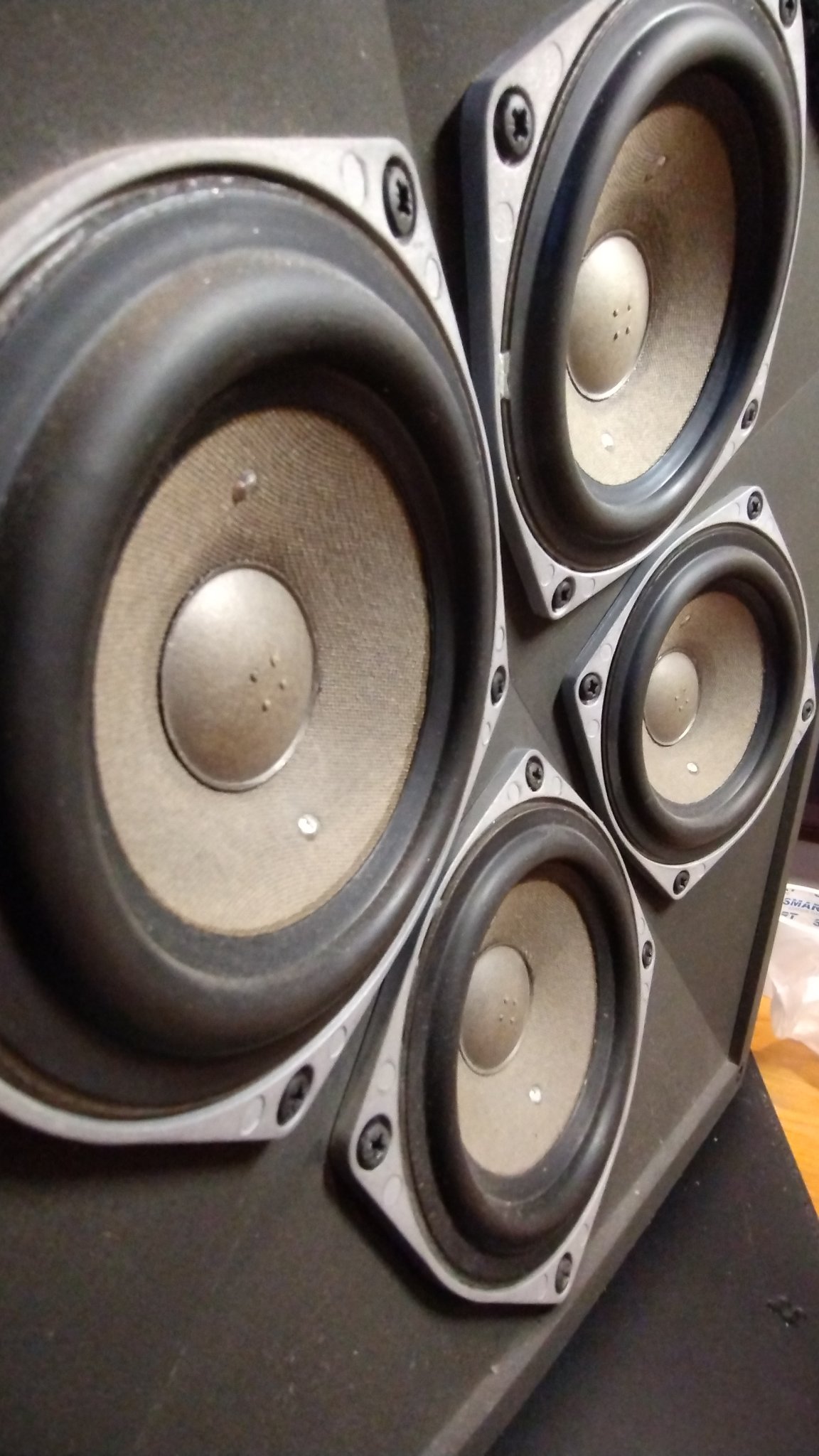

And now some photos, people like photos 😉
The protagonist and suspected: Revox BX-350:
...its tiny 16 Ohm and 400 Hz Fs drivers in detail:
...tweeter - fixing unglued wire with a superglue (cyano acrylate) and this is a bit different story, once I will run another thread with video showing exciting the tweeter to a resonance with a brush:
...sealing the tweeter back to the cabinet:
...x-over recapped with all-MKP from Monacor, back plate reinforcements and new banana-terminals:

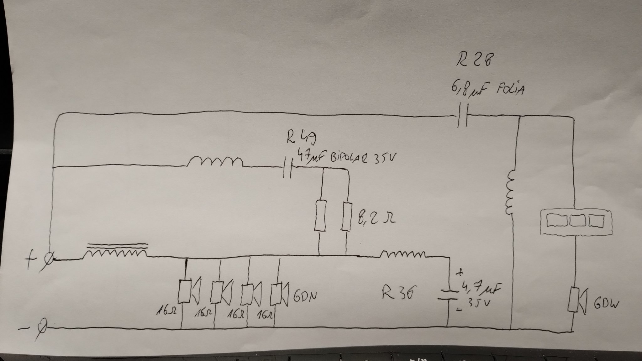

...and the crossover schematic. It is evident that the designer tried to fix something and incorporated an LC resonant trap with 4,7 uF polarized elcap plus a bandpass boosting LC circuit with 47 uF cap but as I do not have inductor values it is hard to tell where exactly it is supposed to act:
...I did some experimenting with moving mic and the 500 Hz dip disappears about half meter from the baffle front of the Revox speakers. This is not lobing and from my point of view has something to do with a speaker-room system. German test from the 70's shows the same 500 Hz problem. As I have no access to the anechoic conditions, that's what I can provide to further discussion.

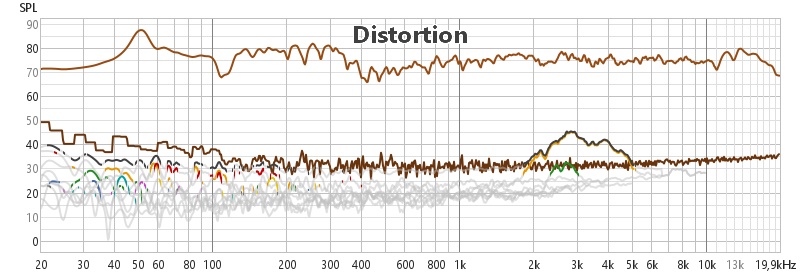

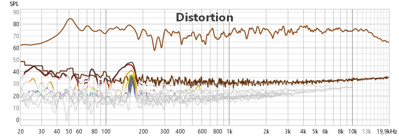

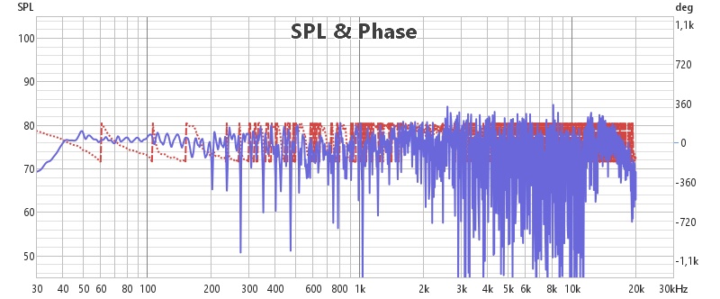

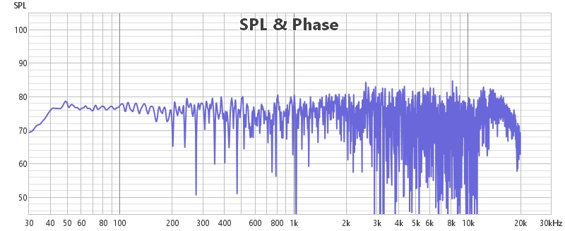

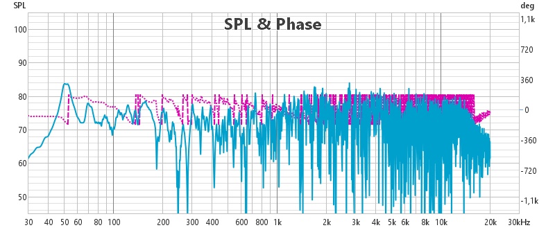

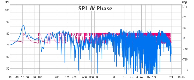

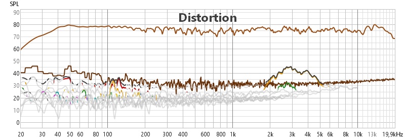

1R) Revox BX-350 SPL and Phase, no EQ:
2R) Revox BX-350 SPL and Phase, EQ:
3R) Revox BX-350 Distortion, EQ off:
4R) Revox Distorion EQ on:
And now for Wega:
1W) Wega Direct 200, SPL and Phase, EQ off:
2W) Wega Direct 200, SPL and Phase, EQ on:
3W) Wega, Distortion, EQ off:
4W) Wega, Distortion, EQ on:
