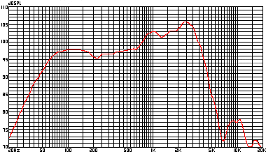

Adding a tweeter to a bass cabinet is not that complicated
if you take the right sort of approach which isn't the above.
Here is the response of a typical 15" driver used for bass guitar:
http://www.usspeaker.com/Delta-15A-1.htm
(They do vary, I just picked the Delta 15 as a random 400W 15" for bass guitar.)
No x/o on the bass units, x/o and level control on the tweeter.
12dB or 18dB slope x/o on the tweeter and roll it off into
the fall off region of the bass driver, here around 3.5KHz.

the 15" drivers are not as "hot" in the upper ranges
as my random example, which TBH is pretty "hot",
i.e. being random I cannot say it is average.
However I can say around 3.5KHz x/o is near average.

5. 1k is really just a ballpark, but after seeing the frequency response posted above, you're going to need some serious EQ (if that example is indeed representative of your woofers) - the response is a mess.
