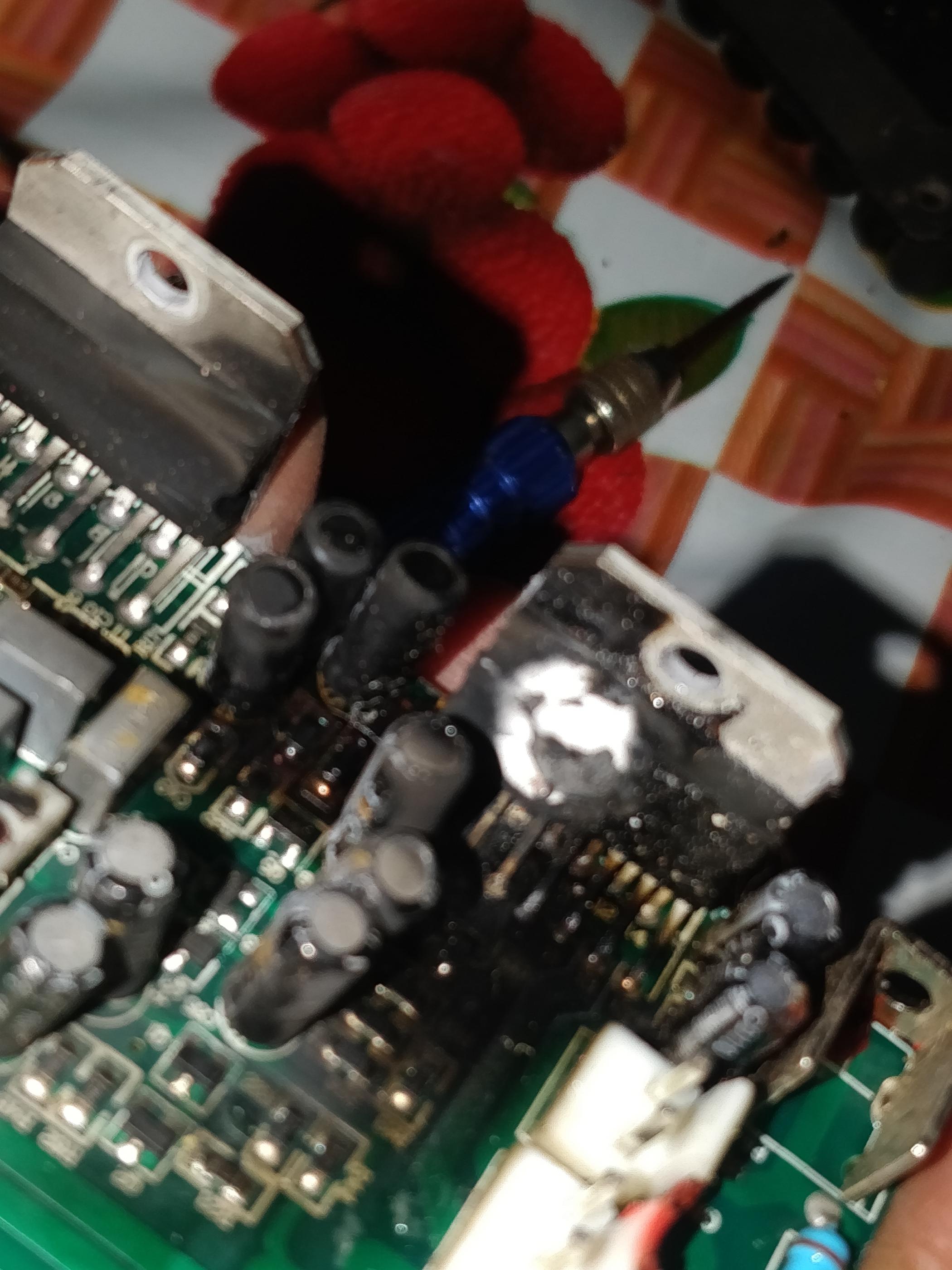

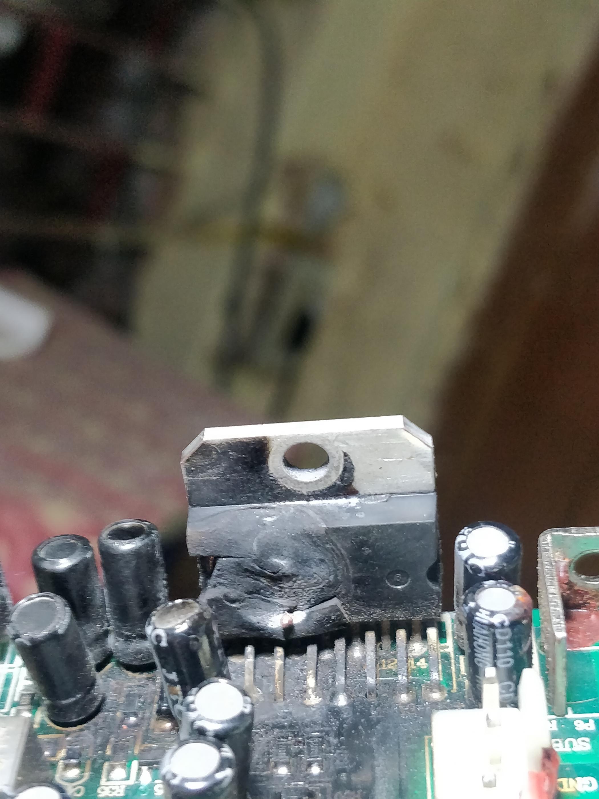

i am a hobbyist and does not have deep knowledge, so any help would be gratefull.
my swans m59w blew up because of delivery of excessive voltage and on inspection i can see that there is fault in amplifier chip. the amplifier ic tda7294 blew up and i dont know what to do now. i dont have a circuit diagram so i dont know about all the components that need to be replaced and i cant find a replacement of full board either. what do u guys suggest

Looks to be catastrophic.
It is possible to replace all the affected parts but the PCB looks to be damaged. When the PCB gets carbonised, it becomes conductive which is not good.
I'm not familiar with the product this board came out of but there are TDA7294 boards on places like Amazon / Ali but beware the chips aren't always legit.
That is not hard to see
