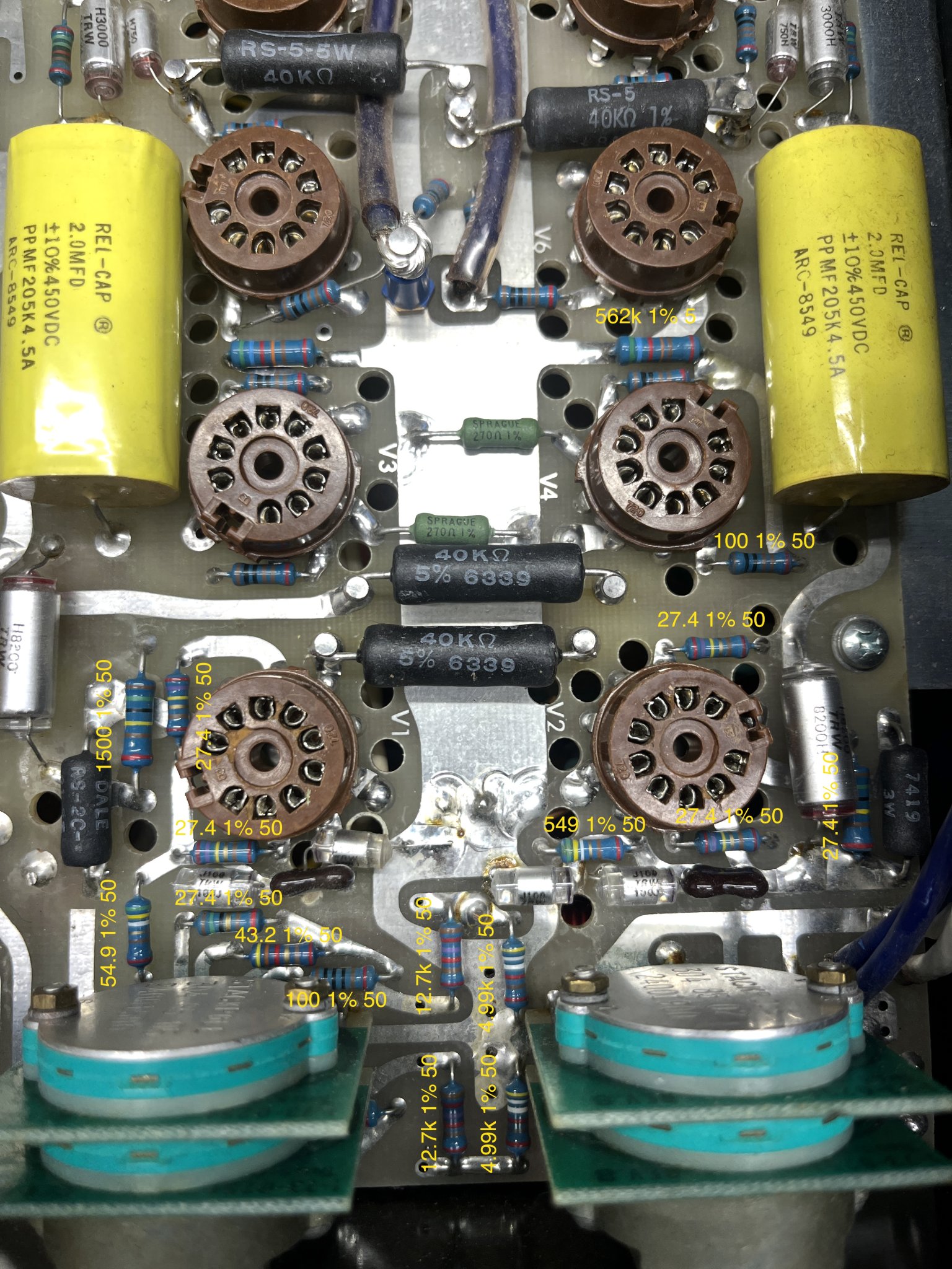

Oh sure, sorry, I thought I had already. See attached. This is the phono stage of an ARC SP10 preamp. I was highlighting all the resistors that fed the grid, anode, or cathode of one of the tubes, to help me identify what I might need to order. I'm getting bad noise out of the right channel (primarily). Freeze spray produced results in several places.
I also included a photograph of the V1/V2 area of the circuit board. My resistor labels may be wrong in some places... There's no parts on the bottom of the board, just traces.
I'm not sure, this unit doesn't have a parts list. Is there a way to tell visually?What type of resistors are they, metal film, carbon film, or carbon comp?
The resistors look like a mix of 1% metal film and wirewound power resistors. Sometimes a resistor can fail when the end caps loosen up. This failure mode can happen with both film and wirewound types. Try tapping each resistor with the eraser end of a pencil to smoke out possible offenders. In my brief (very) stint as a repair technician, I encountered one amplifier that had a carbon film part with loose end caps, which caused it to be intermittent. Swapping that particular resistor out fixed the amp, and yes, I found it by tapping it....
That checks out with with else I know. What should I look for when doing the tap trick? If tap and makes noise, bad?The resistors look like a mix of 1% metal film and wirewound power resistors.
Decades ago a noisy AC-30 was on my bench. It contained loads of the then infamous carbon powder resistors made by vitrohm. These produce spot noise proportional to the DC.voltage drop across them. Resistors with max voltage drop are the 100k~220k anode resistors of all these ECC83 triodes. I replaced just these with good metal film, and the job was done. The difference was clearly audible by my wife working in the kitchen!
