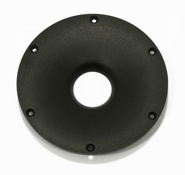

I do have access to a 3D printer so I could 3D print a waveguide. I do not see one listed specifically for the DS2604/833000. Are the T/S parameters similar enough that I can use a design intended for one of the other speakscan tweeters? Or is that a bad idea?
You can try the waveguide for the Scanspeak 6600 dome. Should perform similarly, but I would do a test print and measure in-box before you spend a lot of money.
A waveguide is the way to go. With the miniDSP you can easily put in the shelf filter to flatten the 6 dB low frequency boost. Before you spend time printing a waveguide you should look at the Viston offerings as they are very reasonably priced. I use them with the high end KE 25 SC Visaton tweeter, but they will work with other 1" drivers. https://www.parts-express.com/search?keywords=visaton waveguid&order=relevance:desc

I like the ease of simply adding the Visatron WG 148R to my order. But how do I actually know if it is going to work with a particular tweeter. It seems like a lot of times even if the sound quality is going to be great -- I would still need to 3D print an adapter plate because the screw holes on the tweeter and the screw holes on the WG do not line up? Or I drill new holes in the tweeter flange?Before you spend time printing a waveguide you should look at the Viston offerings as they are very reasonably priced. I use them with the high end KE 25 SC Visaton tweeter, but they will work with other 1" drivers. https://www.parts-express.com/search?keywords=visaton waveguid&order=relevance:desc
Obviously I would like to just order a good sounding tweeter from parts express that works out of the box with the WG 148R and has a suitably low Fs. But it is less obvious how to comb through the 9 pages of search results for 1" dome tweeter to find a suitable match.

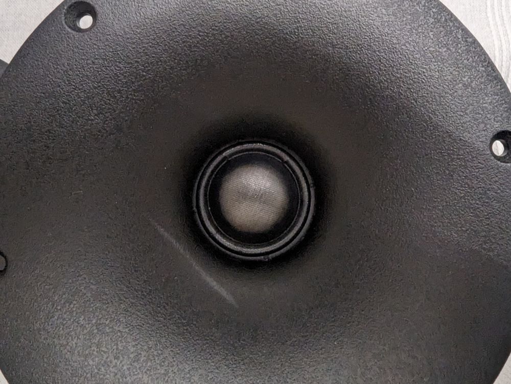

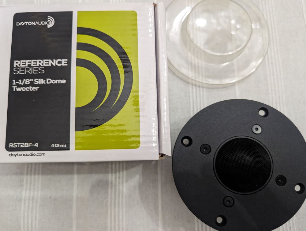

The Dayton Audio RST28F-4 (Fabric dome) works better than the RST28A in a waveguide. It works in the Visaton WG148 without any kind of adapter. In the waveguide it can crossover low enough to match an 8 inch woofer. (Probably around 1.4Khz but not sure if you would even need to go that low, but somewhere between 1.5Khz and 2Khz is likely, NOT 2.5Khz as you originally suggested. The main problem of an 8" two-way (and very difficult with a 10") has been hinted at above...beaming / directivity.)

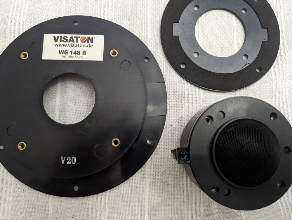

That sounds convenient. It looks like I do need to carefully remove the faceplate from the RST28F and attach the WG148 in its place?

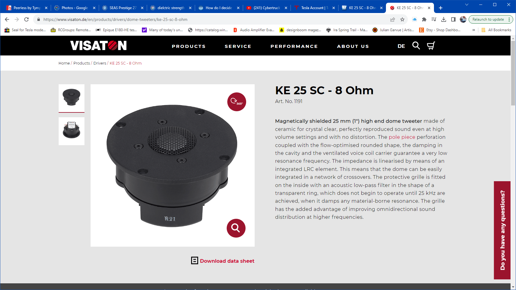

The tweeter that mates perfectly with the WG148 waveguide is the KE 25 SC tweeter. I have used this tweeter in many speakers and it has a very flat response and can achieve distortion figures of 0.1% at moderate listening levels. Mouser is selling it in the USA. Call to order and insist they wrap the tweeter box completely in bubble wrap or foam before dropping it in a box to ship it. If it ships bouncing around in an empty box, send it back as it will be junk at that point as the face plate will shift when dropped on it's side by UPS.
Here is a link to Mouser: https://www.mouser.com/ProductDetail/Visaton/KE-25-SC-8-Ohm?qs=VWNNG7jHlrIxfM3uThNIqQ==
There is a link to the datasheet on the Visaton site: https://www.visaton.de/en/products/drivers/dome-tweeters/ke-25-sc-8-ohm

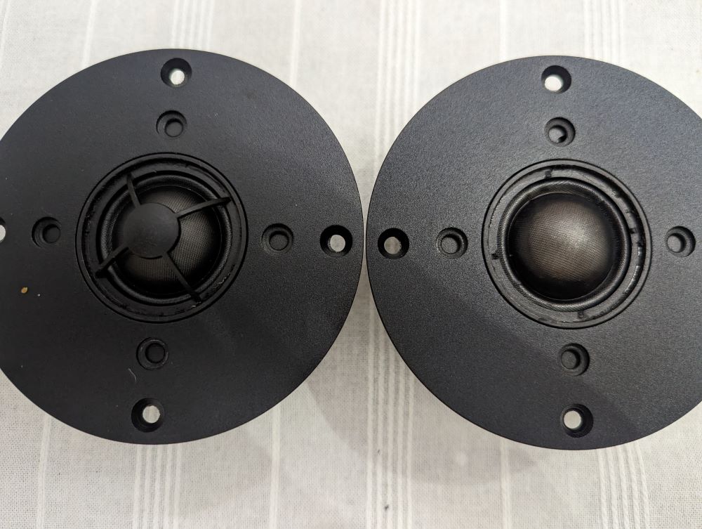

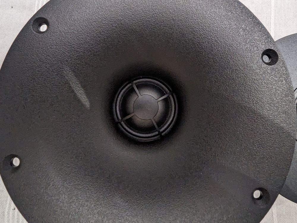

Hmmm...I thought so. I plan on a build with the RST28F-4 in the Visaton WG with the SIG180 woofer. I have read that the RST28F fits the waveguide and have seen and heard speaker with this tweeter and waveguide combination. The tweeter comes with a protective metal grill and a plastic phase shield under that. One post I read, the designer thought the grill was glued on but he said he just popped it off. Well...mine WAS glued on and I was able to get it off with a razorblade knife and pry it off with my Allen wrench that I had used to remove the screws in the faceplate. NOTE, this is necessary as the waveguide does NOT fit over the protective grill. I also cut the plastic phase shield off with my knife. On the second one I didn't and the waveguide WILL fit over the plastic phase shield. I have not used this combination yet, but I have used this waveguide and build an adapter using the baffle cutout to clamp the tweeter to the waveguide.
Faceplate removed...
Protective grill dome removed. Plastic phase shield (permanently) removed from one. Faceplates put back on...

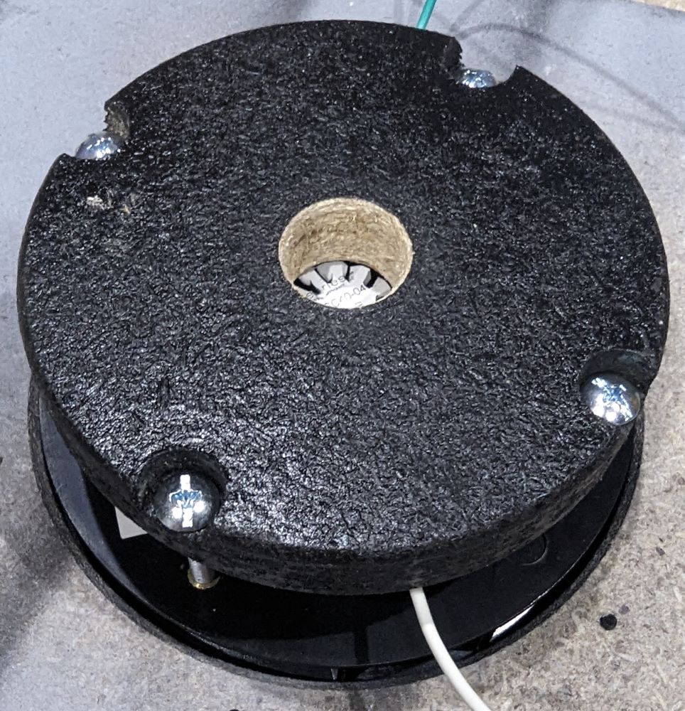

DIY adapter to clamp tweeter to waveguide. The tweeter used below did not have a faceplate so I could just clamp them together. For the RST28 the faceplate covers the holes on the back of the waveguide so you'll have to drill holes in the faceplate or add some sort of adapter.
