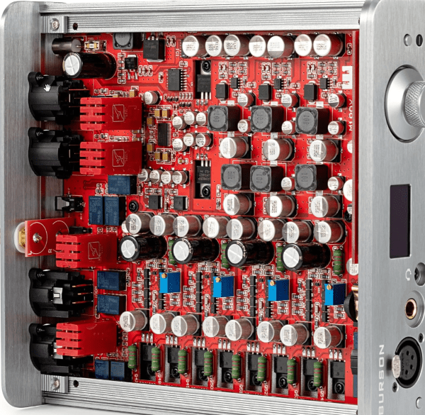

but in relation to the pic I included, would you say the preamp output is fully balanced?Just because you have balanced inputs and output connectors doesn't mean the circuitry in between is balanced.

Your’s is not as simple a question as it might seem. First, when you say balanced, do you refer to fully differential internal signal circuitry, or do you refer to signal interconnection that rejects ground (common-mode) noise, such as those utilizing XLR connectors?
Can you explain to me these electrical tests? would a simple volt-meter work?Simply apply the definition of "fully balanced". Perform electrical tests which seek to confirm or refute the hypothesis "this equipment conforms to the engineering definition of Fully Balanced".
the manufacturer advertizes that the device has a fully balanced output.Your’s is not as simple a question as it might seem. First, when you say balanced, do you refer to fully differential internal signal circuitry, or do you refer to a signal interconnection that rejects ground (common-mode) noise, such as those utilizing XLR connectors?
I guessing this means R+/R- and L+/L-. to my noob knowledge/experience, seeing 4 circuits of each of the R/L signal would mean a balanced circuit/output?
I doubt you'd be able to tell without a schematic (and the ability to interpret the schematic). Also note that there are many definitions of "fully balanced" and most of them are rooted in marketing.

So, just looking at a pic doesn't really tell me much about the actual circuit, makes for fun guessing, but I need to see a schematic to see the circuit topology.
Basically, yes. It would be near impossible to tell whether a circuit is truly balanced/differential or if it's pseudo-balanced, for example. And by pseudo-balanced I mean that the circuit consists of two halves, operating in opposite phase, whose outputs are summed at the end.

Okay, then you mean for the purpose of ground-noise rejection.the manufacturer advertizes that the device has a fully balanced output.
When an interconnection is referred to as balanced, what that indicates is that each of the signal phases has the same impedance to signal-ground. So, for example, both the R+ and R- output conductors might feature, say, a 110 ohm impedance to signal-ground. Although, it does not have to be that particular value, just so long as they are the same value.
While an unbalanced interconnection's output might feature a 110 ohm impedance to signal-ground from it's center-conductor (R+ or L+), but 0 ohms impedance to signal-ground from it's outer conductor (R- or L-). The description of an interconnection being balanced, or unbalanced, has to do with whether the two signal conductors have the same impedance to signal-ground or not.
The balanced output impedance value is usually specified in an owners manual, which then means that it is, in fact, balanced. Else, I suggest that you simply contact Burson to have them confirm. Is there some reason why you doubt Burson's claim that the output is balanced?
External noise cancellation at the input, a greater possibly gain through the gain section, depending on design of course, and noise cancellation in the circuit in the form of distortions, that is, harmonic distortions can be cancelled at the output by circuit design.
