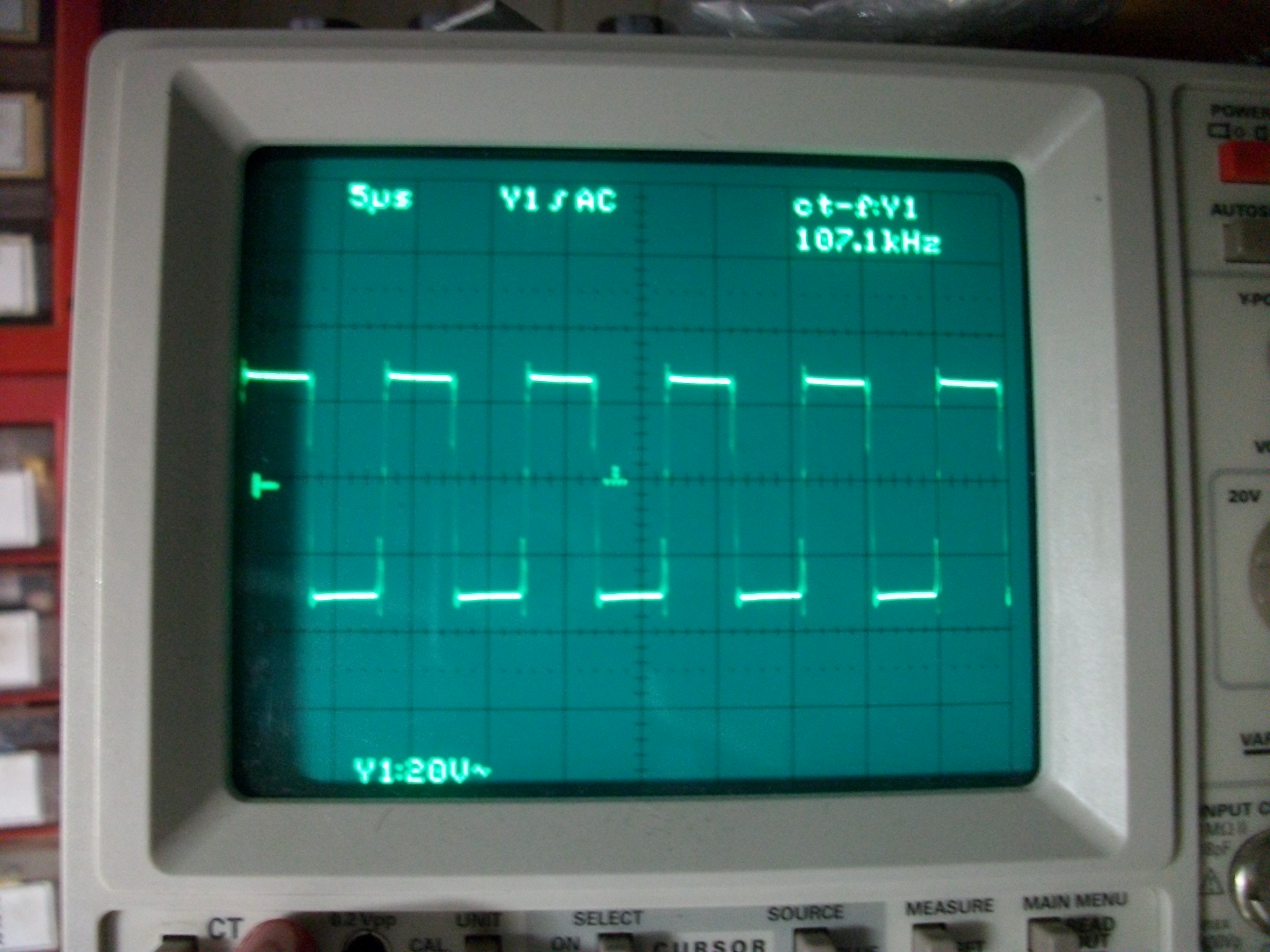

if you have access to an oscilloscope check the gate signals of the mosfets. When using both channels of the scope you can compare the two parts of a bank of mosfets driving the transformer (the primary site of the transformer consists of two coils, each coil is powered by a set (or bank) of mosfets. The signal should be clean square wave (a little "knotch" is ok).
When you compare both mosfet gate signals from each part of the bank you need to see that while one bank is in "ON" - state the other part of the bank needs to be in "OFF" state, if there is no dead time in between the mosfets are all open at the same time and thus causing a high current flow through the transformer.
If the drive signal looks real ugly there´s a good chance that the driving transistors are not working properly anymore.

sorry for being a bit off topic here, but the pic you posted, is it from a gate resistor ?

yes and no . It´s a gate resistor signal but from an older type amplifier (Magnat) which uses a NE555 signal generator, and of course it shows just one gate signal, not both banks at the same time. Sorry for not having an exact pic of a TL494 / 3525 sort SMPS driving signal 😉 (but that could be googled as well). Just wanted to show that at the gates there must be a clean signal. The following shows both signals.
there you can see that one signal is "inverted" and there is a dead time between the "ON" states
