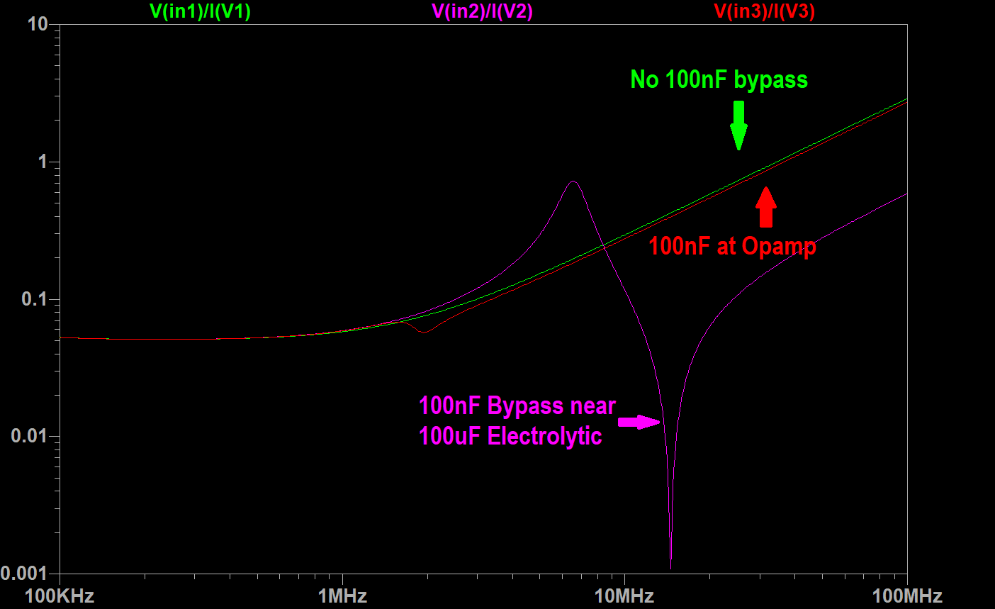

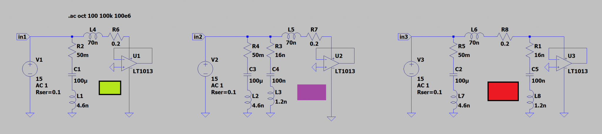

Here are some examples -- fewer than Elvee's demonstration linked above, but illustrating placing the bypass right at the opamp. compared to the electrolytic is bypassed immediately next to the bulk capacitor. The little bit of inductance and resistance tames the impedance:

It depends very much on the actual configuration: if you just place the 100n directly at the terminals of the big cap (it doesn't matter whether it is 100µ, 1000µ or else), you will get nasty resonances and gain nothing in terms of lowering the global impedance.is this different from using 100u+100n for supply rails decoupling?
Additional bypassing at the point of load is a completely different story, as Jack demonstrated: when the power transmission line has a significant length with associated resistance and inductance, it makes sense to improve the local bypassing. Not only does it make sense, but it is essential in many cases. That's the case with a board with a number of fast opamps, or old-style, two layer logic boards having a criss-cross design: each IC was individually bypassed. Such a distributed decoupling worked well, because of the parasitics and because all the caps had a similar value, in general 100n.
Doubling up a large Ecap with a small ceramic, or worse film cap is counter-productive.
That said, this kind of bad practice rarely has directly noticeable adverse consequences: the overall supply impedance generally remains low enough to avoid serious problems (when a resonance happens to fall at some critical frequency, like a clock multiple or sub-multiple, it can be catastrophic, but it is rare), but it can cause issues of some kind, like unexplained reduced performance, and the first cure designers try is to increase bypassing, by adding some more parallel caps, which at best does nothing, or aggravates the problem
A point worth noting: if you think that adding a small cap in the middle of a longish line will improve matters, think twice: the cap will be alone in-between two inductive path, and will resonate like mad.
It will behave like an undamped LP filter of high Q, which will be beneficial for the ultimate HF rejection, but will wreak havoc at lower frequencies due to the multiple and violent resonances at lower frequencies, where it really matters
