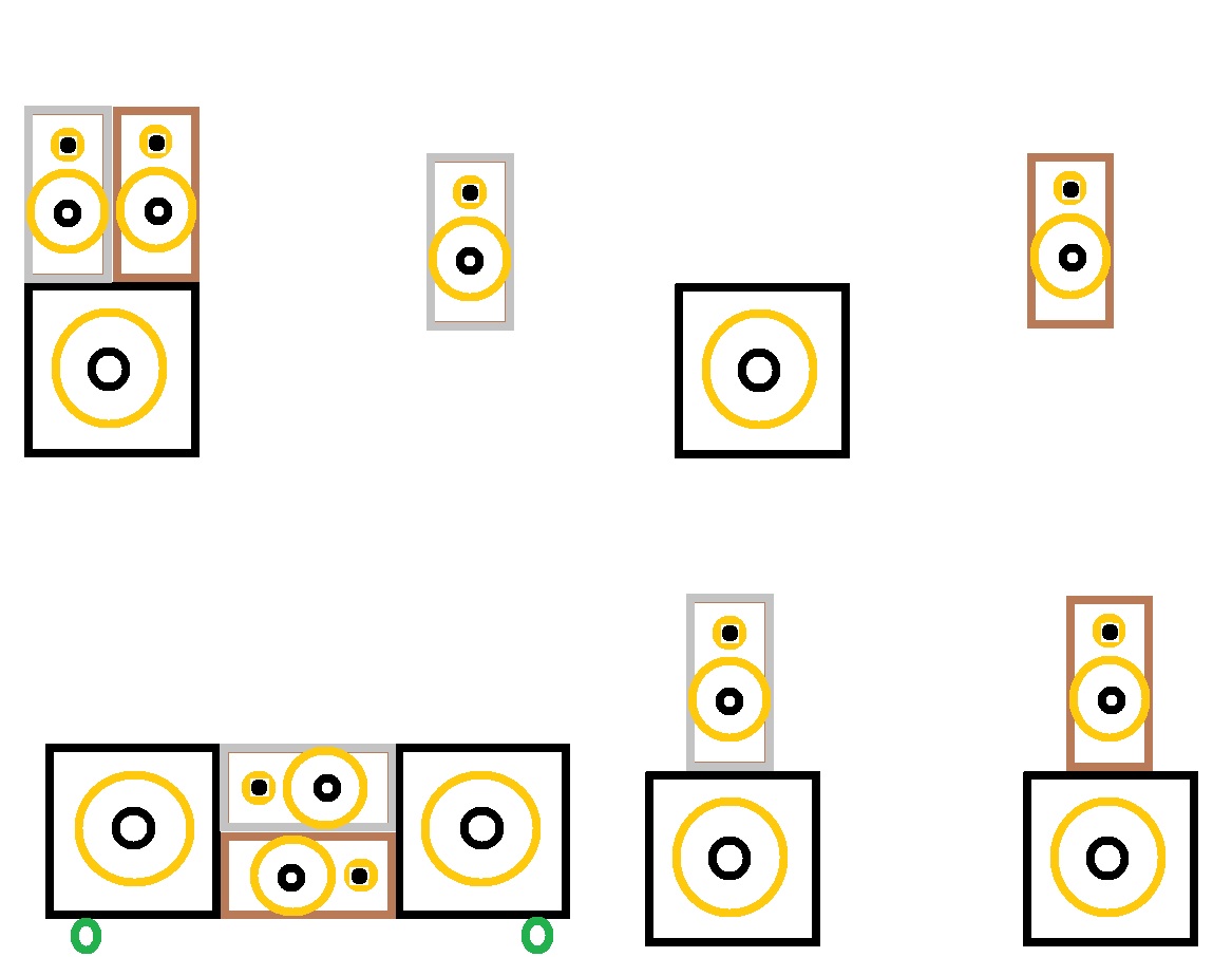

I'm going to use the sub woofer as a starting point for a portable boombox build.Unless I am told that is a terrible idea in which case I will change plans.
I want to use it in a barn where I work and work out, and I like bass. My plan at this point is to decide on the sub woofer, then build the rest of the system around it. I've strongly considered the boominator, and I still might go that rout. But the boominator is focused on solar charging which mine won't have at all. And the boominator is focused on lots of people outdoors. Mine won't be outdoors, won't be for more than a few people, I'm more interested in great sound and rumbling bass. It will spend most of the time in a barn with 12ft ceilings, wood floors, wood ceiling, wood walls, it seems to just suck the power out of everything I put in there.
I've tested a behringer 15inch sub and that seems adequate. It's also big and heavy.
I'm thinking of maybe about a 12 and a squarish cabinet as that will be a good shape to build other stuff onto. I'm sure I can easily get a 12inch kit.
I plan to be able to unlatch the other speakers and spread them out a bit on wires to improve the wideness of the sound.

How Portable exactly? do you plan to run on batterys or the mains? what is the dimentions for what you have in mind? a high powered sealed sub wouldnt have to be to huge and could be a cube, with the amp plate possably built in, then the 2 satalight speakers could be half a cube wide each and a cube deep, so you could include clips or such to make one wheelable or 2 person carryable rectangle, like 2 cubes. that clip together with handles on the bottom or top or wheels on the rear
If using batterys a more efficent sub using a smaller driver in larger box could be better. like a ten or an eight, this would be easyer to drive and therefore require less amp power and less battery.
a 10inch, with 6inch midbass/mids, and dome tweeters, would fit size wise. so the 10 in a cube box a about 13inches square with each 6 in a half cube sized box, would allow the idea of a extra sub cube to fix on the top, so you could lay it sideways if you wished too as one complete speaker. would also give the 6inch minbasses some bass and good box sizes. if power is nooo concern, may as well use a 12
the green circles are wheels
your idea is perfectly possable in my opinion/knolage of things,
its just with battery, as your opting for bass, you need a bigger one, and its not soooo portabe, so maybe removable battery packs. the tops dont need aaaaaaaal that volume where as the sub does. so half the space of each one could be for batterys and you could fit the amps in the sub/subs. Im liking this design. mains power would be easyer.
passive xover for the midbass to tweets, bassicaly 2 full range speakers with abit of rollof also to prevent them moving to much at lower frequancys, and a actice sub amp for each sub. or one for a active sub. or to make it a lot easyer....... a 3 way xover for each wholey seen speaker. but u lose some efficency... so a active xover is better, but that would basically be 2 3 way speakers. no matter. or if you use one sub... a sub amp with satalite outputs... quite avalable. guess its alot easyer if you can use the mains.
one Better idea i just thought of. that would mean only a crossover for the high boxes is to make them both1/4 of a cube. so together they are 1/2 a cube. then use the remaining 1/2 a cube as a whole, for batterys and amps. and a few compueter fans......
would make wiring easyer. then its just to use one or 2 subs.
so that picture I added. would have one final box. the two mains. the one or 2 subs. and a box for the bits.
if shown from above. would see the the two satalites as one 1/2 of the square. and the amp battery box as 1/2. doesnt haaaave to be exactly that if the battery box can be smaller or nees to be abit bigger. one advantage of making the mid bass boxes not to big is it will ensure the midwoofers dont move to much so the sub really can... unless your using 2 volume thingys for sub and satalites. like on plate amps etc

Sounds Good,
I did have a further insight,
If you made the 12" sub cube or cubes, say 14*14*14
You could make each of the two midhigh boxes 14*7*7
If you then Inset the woofers and tweeters into the front, you could lye them face down ontop of the sub box for transportation,
then the transportable shape wood be 14*14*21
That is with the one sub.
prehaps even doin the same for the sub, so that faces up, with the two midhigh boxes face down. so from the outside its a solid box when moving, and that is easyer to keep the drivers protected. unless you use metal grills...
If opting for Two subs, It may be better to use 2 decent woofers, and raise the cross over and set them up like in my diagram, as the woofers will do the upto 500hz range more efficently, but this is only if you put the woofer boxes with the mid top boxes ontop or very near, and 3 way speaker design may be abit more.. finicity .. than a 2 way with a sub/subs
I should be dooable to find a good two way desig you cn use or adapt for the midhigh boxes, and then add the sub and cross 80-150 region,
.though one option could be to adapt a decent 3way speaker design,
say for example you made a depression into the bottom of each mid high box, below the woofer so that each tweeter can fit into each depression, so the two boxes can opposly face, for transporting so the drivers are protected
