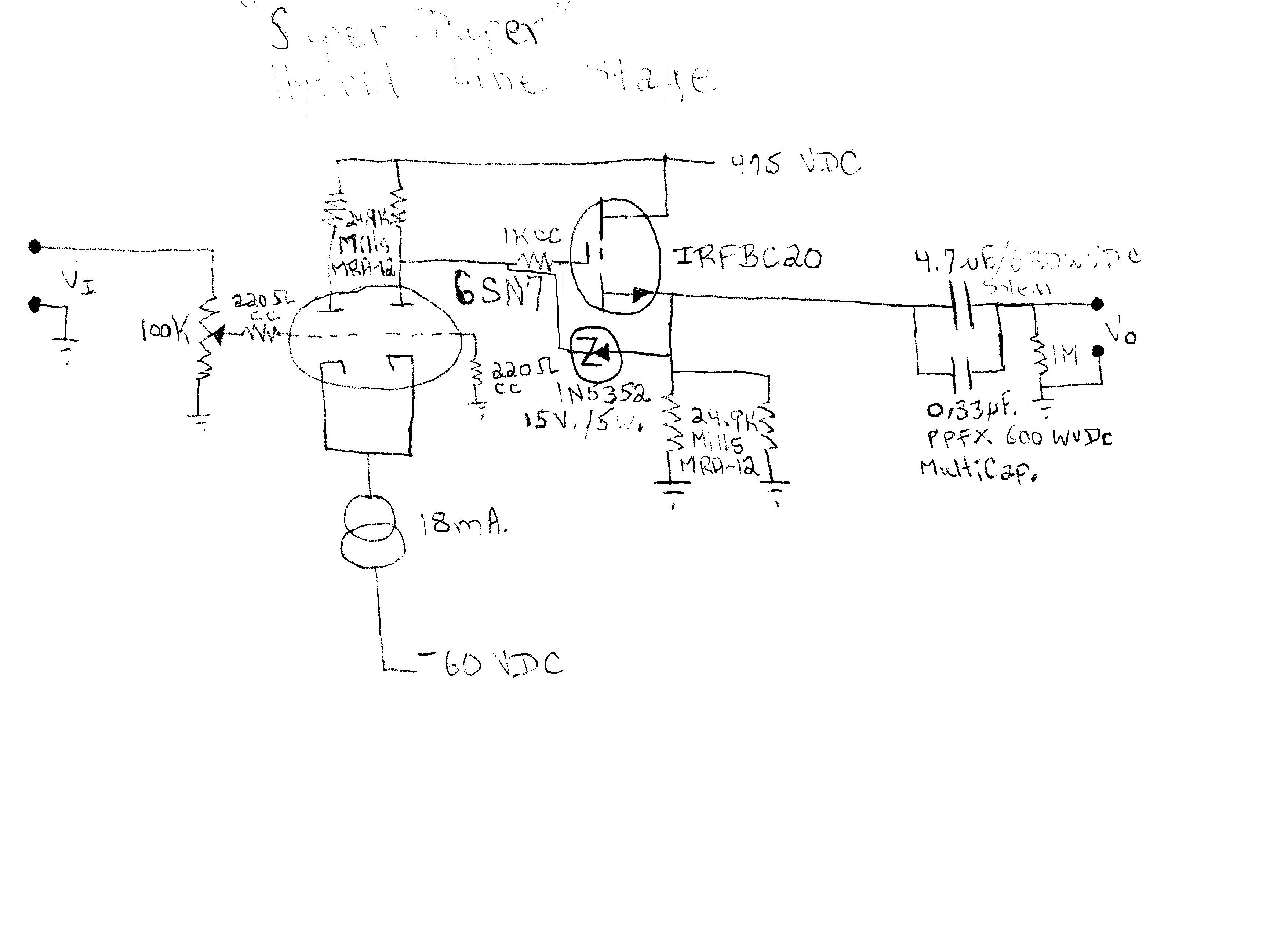

Hello guys,
I recently built a preamp and has some noise issue. It is not like hum, buzz, or hiss but sounds very much like white noise. Then I listened to some suggestions, reworked some parts and changed some chokes, filament supply, etc. None of them really worked for me, but reducing gain definitely helped. I tried adding a 1K resistor with a 100uF cap paralleled to the plate resistor for 6SN7 (39K at R7/R8). The white noise is completely gone. However, by doing so, the sound becomes quite weird. Sounds very analytic and the black magic of its midrange is totally gone. So I have been seeking for a way to reduce the gain and keep the original signature of the sound and might improve it if possible.
Here is a way that my friend suggested me to do, please see the attachment. We want to have about 8-10mA plate current and about 15dB gain so I would have sufficient gain and have 6SN7 to work at its sweet spot -- to my understanding, 6SN7 works very linear at 10mA. So he suggests me to replace 39K resistor for the plate to 10K and replace these 470uF caps at C1/C2 with a current source (i.e. LM334/LM134). I wonder if it would be a good move and looking for other plans to try as well.

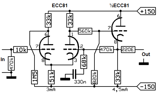

The second stage should be a cathode follower. That is the most effective gain reduction. And it could be directly coupled to the 6SN7. Also I cannot see the plate load of the ECC99.

The bad thing about the design above is just that 2 common cathode stages are excessive for a line preamp. Not even vintage stuff had that! They had a second stage if they used tone controls that typically caused 20 dB attenuation or if they used feedback. Even if the Ecc99 plate is attached to an ouput transformer with (typical) 4:1 stepdown ratio, gain is still too much.

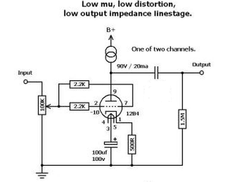

Many options are available, when line stage gain is truly needed. 2 examples I'm associated with are provided. I claim no more than solid performance and comparatively limited gain amounts.

What is wrong about the initial circuit posted is that there are 2 gain stages and gain is really excessive. That's all.

Noooooo someone is either jerking you around or you are misunderstanding their directions.
What ever the case may be, I can tell you that this circuit you posted is pretty much fubar.
I would just scrap that schematic and build a basic 6sn7 compound circuit. I would link a schematic, but I am having a hard time finding a good complete schematic for you to follow.
Maybe someone else can help me/you out here.
Thank you for your help sir. This circuit is supposed to be a classical /simple circuit to my limited knowledge. ECC99 drives a pair of output transformers may be a info so that this circuit does not seem to be fubar?
This circuit drives a pair of output transformers if it explains the plate load of the ecc99. I wonder how should I modify my circuit to make the second stage a cathode follower and if it can still fit the original design (driving a pair of output transformers and work with the original B+)? Thank you very much for your help sir.
... 2 examples I'm associated with are provided...
Eli, what's the purpose of the LTP in the second circut? Is it there just to cut the gain in half?
