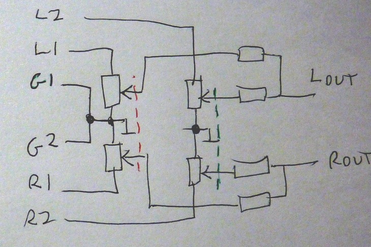

You are best off with an active circuit for a balance/pan controls, more flexible and easier to play with the response curve. However a 10k linear dual-gang pot can be used as a pan control, with reversed sense on the two gangs (ie fully anticlockwise is 100% for one output, 0% for the other and v. versa). If combining outputs from two of these you need summing resistors on the wipers so that the controls can't cross-short the inputs to ground. (For instance if channel 1 is panned to left and channel 2 to right, the left wiper on 1 is input 1 left and the left wiper on 2 is ground - commoning these left wipers directly would short the left input 1 to ground).

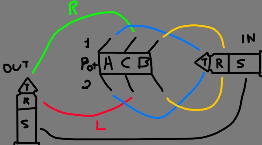

I'm trying to figure this out. I don't really want an active circuit, no idea how to do that, my knowledge on the subject is very limited and I just want a simple tiny box, just big enough to fit a pot and to jacks inside and put it under my pedal board.
I was thinking something like this, but in this case, the output signal would be mono when the pot is centered. if I flip yellow and blue on channel 1 or 2 on the pot, the signal is stereo while 100% clockwise, flipped stereo while 100% CCW and still mono centered.
is this where the resistors come in? if so, what kind of resistors should I use and where exactly to connect them?
Looks like this would be suitable. Panning is really for a mono input though, not for stereo.
You could convert each stereo input to mono with summing resistors, and then use the circuit below.
The level pot is a log type, and the pan pot is linear.
@Mark Tillotson , if I got it right, in your diagram each pot controls both same side channels from both inputs at the same time but sending them equally but reversed to each side?
I suppose that would work, but I kinda wanted to pan each channel individually and then combine them later, so I was thinking of the circuit as an individual channel so far.

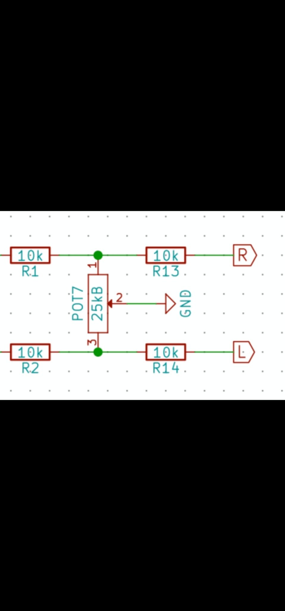

I agree your circuit has stereo in and out but it is a stereo balance control not a pan. That circuit can be reconfigured as a mono pan, in fact it if you short the two inputs together it is a commonly used pan circuit.
Cheers
Ian
True. Its balance. But how do you pan stereo? Balance should work.
He can have these circuit twice, since he has supposedly two stereo signals, then just sum two left channels, and sum two right channels. All remains stereo.
That was my understanding what he want.
