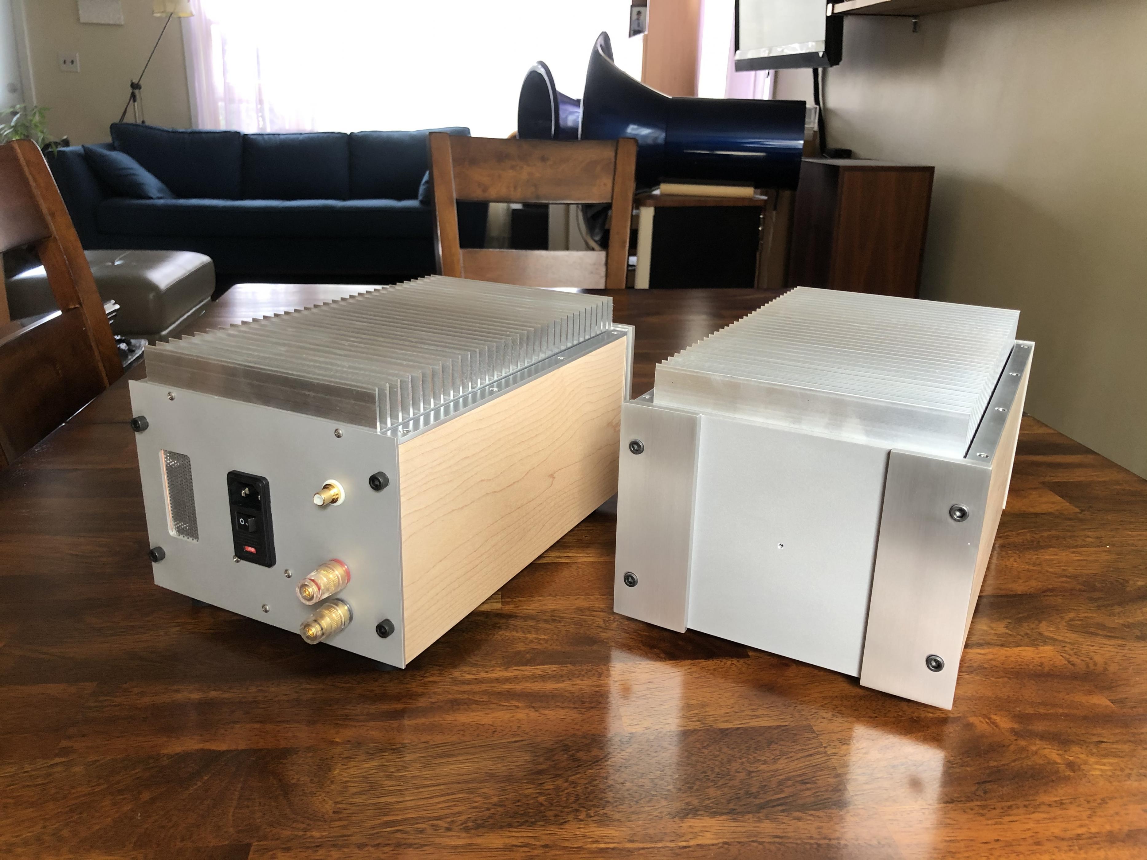

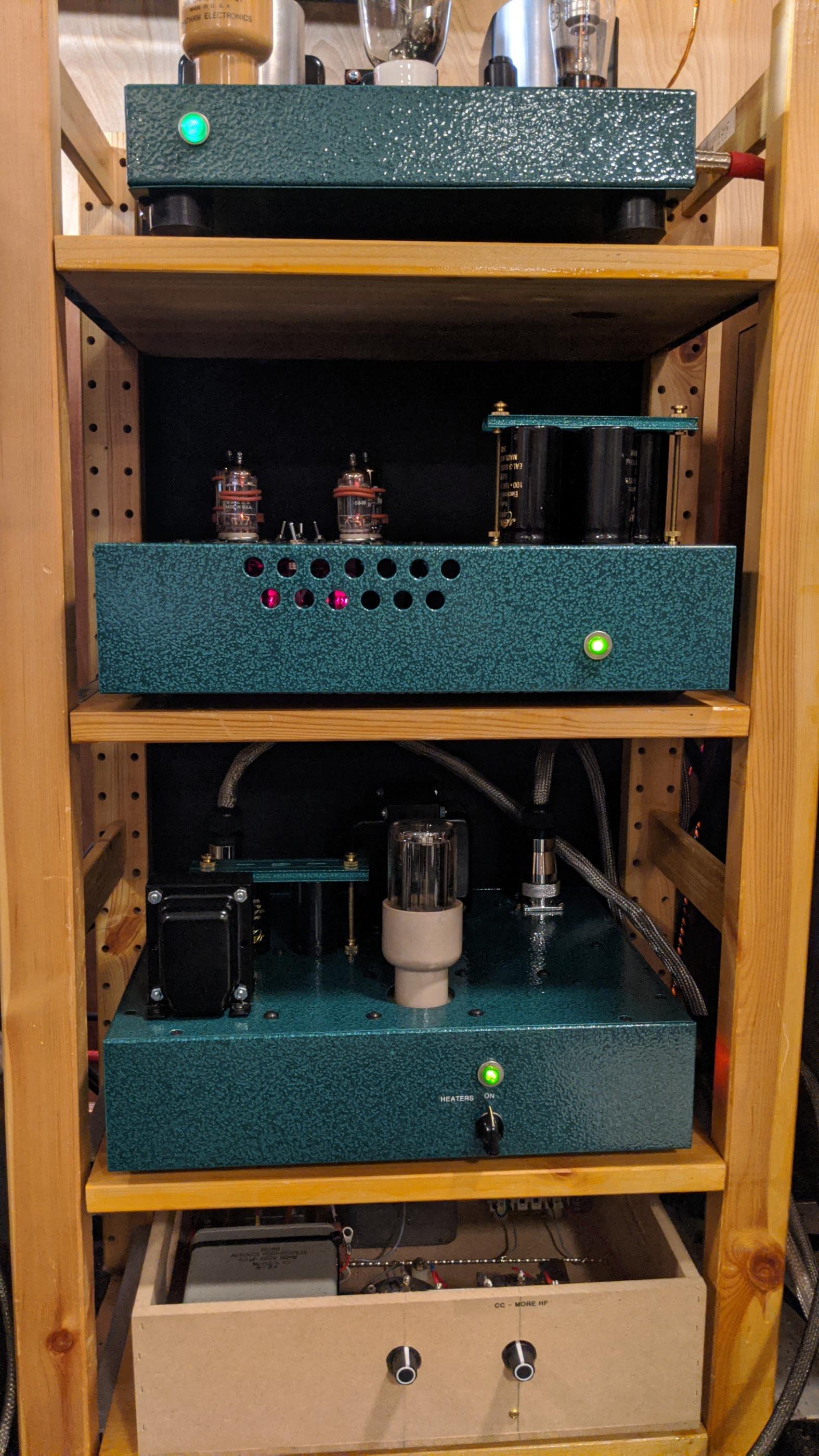

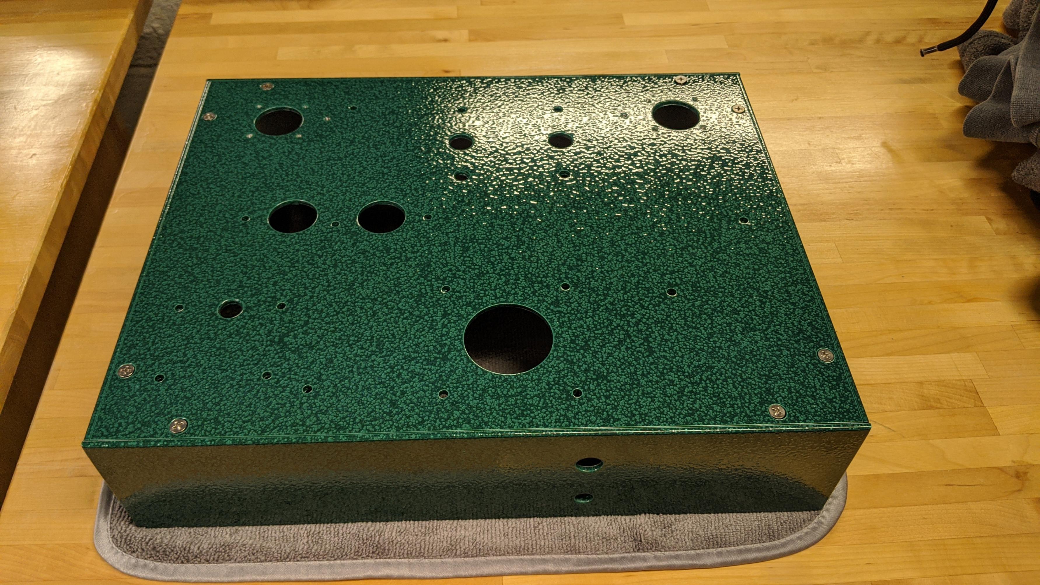

I attached a pic of one of my most recent projects which is a pair of F2J monoblocks I built from scratch. I wanted some contrast, so with these I glass beaded and waxed some of the chassis parts.

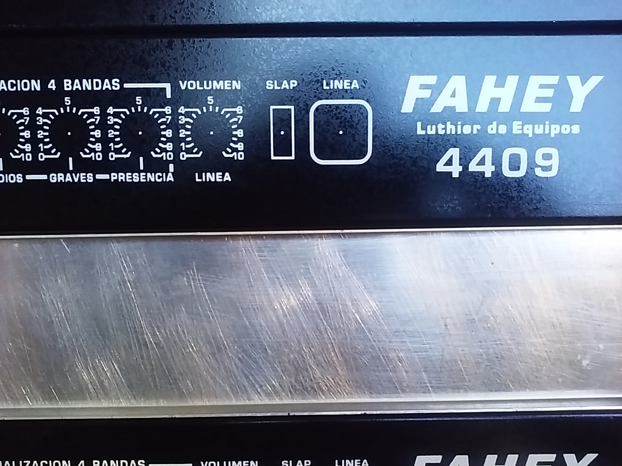

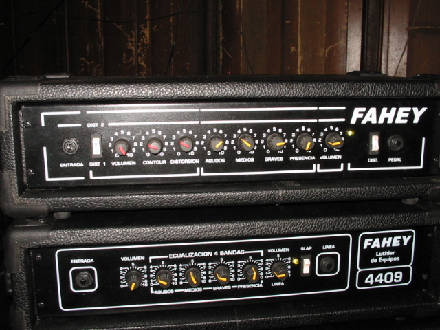

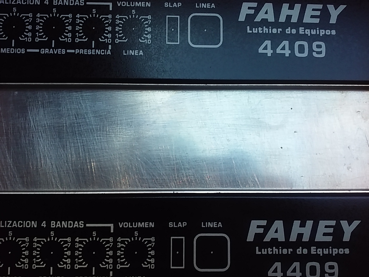

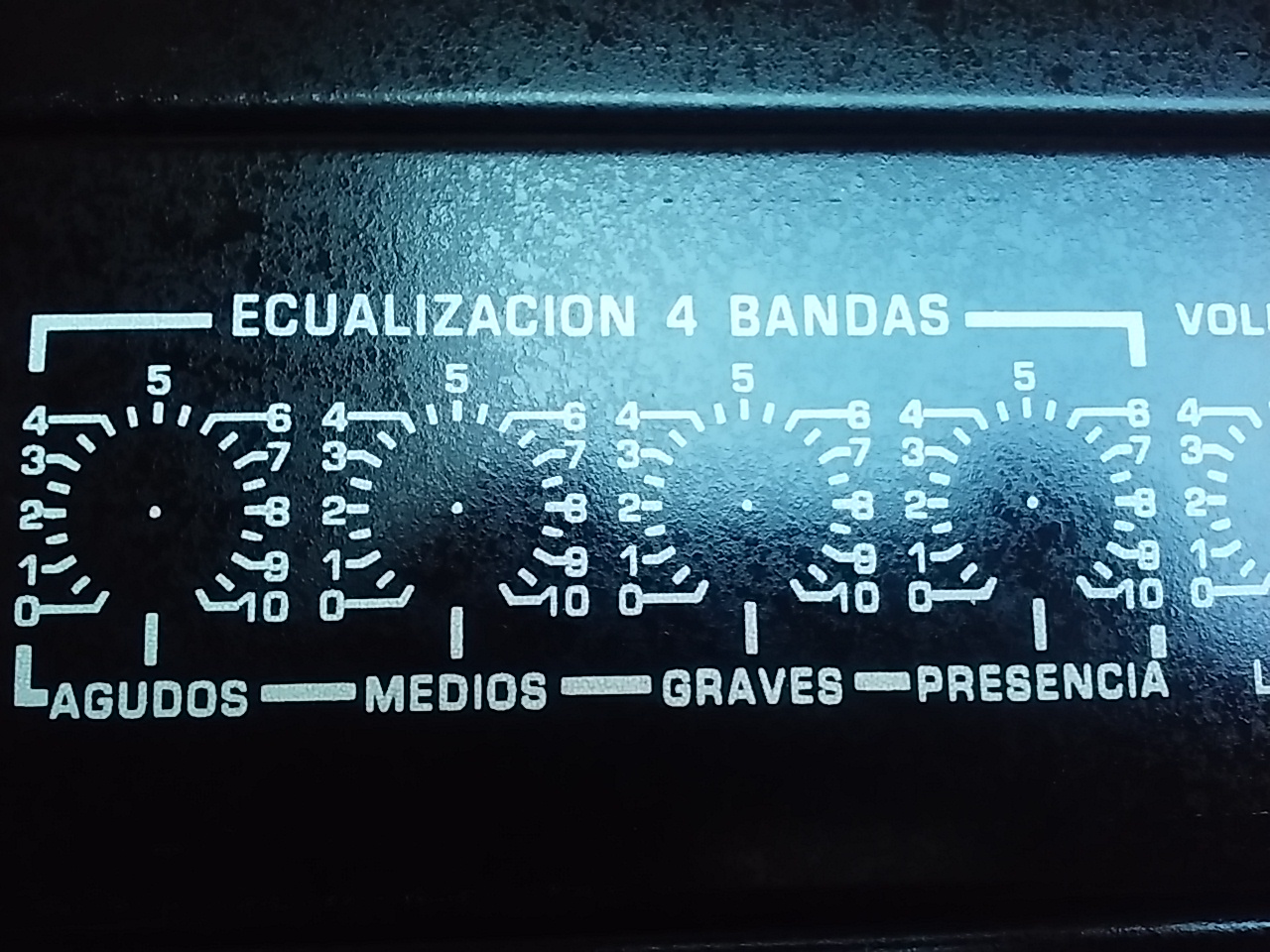

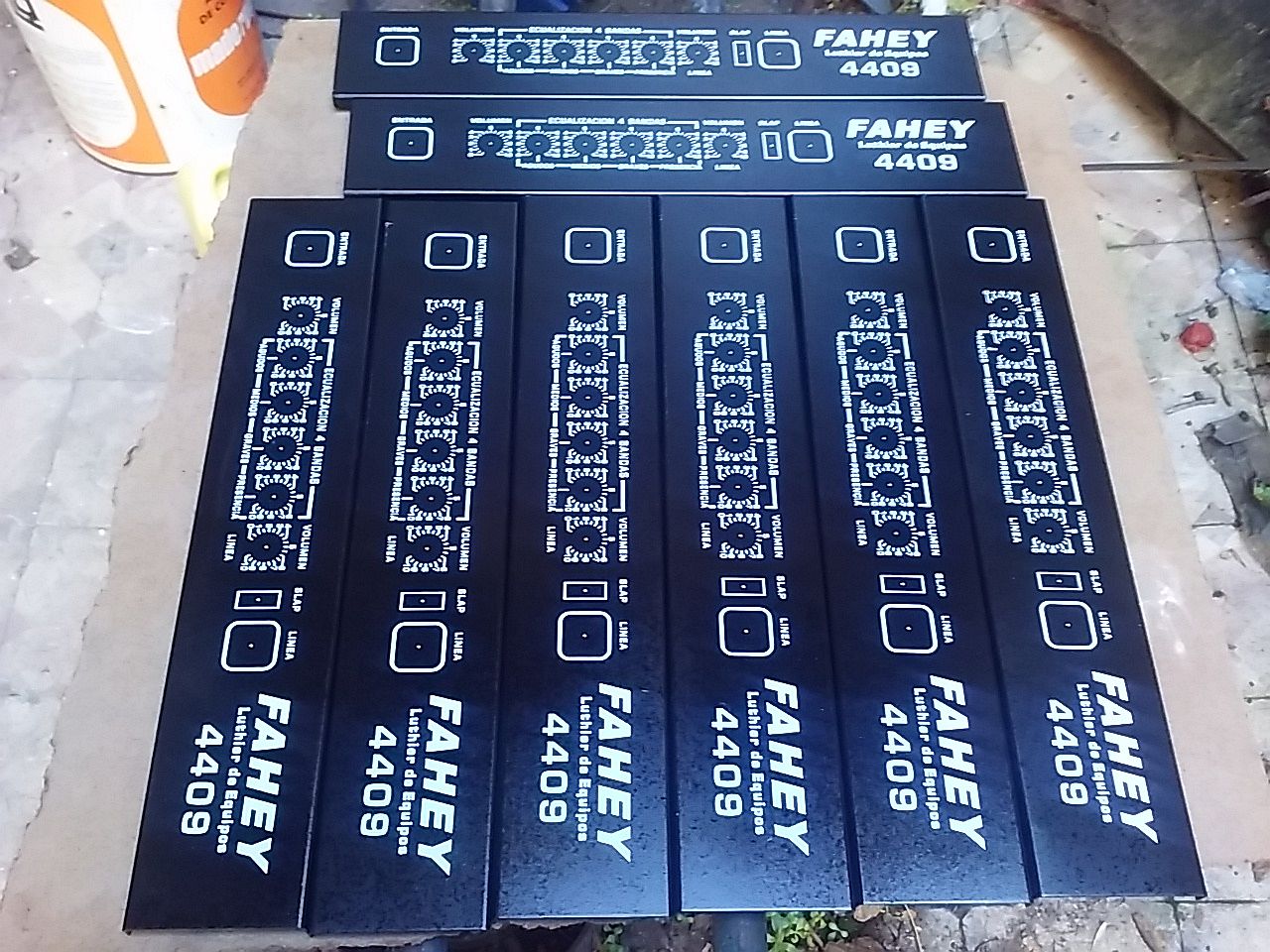

I make my own Guitar and Bass amplifier panels out of raw 1.6mm aluminum sheet, which I cut - bend - treat - paint - silkscreen - punch in-house.
After cutting and bending aluminum gets wet sanded with medium grit wetordry paper simply to remove gross scratches and blemishes, and get a rough surface which facilitates painting.
No special scratched pattern is searched for since it will disappear under large drop spray painting ... a common finish in MI amplifiers.
This is this morning´s batch, not too many since quarantine sales are sllloooowwwww but since I sold two 100W Bass amplifiers, I made 8, had used the last one past Friday.
Can make 1 if strictly necessary and urgent, but setting up machines, cleaning silkscreen panel and tools, cleaning spray paint pistol, etc. is the same for 1 or many, so usually 8 is the minimum batch, up to , say, 30 or 40 .
For a "Powdercoat look" equivalent which would make me set up an oven , I use instead, first a two component wash primer precoat, and then, believe it or not, Nitro or Acrylic "car paint" which is very noble, easy to use, clean, reuse (it´s thinner based), can be touched up (Musicians abuse their equipment), etc.
Currently using excellent Akzo Nobel products, including their traditional "Taxi Black" car paint.

Is that a bottle of orange juice for orange peel effect?https://files.diyaudio.com/forums/images/icons/icon12.gif
Very nice panels.
Very nice panels.
Thanks 🙂

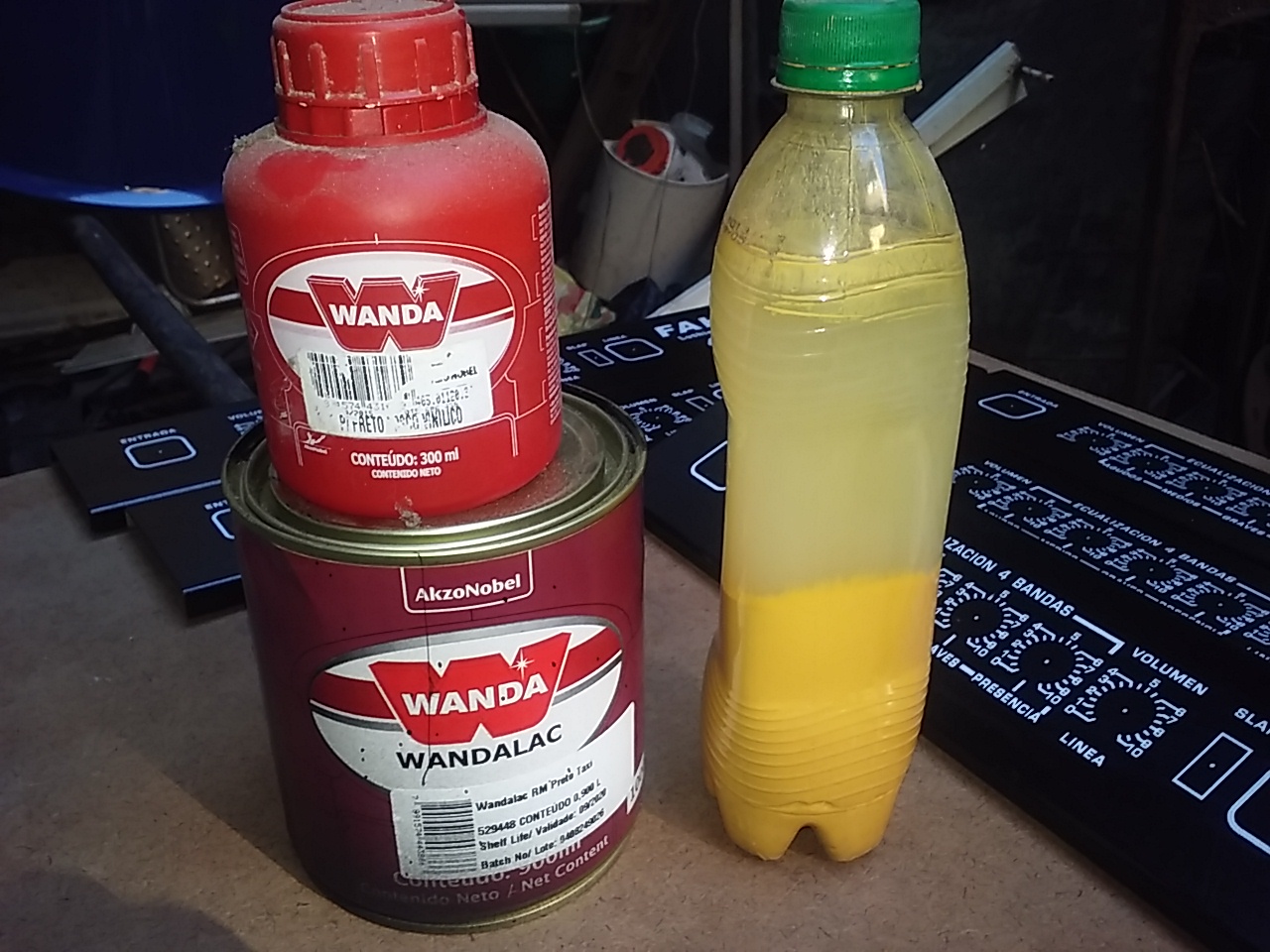

It´s the chromate part of 2 component wash primer, the secret weapon to make any paint stick HARD to Aluminum.
It separates if left standing so it must be shaken well before mixing, hence the transfer to a plastic soda bottle 🙂
The activator in the red bottle is basically phosphoric acid and ethanol, to attack aluminum surface creating pores where paint sticks, plus triggering paint base hardening.
First few hours you can lift it with a fingernail ... once it fully hardens (a few days) you need to grind it off 😱
