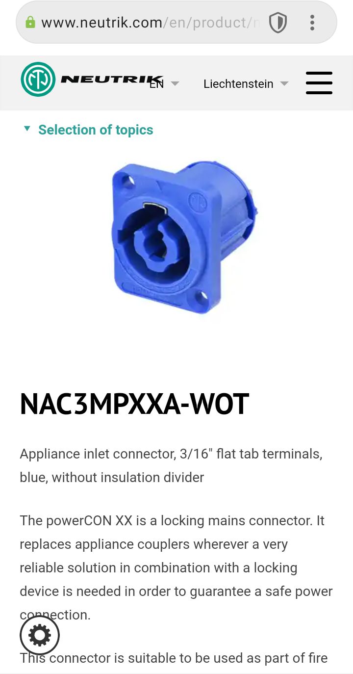

Although if you don't need the IEC type of plug/socket, there are IMO superior alternatives like powercon connectors from neutric. They also make connectors for speakers, so don't confuse the two.

Best by far and designed as locking since day 1: Neutrik Powercon
https://www.neutrik.com/en/neutrik/products/powercon-r/powercon-r-xx-series
