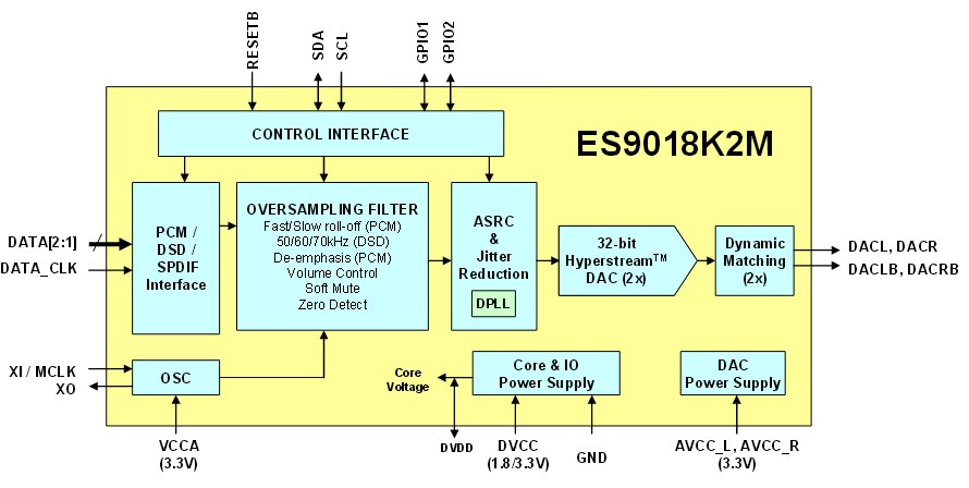

On ESS internal architecture see attached.

The Ess internal architecture is very simple and doesn't have much information how it work inside.

Yes I don't think that internal diagram is very revealing of what goes on inside the ES9018. This paper has more details but seems to be only talking about a 1bit DAC : https://www.ias.ac.in/article/fulltext/sadh/043/06/0091
