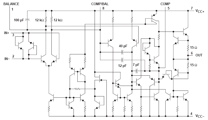

Can someone show me the method for tracing a signal path in an amplifier schematic? I'm completely unsure how a signal path is determined.
Attached is a NE5532 schematic for an example.
Thanks!
Just go from the base (input) to the collector or sometimes the emitter (output). In this case there are two paths, one for + signal, and one for - signal.
This one is more difficult, and there are many extra devices for current sources and current mirrors. Start with a simpler discrete design.

It may help to remember that a BJT/FET base/gate is unlikely to be an output, and a BJT/FET collector/drain is unlikely to be an input.
In a DC-coupled circuit it can be difficult at first glance to distinguish between bias circuitry and signal-handling circuitry. This is partly because the distinction is one we make for our benefit; the circuit just obeys the rules of physics, and physics does not distinguish between bias and signal.

I would make a suggestion after determining the input and output trace backwards from a forced intended output to what the conditions must be at each node to "make it so" all the way back to the input. The other way around for most high gain circuits will soon hit a limit.
Look at some Japanese amp circuit diagram from their service manual. They usually indicate the signal path by a thicker line.

The internals of an opamp are probably not a good example for someone learning the basics imo. There's a lot going on in there, lots of "basic" building blocks all of which interconnect, but you need to be able to recognise those and just as importantly, have some idea how they behave.
My advice would be to start with simple one and two stage amps and really get to grips with how they work... and then progress to more complex configurations.

I suggest learning some of the basic building blocks used in discrete circuit design or integrated circuit design. Once you can recognize a differential pair, cascode, and the three common single-transistor amplifier stages, you can break the circuit, such as the NE5532 into blocks and find the signal path (or paths) that way.
Sedra/Smith, "Microelectronic Circuits" would be a good place to start. I've linked to the most recent edition. The older editions are just as useful and can be had for much less on the used market.

The path does indeed get quite complicated in some circuits, especially symmetric/differential ones - best to start with a classic 3-stage amp circuit and the path is less confusing - note with feedback there are two basic paths, non-inverting input to output and output to inverting-input (the feedback network).
With class B the forward path splits at some point to the drivers, but it can be thought of as one path that switches on each half-cycle.
A path will lead from say input to output without side-arms (in other words ignore parts that go off to the rails or ground, they are not "on" the path).
Opamp circuits are usually very easy to trace too.
In the classic 3-stage circuit the path goes from input pair to VAS to drivers to outputs, the feedback path is just a passive network from output to input pair - easy to add to a diagram with highlighter pen for instance.

Most audio circuits end up as signal loops (feedback) - a simple front in - back out cannot be defined. These correction, control loops serve to suppress swing (electrical circuits are also swing systems, comparable to mechanical ones such as piano strings and piano)

Most (commercial) amplifiers (and integrated circuits) are 'loop amplifers', relying on the negative feedback correction to flatten out all errors.
So 'tracing a signal path in an amplifier schematic' is like poking within the loop, most often with capacitive probes and antenna alike wires and other nasty things. It is only at the last voltage gain stage (the "VAS") where the signal reappears as if from nowhere. That is of cause because the correction signal is 'masked' by the feedback factor (At = Ao / Au). So within the loop, the signal is hardly tracable.
Say the fixed overall gain is 20dB (10x) and the open loop gain is 100dB (100.000x, not uncommon in opamps), the feedback 'supression is 80db (10.000x).
After the input differential stage, the input signal of say 150mV is 10.000x lower, a mere 15μV. That is actually the very error signal itself... if you want to measure it, your measuring action is now part of the error and spoiling the measurement as a result. The position and velocity of any particle cannot be determined together. That seems to be a fundamental law...
