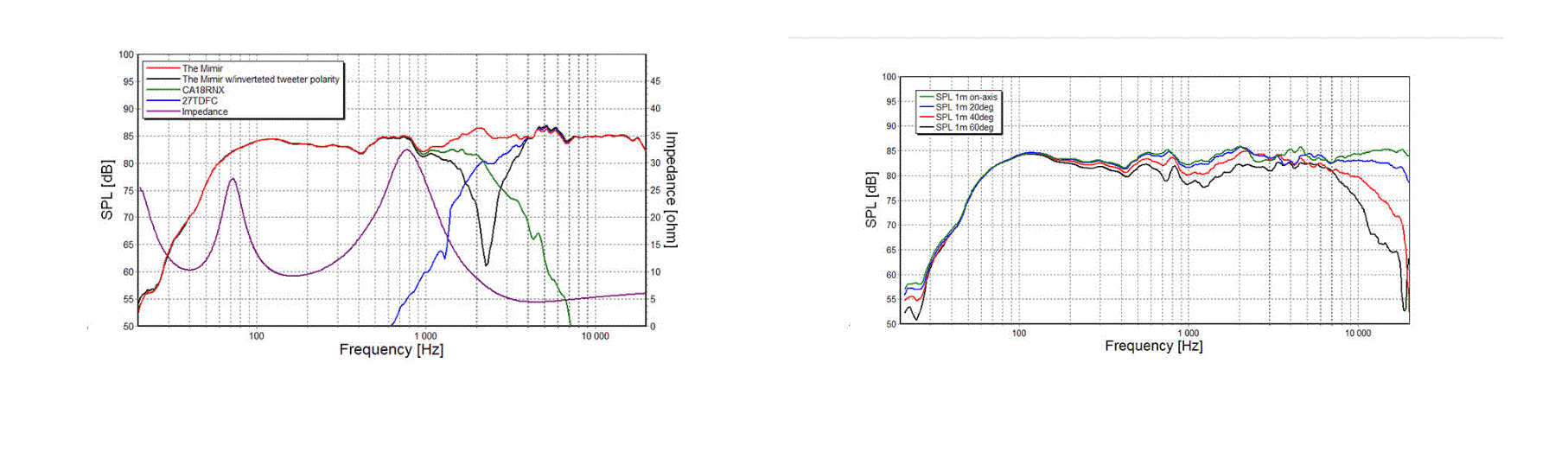

Some time ago I built a pair of Seas Mimir speakers. As it turns out they very occasionally sound a little harsh in the mid range on some recordings, especially clean amplified electric guitar sounds. Frequency analysis of the speaker with TrueRTA shows a few dB lift for an octave or so around 2khz.
What I noticed is that the tweeters (seas 27TDFC) are not flush with the baffle, in fact on the right side it is proud by about 3mm in some places and near level in others.
To be honest, these were my first attempt a building a speaker in some time. I'm thinking of cleaning up or rebuilding the cabinets anyway.
My question is: does it seem likely that this error is enough to cause a 3-4dB peak in midrange response?
Many thanks in advance for any help with this!

The link from giralfino is interesting but probably not showing all the picture?! 2KHz? 3/4KHz??? What crossover?
It must be something else. After saying that what system do you have? You only mention the SEAS Prestige 27TDFC (H1189) Textile
I would say, guessing, that you are using a first order. To little info here to be objective.

Sorry I did not originally include the link, the speakers are built to the Seas Mimir spec: (Mimir DIY Speaker), at the moment there are essentially no adjustments and the crossover is implemented to spec. Cabinet is built from 18mm high grade Birch plywood.
What is interesting on the Zaph audio site linked above is that there is a speaker very similar to the Mimir (ZR71); on that page in the room placement section off axis listening is recommended. Further, looking at the off axis SPL on the seas website shows a similar trend.

Ha, the link says it all.
The -3dBs crossing is giving the bump by summation. Bad implementation, drivers and crossover (to many problems to solve/sell). Probably the best Seas got @2KHz...
Tony already mentioned in the previous post.
7" SEAS CA18RNX (H1215) - https://www.madisoundspeakerstore.c...ige-ca18rnx-h1215-7-coated-paper-cone-woofer/
7" SEAS ER18RNX (H1456) - https://www.madisoundspeakerstore.c...stige-er18rnx-h1456-7-reed-paper-cone-woofer/
If you can or don't mind using a FAST, move crossover to 400Hz. I would use the SEAS Prestige ER18RNX (H1456) 7" instead of H1215-08 CA18RNX, look also at the voice coil inductance it's almost double. Build up new speakers with a small fullrange driver and shelve the tweeter for a future build, or use it then for two different projects. You will probably end with a 3-way with the new midrange, but it will make you think and DIY!
