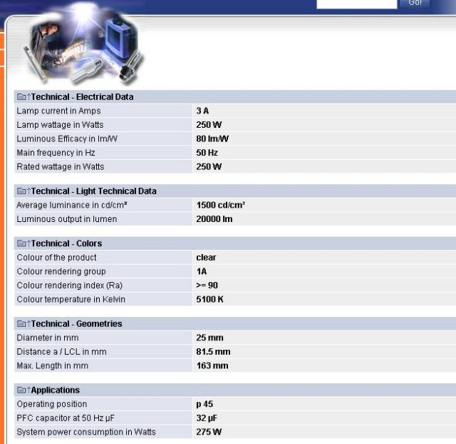

I have crisped cardboard and mdf with a metal halide, im only running a 250W too. If your bulb is too close you could always try a couple layers of aluminum foil on top of the wood. Shiny side towards the light is best! Im using half a beer can to save my wood until i buy a better reflector and/or finish my design.
Here is a screen shot of the osram specs on the bulb i have, its basically the same as the diylabs double ended bulb, but way better in cri, colour temp and it has the uv block.
Trev
