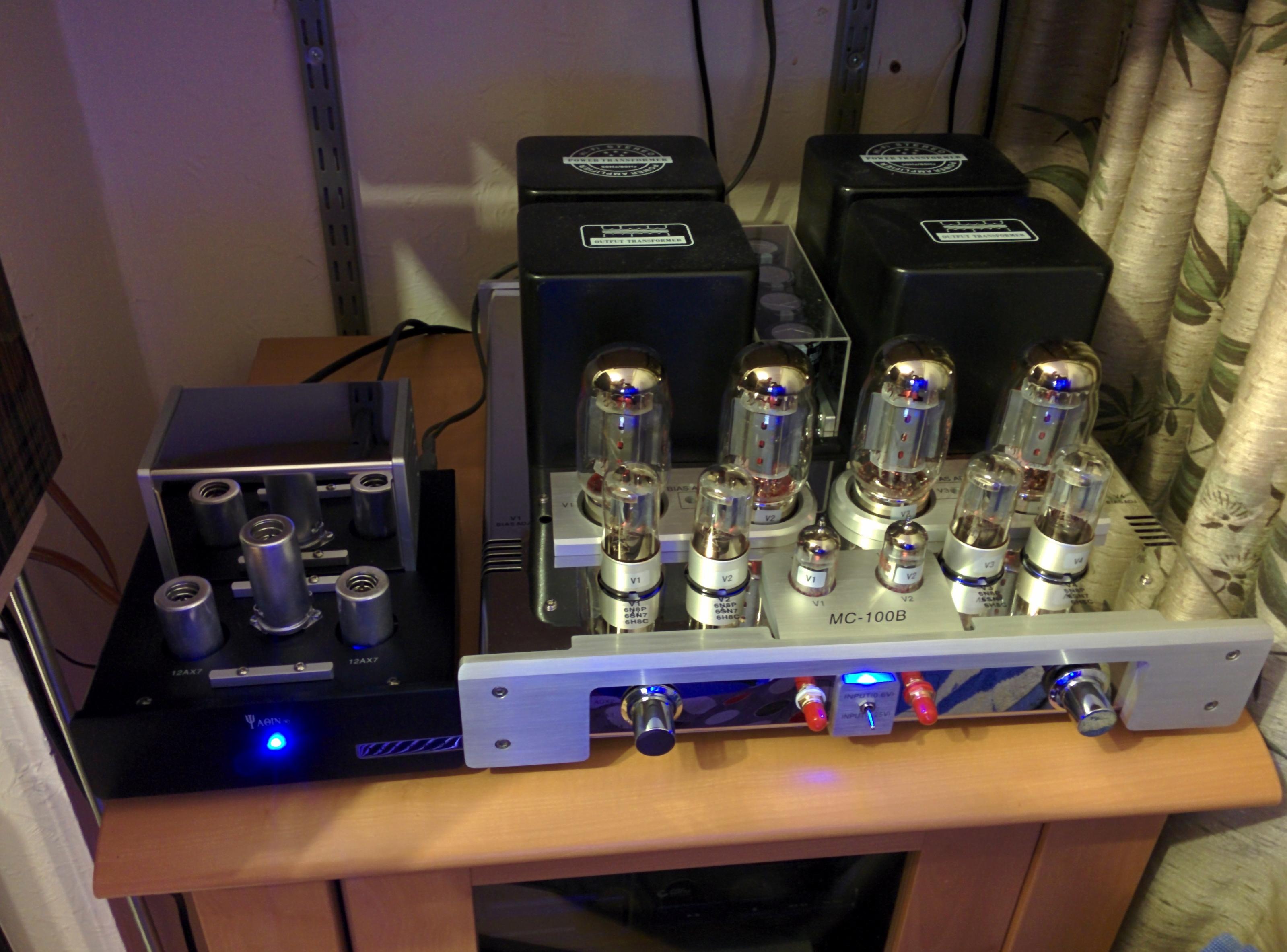

Also should place question that, who did mod? It is some how thought difficult, but instructions are good, thanks to Les. Who can solder and read can do it...
I have MS-23LB. I did mod myself.

Thanks Les. I have another question for the posters on this thread. What phono preamp were you using before the LesBox?
For me, it was an ART USB Phono Plus which I think is a very good preamp for the money.
I was using a Bryston 1b then converted my MS-22b. I also had a Musical Paradise MP-P1 with 12AX7 Tele's (Smooth Plate) and directly compared it to the Les Box. I've sold them all except for the Les Box and I've never been happier. 🙂
Now that winter time approaches perhaps you can have a go at making an outboard Les Box. WHY? Because taking the circuit away from the power transformer gets rid of the last tiny bit of hum. You can build a separate power supply or use your MS22 or 23 as a power supply only? I tried it and it works very well though the Yaqin looks strange with the Blue light glowing but no tubes in it 🙂
I have tried to make the task of building a remote Les Box as easily as I can, the removal of the last vestige of hum will particularly benefit those using MC's and SUT's.
