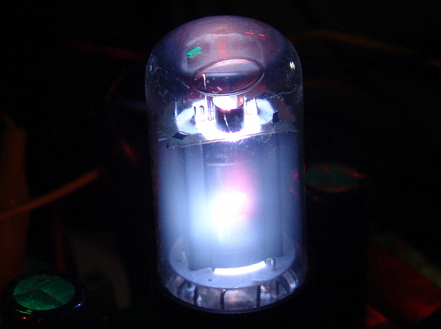

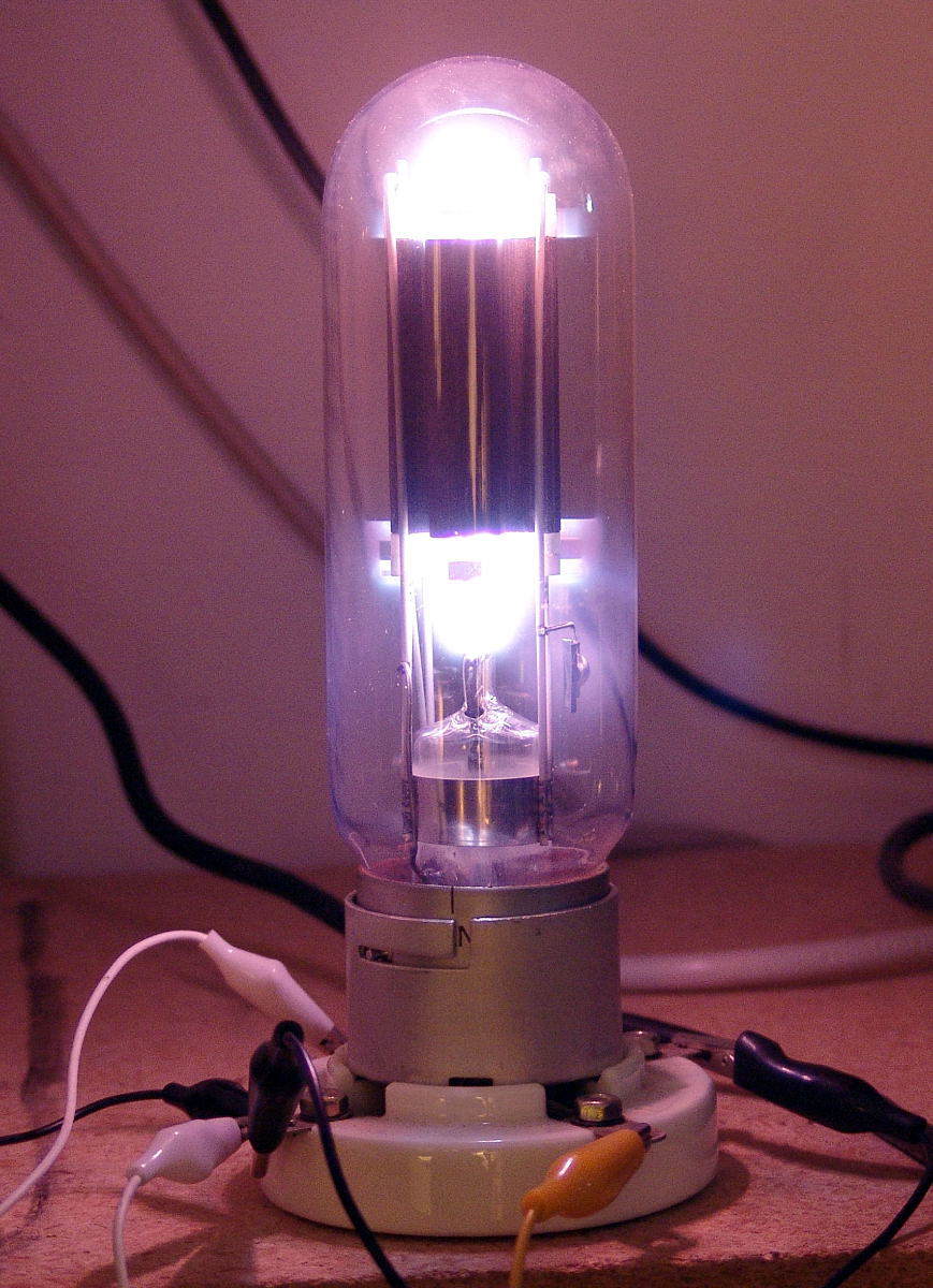

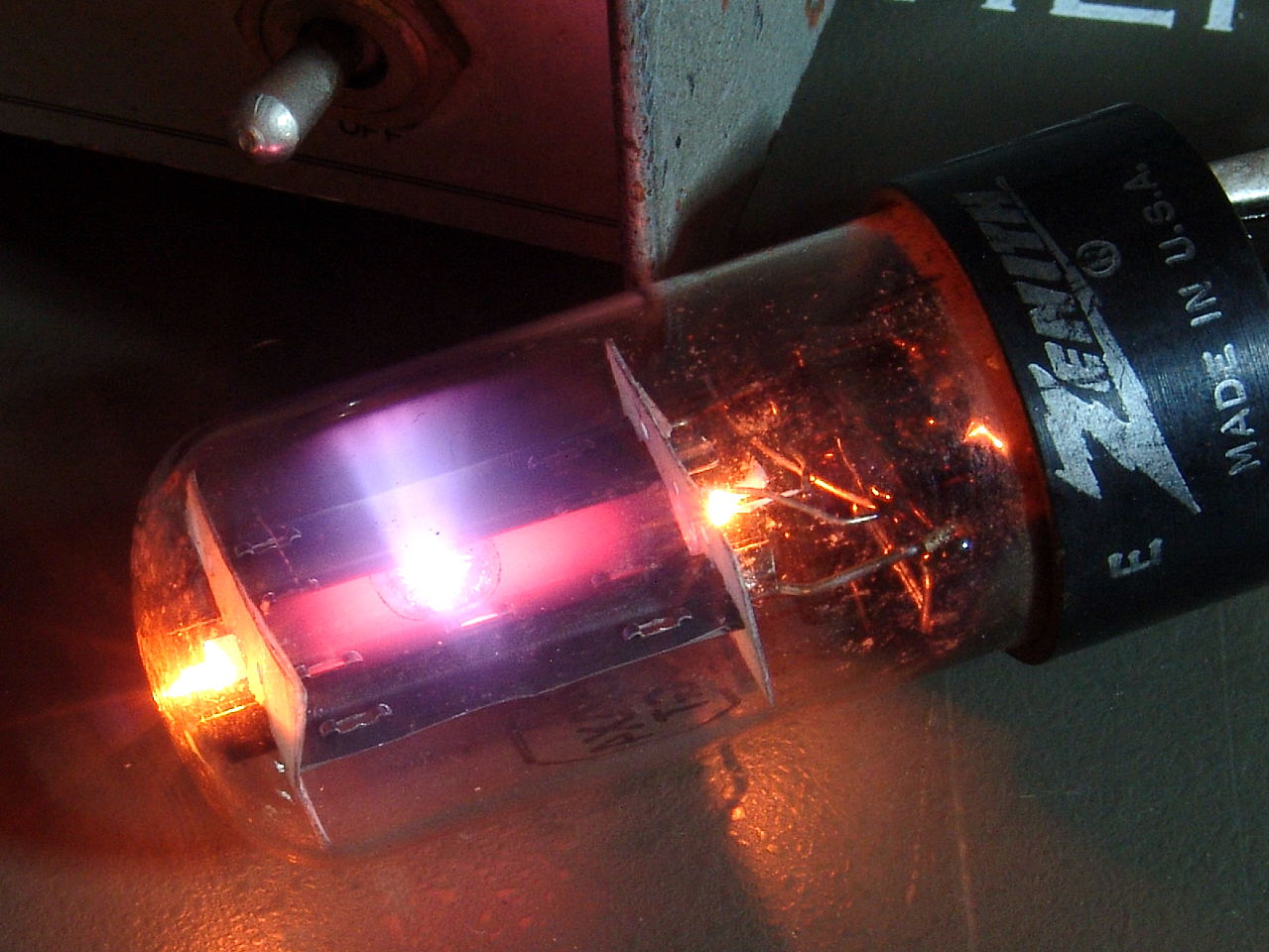

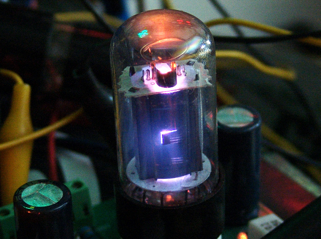

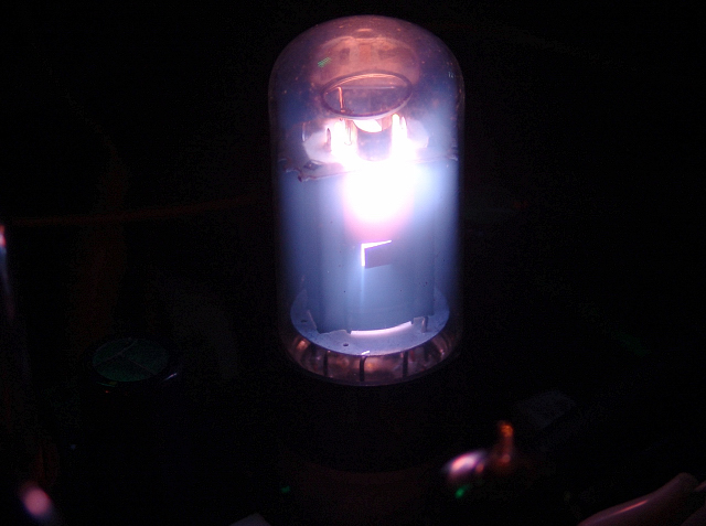

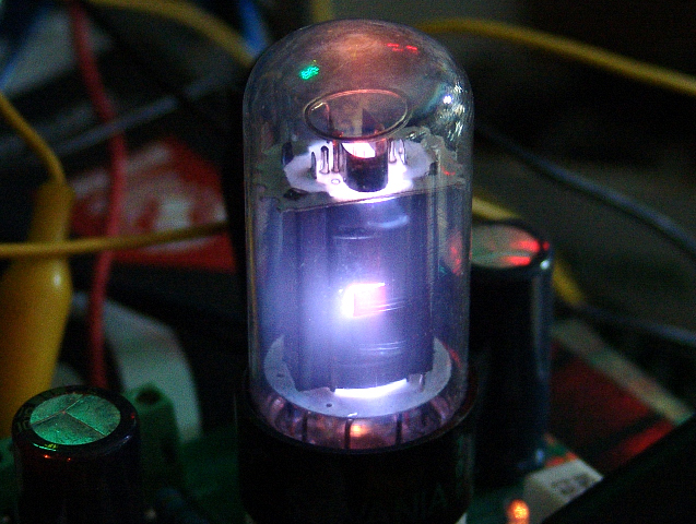

The tubes in these pictures are ALL BAD and some are BLUE. The last 6V6 was so bad it took out the amp blowing the cathode bypass cap all over the room. I might have leaned on it a bit just to see what would happen🙂
