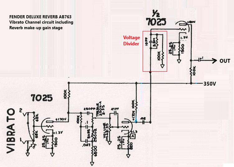

In a classic tube guitar amp like a Fender Deluxe Reverb or Twin Reverb, when you dial in a 'clean' sound at moderate old-style country music or jazz combo volume, about what level of THD is there in the signal from the amplifier (not including the speaker here)?
1% THD?
3% THD?
5% THD?
10% THD?
More?
I'm playing around with designing a guitar preamp with pre-gain and post-gain controls. With the pre-gain down at '1' or '2', I'm wondering what level of harmonic distortion should be in the output signal at that point. I figure at least 3%, 2nd and 3rd harmonics dominating, but I don't actually know.

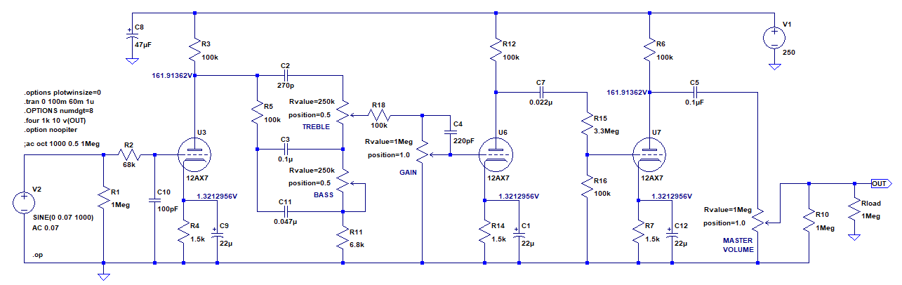

I do have Merlinb's book on designing guitar and bass preamps. That inspired me to try some things, like choosing pentode operating points to
get some compression of program peaks, using grid current in a cathode follower to add some flavor, and tailoring multiple stages in series to get a particular distortion profile.
Here's the circuit I'm toying with:

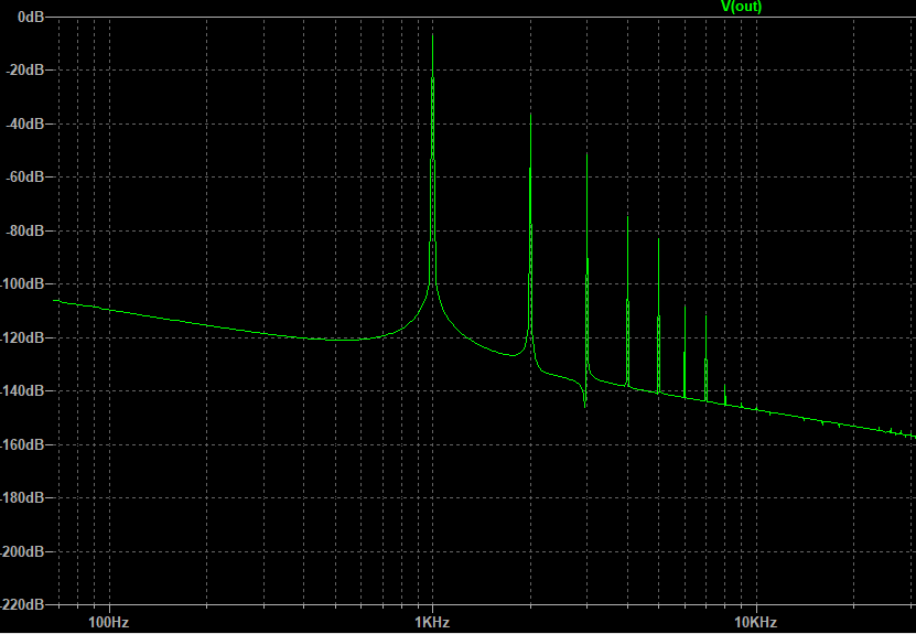

The above circuit, with the Treble, Bass and Mid controls set at 50%, the Pre-gain set to 10%, and the Post-gain set to 100%, yields about 430mV RMS output signal (unbalanced output), which is about 6X gain.
With those settings and 70.7mV RMS input, the output FFT looks like this (3.3% THD):
Too much THD? Or would that be a nice, rich 'clean' sound that would still allow playing full chords?

FWIW, I used to do jazz gigs with my Deluxe Reverb. I found it wasn't quite loud enough to stay subjectively clean sounding if the group was a boisterous quartet of saxophone, guitar, acoustic bass, acoustic drumset playing in a live room. I eventually swapped out the power transformer for a Thordarson with 150mA plate supply capacity, swapped out the original OPT for a Fender Bassman clone (w/ 8 ohm tap), and put 6L6s in the amp for a whopping 34W output (RMS, measured into an 8 ohm resistor). That was my trusted workhorse for about a decade, after which I stopped playing gigs and got a regular job.
I've also experimented with different tone control circuits, which do all sound somewhat different. I like the Fender 'Blackface' circuit's 'quack', but I also like the smoothness of Ampeg's version of the classic Bauxandall passive tone controls. But there is more to it than the tone controls, of course...
One thing I'm sure everybody's noticed about the Fender blackface amps with reverb is that the Vibrato channel always sounds better than the Normal channel. Nobody ever wants to use the Normal channel. Why is that? Well...
The Vibrato channel has three 12AX7 gain stages, with a voltage divider to knock down the gain before the last stage. As below:
The mid-1970s and later versions stuck a 1M ohm Master Volume control after the output (labeled 'OUT' above).
Let's see if I can throw that circuit into LTspice and see what it looks like.
As shown, with 0.7mV input, it yields 40V output at 3% THD. ((🙂eek🙂))
That'll blow up a soundcard input real good!

Same with Bassman Heads.One thing I'm sure everybody's noticed about the Fender blackface amps with reverb is that the Vibrato channel always sounds better than the Normal channel. Nobody ever wants to use the Normal channel. Why is that? Well...
