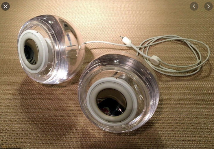

There are no miracles. You can fake things with dsp though. Even the Apple 2" speaker from Harmon Kardon from yesteryear sounded OK to many persons. It had huge excursion and a metal cone so if you need something like that...
