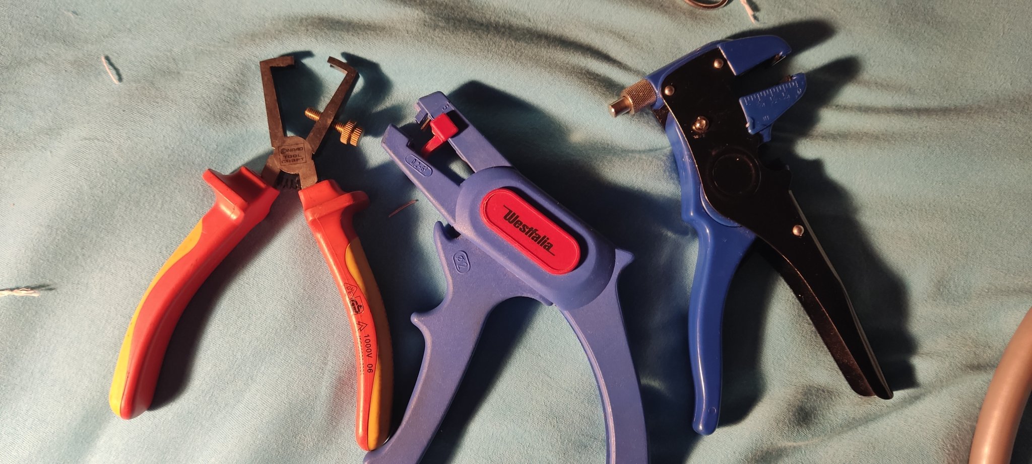

Hi
I bought this cable here https://www.audiophonics.fr/en/cabl...lded-power-cable-occ-553mm-o165mm-p-6456.html
Now I need to remove the Teflon insulation surrounding each conductor, it's really thing as you can see on the pictures. I would really like to avoid damaging the copper stands, I already had to cut away 3cm of cable because the only way I managed to remove the Teflon was with a knife and peeling it a way like potatoes. I tried 3 different cable removal tools (see picture= and couldn't get any to work, maybe they are not suitable for this situation I am not sure.
It's really elastic, almost like chewing gum and it's a very thin layer.
Suggestions are welcome, I have never done this before.
Best regards and ty vm

Oh those will not work. You would need to use a cable stripper pliers similar to the ones below. These pliers will cut the insulation around the copper core (notches prevents you from cutting the copper).

The "japanese" wire strippers also can strip these cables. Almost any wire stripping tool with 2 sharp halfround knives (not touching the copper!) will do. All 3 pictured wire strippers only touch the insulation at opposite sides. That is not enough for teflon.
These are quite good for most wires: https://www.knipex.de/produkte/abis...essern/abisolierzangenmit-formmessern/1221180
Please note a version exists for smaller diameter wires. I have one and it is one of the best I have.

Hot wire strippers are available for Teflon.
They will NOT damage copper below,since no sharp edges are involved, at all.

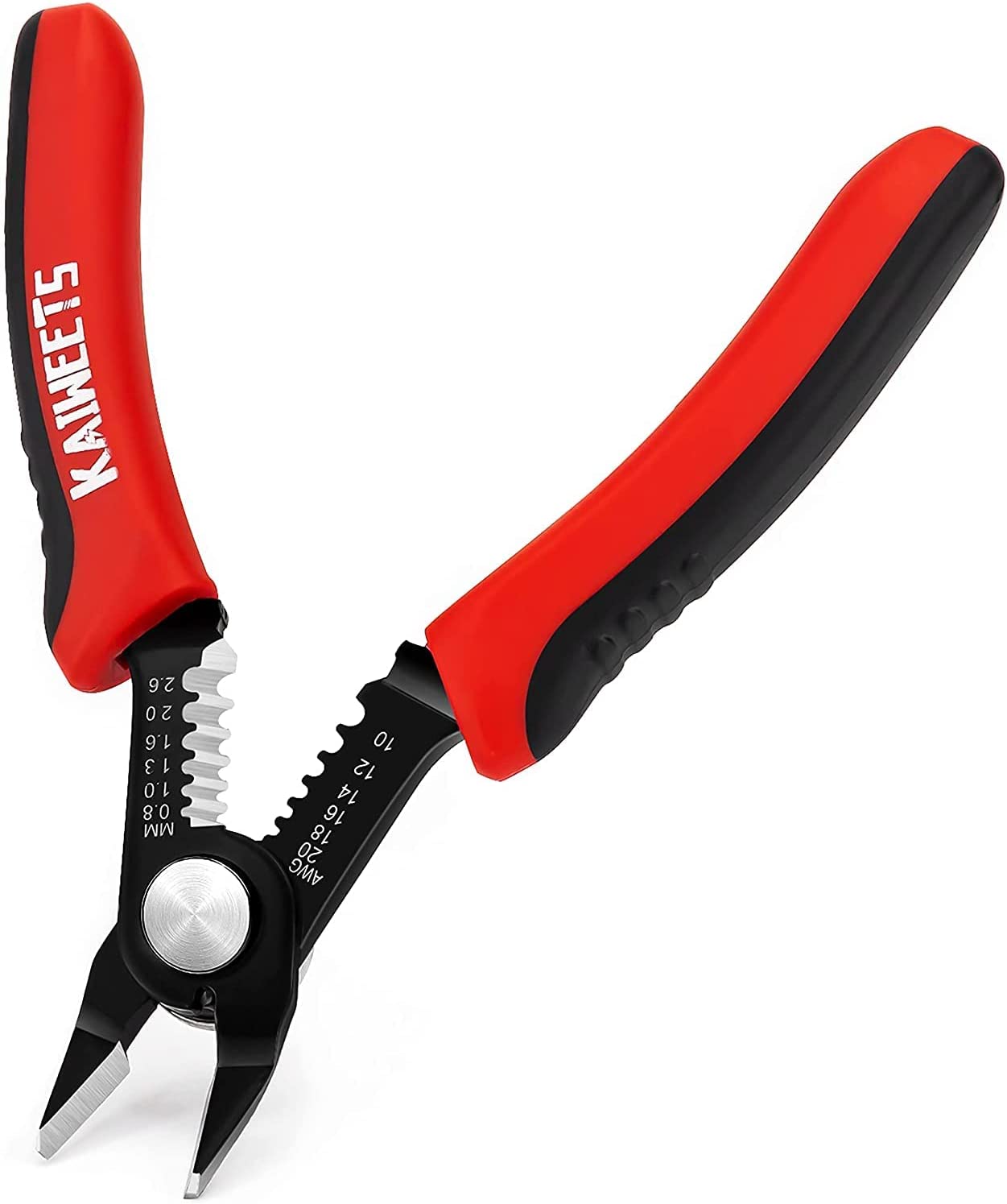

I was considering this one, it's 20 euros
Seems to cut clean, only issue I see is that considering you have to insert the wire strand into the tool all the other strands would get in the way.

The quality of the famous Kaiweets tools seems questionable. Maybe good old EU brands make better stuff. There is no substitute for working with good quality tools.
