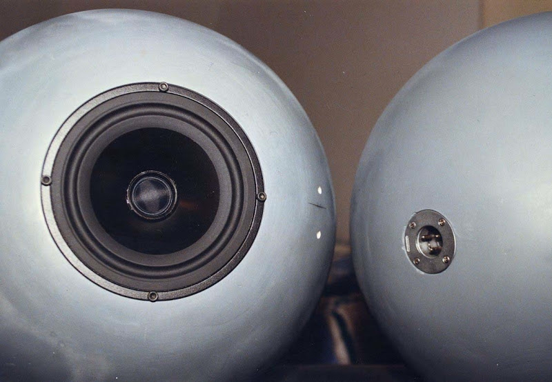

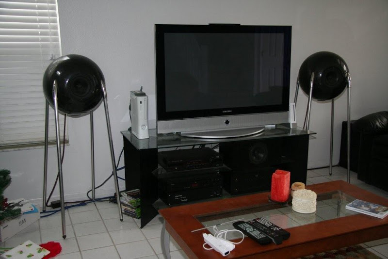

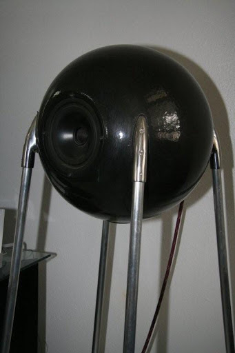

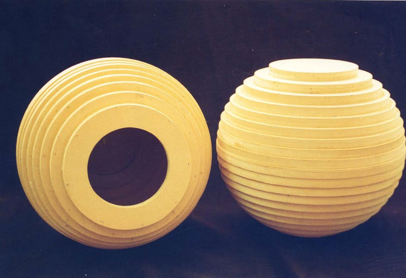

I suppose now more than 15 years later the story can be told. My Sputniks were made exactly how you describe: Rings of MDF glued and stapled together with an end cap speaker mount baffle cut in a lathe; then filled in with Durham's Rock Hard water putty, mounted in a lathe with an 8 inch bed (can hold a 16 inch diameter work piece), and spun by hand while rasping and sanding away until they were pretty smooth by eye; and then primed with sandable spray primer; and finally a thick coat of hammered finish paint. Before we got the lathe I started to make a horizontal axis potters wheel-like mount for spinning them...

The potter's wheel was going to be made from an old sewing machine stand, but I didn't finish it. It would have been fairly handy, as putty dust made a mess of that lathe.
I didn't use the lathe's motor to spin that large heavy sphere, but instead spun it by hand while I shaved off the extra putty. The MDF edges were at the sphere's OD, so I used a 'surform' shaver (see pic) mostly, and course sand paper by hand, which worked well on that Durham putty. I was impressed with the ease of use of that Durham Rock Hard stuff: just mix with water until desired thickness, and smear on with a flexible plastic trowel, one section at a time (so it wouldn't fall of while wet), and then let dry overnight. Shave that bit, and repeat...
I originally wanted to cut the rings at an angle, so there would be less to fill in, but ended up using a router with a circle jig and just cut the rings straight, making a lot of MDF dust, so I used a mask. Still, probably not that healthy...

First I tried cutting an arc with a jigsaw set at 45º, but that proved impossible to control as the blade flexed an wandered off course. Perhaps I should have thought more about a proper jigsaw circle guide and just sawing perpendicularly, as there would be much less waste sawing than routering, but the router and circle jig was already sitting there ready to go...
Although it left more to fill in, it was probably better for wet putty adhesion to leave the ring edges straight. Cutting straight also made it more straightforward to lay out the rings so that an 'inside' cut line on a larger ring would also double as an 'outside' cut line for a smaller ring. I played around a lot with laying out all the rings in CAD to make the best use of the MDF sheet and also cut as few times as possible.
One trick is to use a router bit designed to round corners. The larger the radius, the closer to the final curve! This is a bit more common in CNC machining to approximate a curve. Enough small steps and it is surprisingly close.
