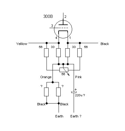

1) To measure the plate voltage, do I connect MultiMeter one probe to Pin 1 (Filament/Cathode) and the other probe to Pin 2 (Plate/Anode)?
2) I am not 100% sure where to put probes to measure the plate current. (scratch my head).
I have two multimeters with aligator clips on each end of probes so will measure both voltage and current simultaneously without moving probes to be extra safe.
I attached actual unit photo as well as schematics.
Thank you very much for your guidance in advance....
Actual Unit Photo underneath 300B tube socket
Schematic

1. The picture you attached of your amplifier parts, is not the same as the schematic you attached.
In your picture, there are two red resistors that go from pin 2 and pin 4 to the ends of a 56 Ohm hum balance potentiometer. Where does the wiper of the 56 Ohm hum balance potentiometer go to?
The schematic you posted uses self bias resistors to ground (1.8k and 2k resistors in parallel), and a bypass cap across those resistors to ground.
There is no fixed bias, and no fixed bias adjustment in your amplifier schematic.
2. 300B tubes need to be oriented in a vertical position. If you turn the amplifier upside down, the chassis top needs to be on a level plane, it should not be positioned sideways.
3. Your picture shows a 0.33uF capacitor, probably a coupling capacitor. But the schematic does not show any 0.33uF capacitor.
it shows a 0.1uF coupling cap, and a 0.047uF coupling cap.
4. Without an accurate schematic, it is hard to give instructions on where, and how to make measurements of your amplifier, etc.

Thank you very much for your reply.
1) I attached photo where potentiometer output goes.
2) I now put it upside down so can access bottom and 300b tubes are standing vertically (upside down).
3) & 4) It is a problem because I could only found this schematics after spending hours of trying to locate the schematics. And, I contacted manufacturer via email and no response at all.
I thought that those potentiometers are to adjust bias. Are they not for adjusting bias but to adjust hum? I see that two screw knob on top panel that is connected to those two potentiometer so I naturally thought that they are bias adjustment pots.
That's a self-biased amplifier. No bias adjustment needed.
Awesome.... Thank you. Great to know that no need to adjust bias.
May I ask what the 2 x potentiometers that are adjustable from top plate do?
The other gentleman mentioned "Hum balance potentiometer". I see light hum when it is turned on. Can I reduce hum by adjusting these pots?
This is what I think is the schematic around the filament/cathode pins is.
Like 6A3sUMMER I think the pots are there to adjust for minimal hum.

The pot is used to reduce the hum from unbalanced heaters.
