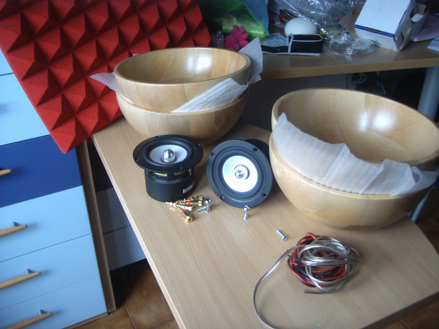

Ingredients ( fig. 2 ):
- 4 IKEA 28 cm ( 11 in. ) Blanda Matt Bowl
- 2 Tang Band W4-657SH full band speakers ( you can put others you like )
- 4 binding posts
- 6 drawer steel knobs
- damping material ( not mandatory )
- speaker wire

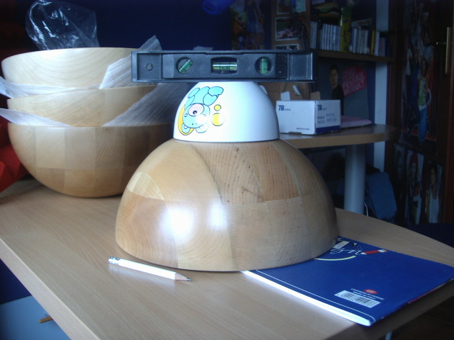

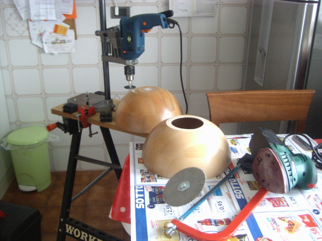

How to cut speaker hole
Just take a cup of the same diameter of your speakers and a bubble level: draw a circle with a pencil ( fig. 1 ).
To cut the bowl, I used a column drill ( quite cheap, as you can see … ) with a circular blade saw ( be careful to your fingers !!! ), then a file to enlarge the hole and a sander to smooth the support surface ( fig. 2 ).

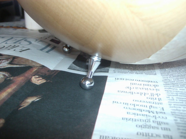

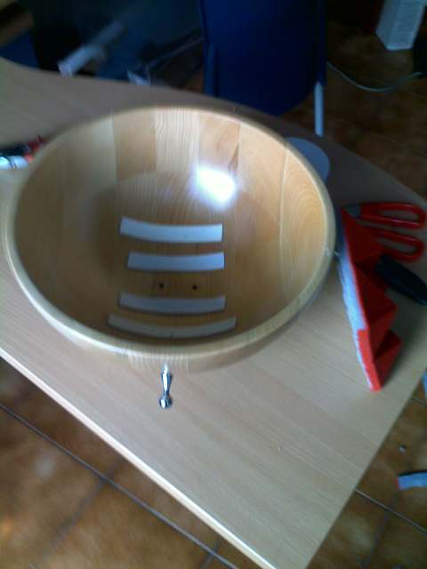

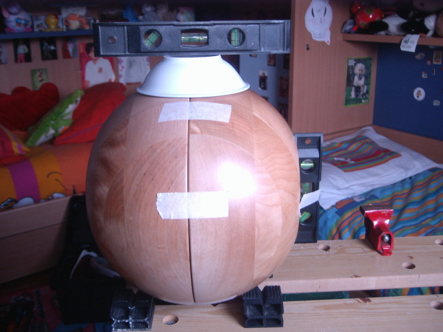

How to put support feet
Put togheter the two halves using paper tape, then using another cup and a bubble level ( better use a second one connected to the big hole to keep it vertical ), draw a circle where the 3 feet will lie ( not too large, otherwise the halves will touch the ground, and not too narrow, or the balance of the speaker will be unstable )( fig. 3 ).
In order to trim the tilt of the speaker, I put some washers to regulate the length of the feet ( fig. 4 ).
Before taking out the tape, draw some crossing lines on “north pole” and “south pole” of the halves, to be sure to put them in the same place as now during glueing.

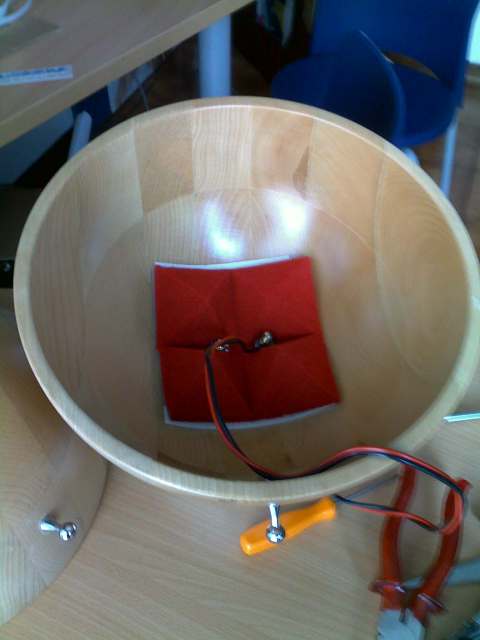

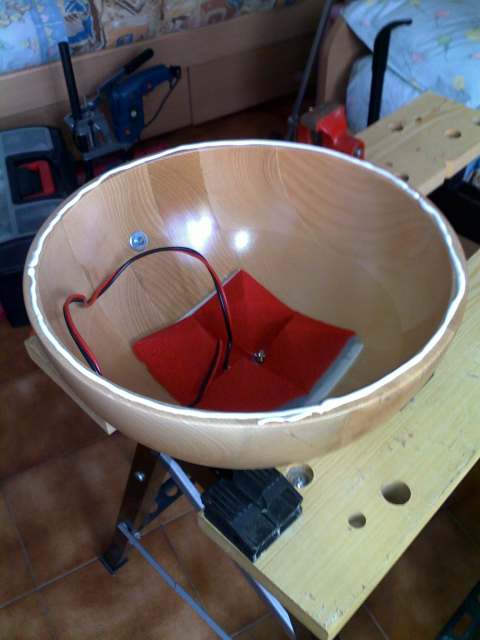

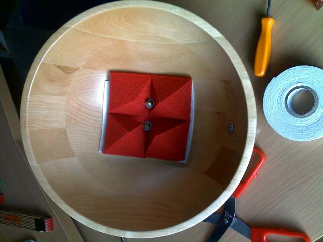

Binding posts, damping and wires
Damping material is kept in place by bi-adhesive strips and binding post washers ( fig. 1 and 2 ).
Then put the connectors and sold the cable ( fig. 3 ).

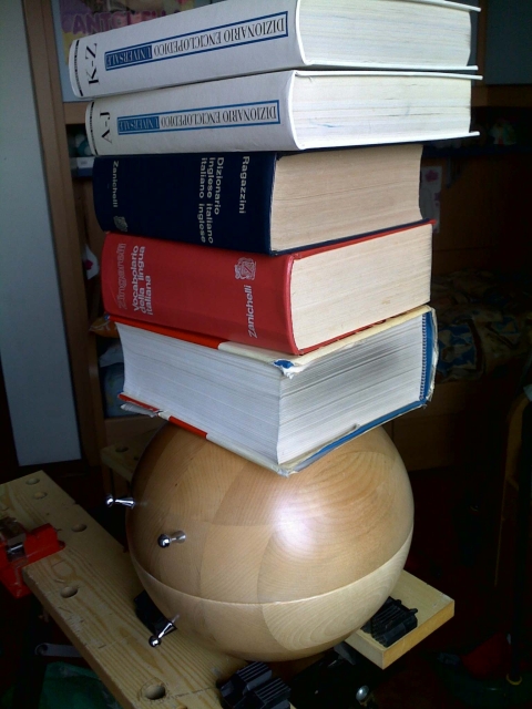

Glueing
If you’re going to paint the bowls, you can still make some test painting a small area in the inside. Why inside ? Because wood painting is not so easy and, unless you’re almost expert, the results are often mean. If this test doesn’t satisfy you, just keep the bowls in their original colour, as I did.
Put the glue on a bowl and, checking that the crossing lines you drew before are aligned, lay the second bowl, then put some weight and wait till next day ( fig. 4 and 5 ).
To be continued …
Glueing
To be continued …

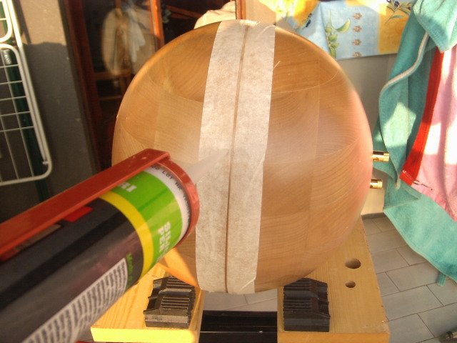

Sealing up
Sealing up with silicone is necessary, in order to avoid air leaks. Put some paper tape on the sides of the junction, then the silicone ( fig. 1 ). Press it using a wooden spatula or a sheet of paper folded 4 times, then let it rest for a day. Then you can take away the paper tape.

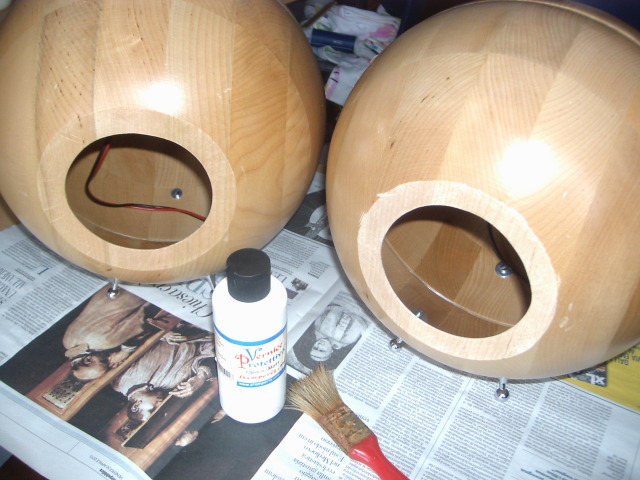

Now the border of the hole is of rough wood: I painted it using matt transparent paint for decoupage ( fig. 2 ).

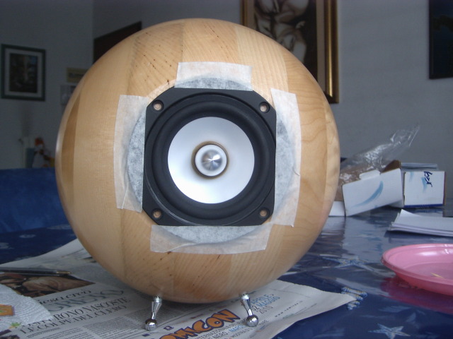

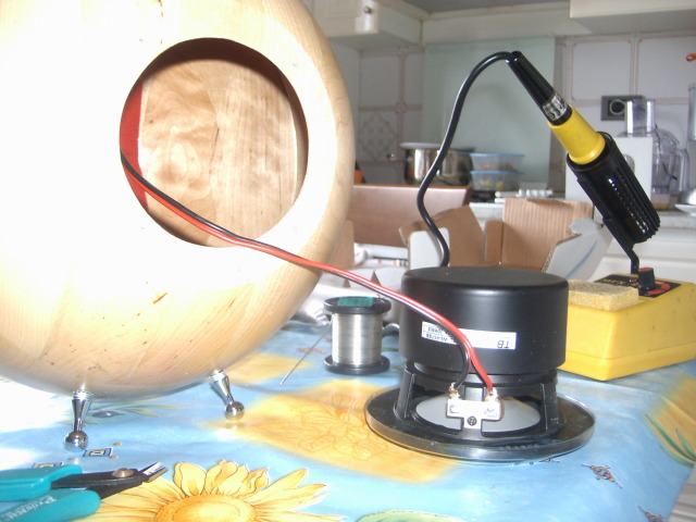

Screw holes

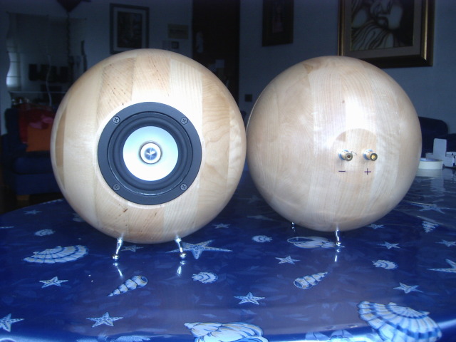

Put the speaker in place with paper tape, then mark the positions. Drill the holes, less than half of the width of the screws you’ll use ( fig. 3 ).
Now you can connect the wire to the speaker ( fig. 4 ) and screw this in its place ( fig. 5 ).

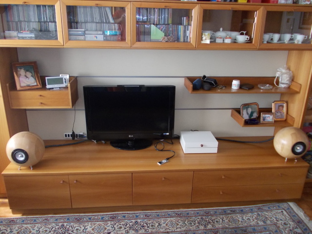

It’s done !
Ciao a tutti.
Luca
P.S.: thanks a lot to everyone for appreciating, or not ;-), and commenting.
P.P.S.: to improve the project, especially in high frequencies, you might use coaxial speakers, with their crossover filter outside the bowls ( or inside, if it fits ) and a bass reflex duct, for low frequencies, but please don’t ask me for calculation and position. Anyway I feel quite satisfied as such.
Screw holes
It’s done !
