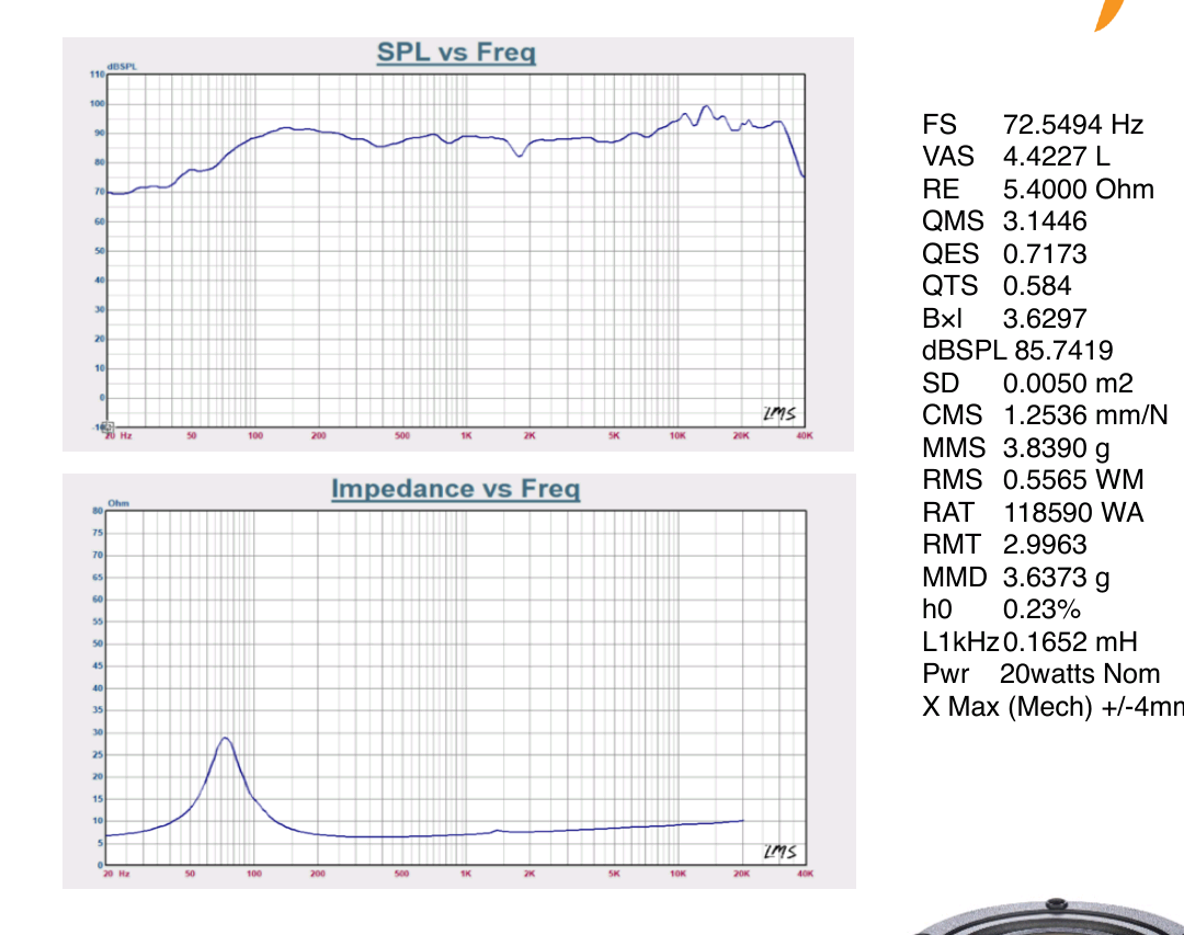

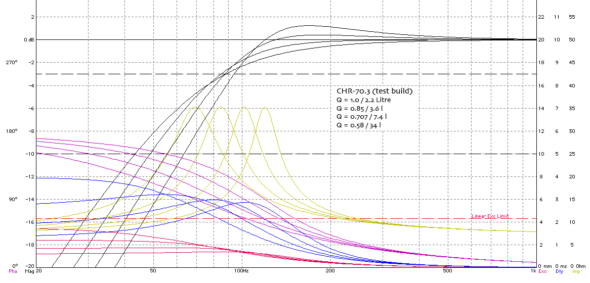

I use Markaudio CHR-70's in sealed boxes. F3 is probaby about 80Hz but that still sounds very very good near field, They are really great littile desk speakers at a great price. Highly recommended ... but you could spend more on something else if you must.

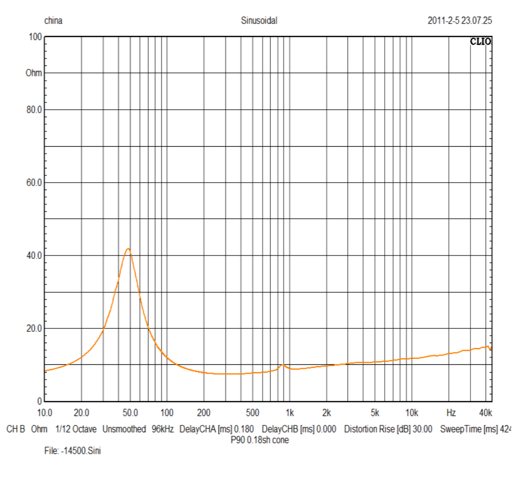

The CHP-90 is about as big as I would comfortably go for paper FR in a desktop format, I think. It's a good size for adequate bass. I went with 14L sealed, making it soft but extended. Others may be able to advise on how to achieve more oomph with other box options. HFs blend very nicely, though occasionally give me the impression that different parts of the cone are doing different things (lending credence to "EnAble" cone mods). While the Alpair 5 is absolutely tight in that regard and would hold up against a ceramic Accuton C50 (while playing 3 octaves more bass!).

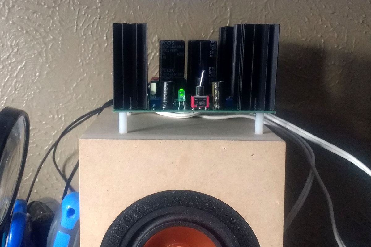

My palm-sized "100W" (laptop PSU powered) class-D does the job but it's an Achilles heel. What it really wants is a 5W class-A lead weight that's made for full range speakers. Maybe the Alpair 7MS could go one better, but see the impedance plots below:

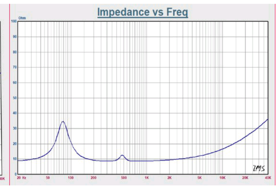

Alpair 7, climbs past 20 ohm @ 15 kHz, so a normal class AB or D amplifier may make it sound quite harsh above 10kHz, unless something drastic is done like adding resistance in series, e.g. 10 ohm. A more advanced hack that won't affect the bass could be a 220u - 1000uH air cored inductor, which will demodulate and de-emphasise the treble, and then use EQ to adjust the tonal balance.
CHP-90: at high frequencies it actually climbs a lot less despite being a bigger speaker.

Why? Something wrong with the amplifiers? That's a pretty minimal rise by most standards (the motors aren't full symmetric drive but they're not far off) & the reduced current draw in the HF, where it's already fairly minimal, generally makes for a featherweight load. I can't say I've ever had any issues with solid state, either A, AB or D, and I'm still [over] sensitive to HF hash. I normally run class D monoblocks myself. Narry the slightest issue, certainly no change in FR etc. relative to anything until you start shifting to high output impedance amplifiers, which will tend to follow the impedance curve & put more emphasis on rises from a nominal.Alpair 7, climbs past 20 ohm @ 15 kHz, so a normal class AB or D amplifier may make it sound quite harsh above 10kHz, unless something drastic is done like adding resistance in series, e.g. 10 ohm.
That's very drastic (!) unless you've a lot of power to burn & you're wanting to shift quite close to current-source territory. If you started with, say, a Pluvia 7HD, the biggest audible effect would be to kick effective Qts up from around 0.58 to about 1.25 & drop voltage sensitivity to roughly 78dB 1m/2.83v. I can't honestly say I've heard of any requirement like that -granted, I haven't been looking though.unless something drastic is done like adding resistance in series, e.g. 10 ohm.

Don't overthink this for a near field desktop. The CHR-70 sounds fabulous and is also inexpensive. A sealed box with no filtering, is all that is needed. It sounds top shelf yet the price is bargain basement. If you want more bass just stuff a little sub unde the desk at your feet. This speaker with an ACA Mini pumping some Nelson Pass class A bliss into it is as good as you will ever need for this application.
