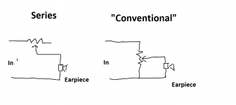

This might help you figure it out. The control will be wired either in series or conventionally as shown here. For stereo you would double up on the circuit. So that three or four wires entering (there can be one common connection shared between the two channels)
For mono the two earpieces may just be series wired and connected to either arrangement of control.

ncoma... those pictures seem to show its an inline series control. Only four of the 6 pins on the control seem to be used. Where is the wire to the left hand earpiece or is that soldered directly to the PCB.
Does each earpiece/speaker unit have just two wires going to it ? If so then what you need to do is take the - or negative terminal on each earpiece (as long as you use the same for both it doesn't really matter actually) and connect them together. That is then the "common" or ground.

There would be a corresponding contact patch on the earpiece for the left side earpiece, that mate with the open pads (I assume).
To bypass the volume use a short piece of wire on the pot pins. Counting down from the top of your picture, that would mean connect Pad 1 to 3 and 4 to 6.
