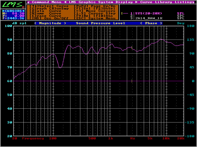

The floor bounce is real. I picked this up while I was designing a 2-way with Zaph's ZA14W08. Speaker was on a 30" stand.
The cancellation doesn't show up in near field measurements. However, when the mic was placed 1 meter away, an in-room 20-20K ungated sweep registered a deep notch at approx 150Hz.
That's one reason why mid-bass is missing sometimes.
More measurements can be found at SWIFT
