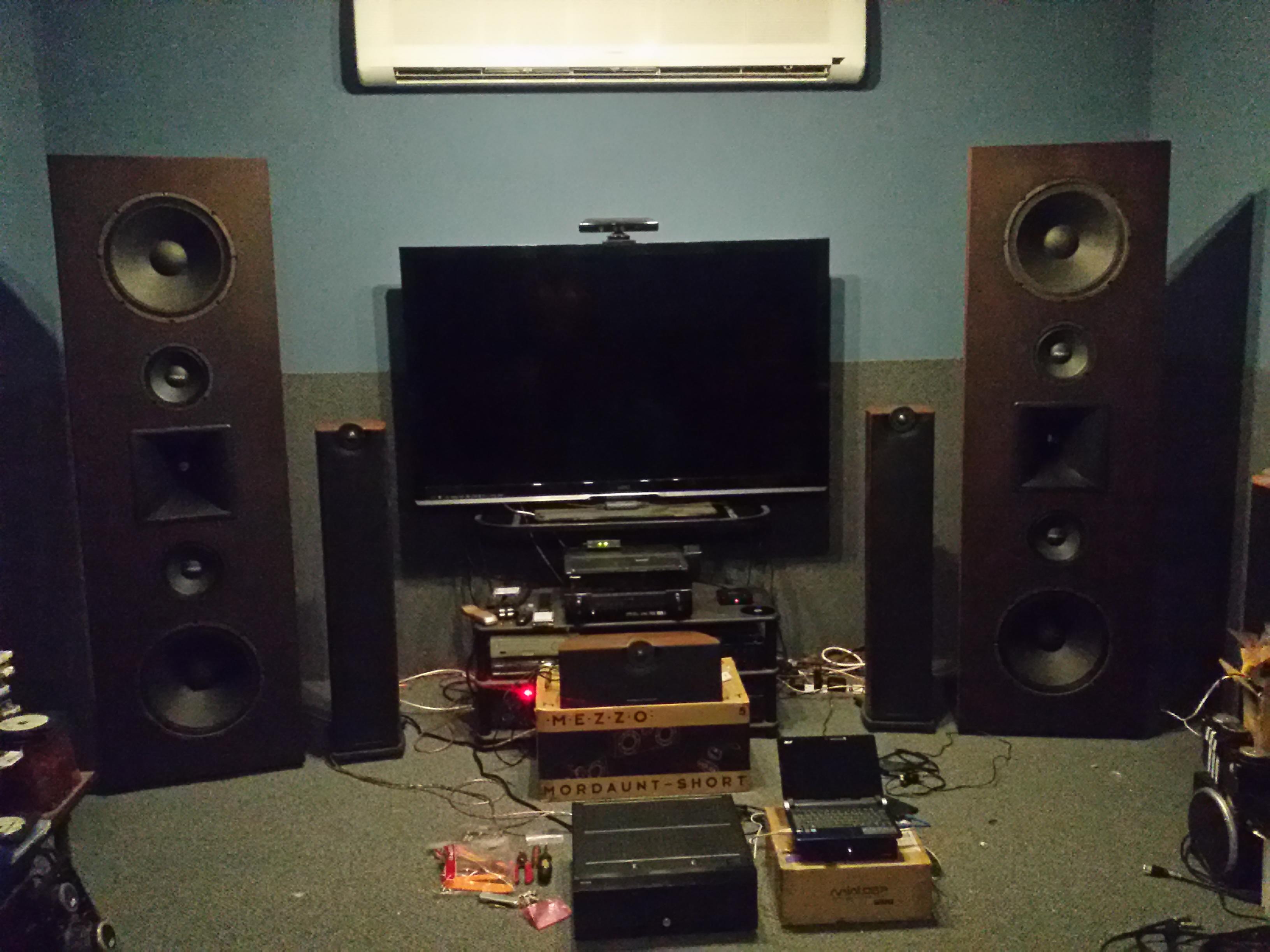

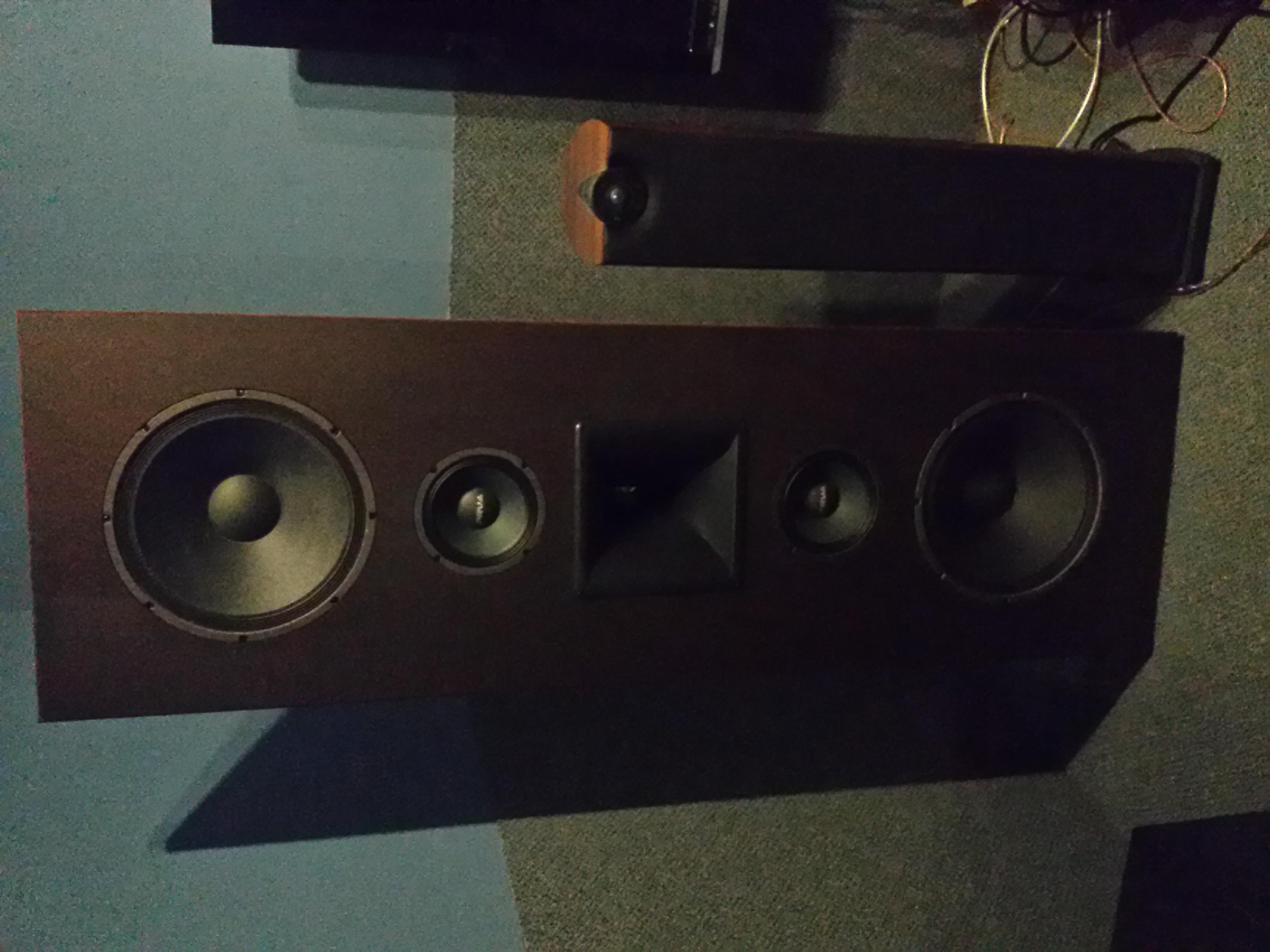

Okay... here is the whole story to discard many variables here. I already made my speakers but I am having trouble with the horns I chose for them.. I am using a miniDSP OpernDRC DA8 unit and a multichannel amp. the woofers are 2 Eminence Alpha 15A, 2 PRV 8" Midbass units and the horn is a Pyle PH12s Constant tirectivity horn with a Selenium D220Ti compression driver attached. I need to change that horn because it overpowers the rest and sounds way too in my face, even at 15 feet or more..Clearly it depends on your further (unstated) requirements:

Sorry... I am using REW and rePhase to create xover, eq, phase correction and balancing the drivers. different measurements were taken from each driver near field, individually and also as a system at 1 meter and at listening position.. from those readings then a FIR correction was created for each channel(LOWS, MIDS, HIGHS). Although it seems balanced on graphs, it feels too forward. Someone told me that the problem was that the horn was a Long throw type and that it was for outdoors, and that I needed a waveguide instead or a short Throw CD horn that could be more suitable for a room..

...I am having trouble with the horns I chose for them...I need to change that horn because it overpowers the rest and sounds way too in my face, even at 15 feet or more..
It sounds like the K510 or the K-402 will solve that problem easily. They are both 90x60 horns that have excellent polar control vs. frequency, and I've never had an issue with too narrow of a polar coverage, thus resulting in a "overpowering" sound.

What I meant by long or short throw is the fact that the Pyle has a depth of 9-5/8", while the others that You, EarlK, has recommended are only 5.5" deep. So basically I believe You just answered that part of my question about that. and I thank You as well as the others who have contributed with their opinion/ advice so far..Well, generally I would classify a waveguide as a short Throw CD horn ( & that small Pyle as short-throw ).http://www.parts-express.com/denovo...olt-matte-with-1-3-8-18-tpi-adapter--300-7070
