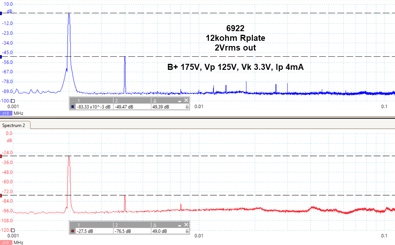

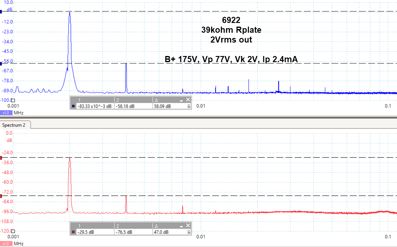

Just did this measurement yesterday...12kohm and 39kohm plate resistors:
Edit: btw this is not optimum working condition for this tube but rather demonstrates the distortion at two different plate loads.
Yes, notice that with the larger plate resistor, the distortion is about 10dB less.
The mechanism is simple. The anode resistance is nonlinear, but not the plate resistor.
So the larger the plate resistor is (compared to the anode resistance), the less effect
the nonlinear anode resistance has on the distortion. Of course, the cathode resistor
will also help with linearization, especially for smaller signals.

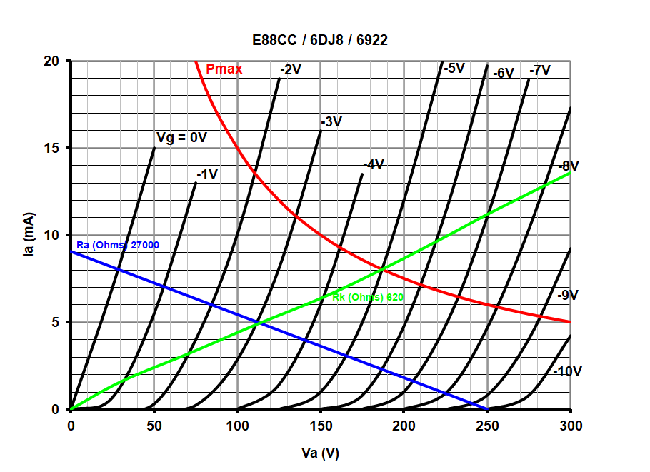

@emartine:
You might want to play with Merlin's Load Line Plotter spreadsheet. It has curves for the E88CC/6DJ8/6922 tube. You can download it from this page:
The Valve Wizard
You could start with the following parameters and experiment from there:
Vsupply = 250
Ra = 27000
Rk = 1000
This will give an operating point that is near center bias and well below the tube's dissipation limits.

Yes. Thanks. That is what I was using. but the Excel spreadsheet from ValveWizard (I just found out) seems really great!

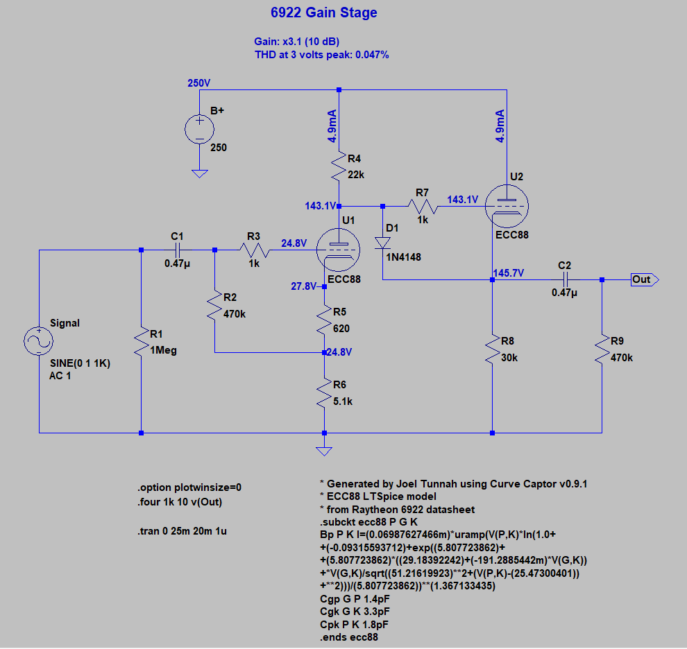

Its for a preamp. It would be the only stage just before a cathode follower..
There has been a lot of good theoretical information provided here. How about a practical circuit?
Assuming that you are looking for a line amp with modest gain, attached is an example LTspice file that uses the 6922 in a single gain stage with a direct-coupled cathode follower. The gain is about x3, achieved with cathode degeneration in the first stage. This does increase the output impedance of that stage but this is mitigated by the cathode follower, which has a low output impedance roughly equal to the reciprocal of the transconductance of the 6922 (less than 100 ohms).
The operating point of the gain stage is depicted in the screen shot of Merlin's Load Line Plotter spreadsheet.
Maybe this will give you a place to start.
