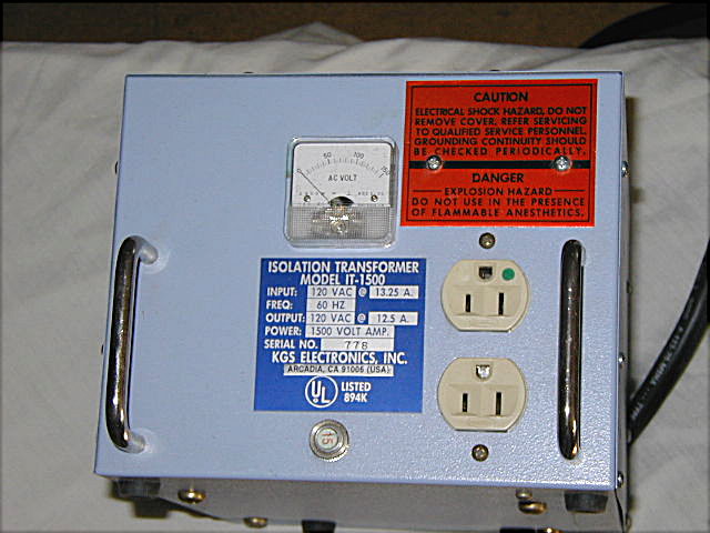

I have a 12.5 amp 1500 VA EI core isolation transformer. Is this large enough to be of value? My understanding is that an EI transformer forms a low pass filter and so gets rid of lots of the RF "junk" that is riding on the incoming AC.
Should I try it?
Also, what happens if there is a sudden interruption to the AC service to my home? Will the transformer's magnetic field unload and send a dangerous spike to my attached electronics? If I use it should I include a husky MOV across its output?
Should I try it?
