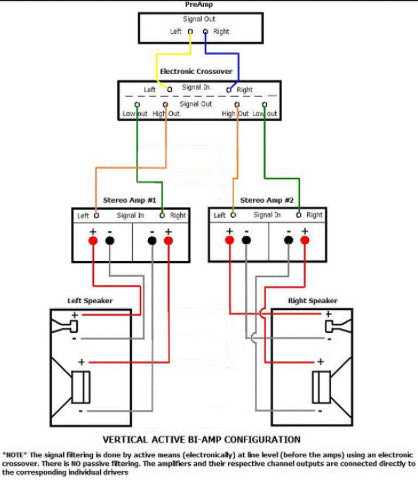

The dbx manual does not provide a diagram/drawing of how to connect a preamp/amplifier to dbx 234 crossover. I can't find a video in English that shows how to connect. Please help.
I'm attempting to connect 2-way speakers to an active crossover to a McIntosh MC2205 and a preamp.
Do I Connect the preamp outputs to the amplifier, the speaker outputs are connected to the crossover inputs, then the mid/high outputs and low/mid outputs are connected to their respective drivers on the speakers?

An active crossover goes before the power amplifier(s). It works at line level, not speaker level.
You need more than one stereo amplifier to use an active crossover. See fig. 2.3 here:

That's more or less the right way. Observe all polarities.
But you only have two amplifier channels (one stereo amp).
You need a total of four amplifier channels (two stereo amps) for a pair of two way speakers.
You need one stereo amplifier for the two woofers,
and another stereo amplifier for the two tweeters.
The two amplifiers can be the same, or different, depending on the details.
Often a lower power stereo amplifier is used for the tweeters.

Thank you, Rayma.
I have two of the same amps. I'll try this.
