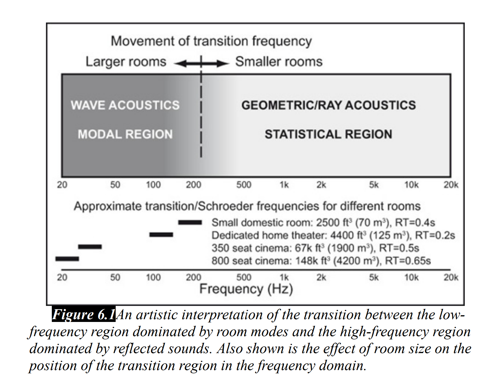

However, I don't like the idea of the boundary reinforcement below 100Hz built into the two D&D main channels. That's a waste of drivers because you're in the room's modal region. But what's valuable about boundary reinforcement is that you can separate the low frequency drivers from your main channels and place them in the room corners. Not just lower cost but better performance as well.
And in practice you'd do it above 100Hz, up to your room's transition frequency, which saves even more money in your mains. If you try to specifically draw sub-transition frequencies out of your main channels you kill yourself in both performance and cost. In turn, that helps you with your cardioid low-mid performance because they don't have to work all the way down to 100Hz.
