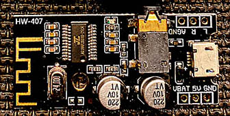

I bought this Board with Bluetooth 5.0:
which works great but unfortunately it is always possible to connect devices even when the 3.5mm Aux is connected.
Is ist somehow possible to disable Bluetooth (preferable temporary by switch
disconnecting antenna or something)
The Bluetooth Chip is an "JL" AS20BP00966-25A4 "JL" stands for ZhuHai JieLi Technology Co (珠海市杰理科技股份有限公司-珠海市杰理科技股份有限公司|杰理芯片)
the chips is likely either an AC6905A or AC69025C (most likely last one because of BT5.0)
the chips would have the following pinouts:

I've removed all the components around the BT ant (caps/inductors) and it still broadcasts the BT name. Tried removing the crystal (replaced all the other components), and it no longer broadcasts the BT name, but it also looks like it disables the entire amp. I need to do some more testing in this state.
Tried bringing those pins 14/15 to GRD, but made no difference.
I wish there was some more info on these BT chips.

I'm having the same problem. Ive even cut the pcb traces to the antenna in 2 places and removed a capacitor. its still somehow working.
I literally removed everything i could except the essential required components to run the bluetooth chip. How is it still able to send and recieve a signal without any wires??
Whats the point of the antenna if its completely unneccessary?
The only thing left is the crystal and some essential other components to run the bluetooth module. I really want to bypass it completely somehow.

The crystal is required for the chip to operate
replacing it disabling it causes the amplifier to no longer work.
I'm not sure which pin is which. my chip might have a slightly different layout.
Only thing I could think of maybe at this point would be putting a couple layers of tape over the chip. then sticking a sheet of foil over the entire chip area. and taping the foil down. and doing the same on the underside.
Maybe a couple layers of aluminum foil would be enough to kill the signal?

I have this BT receiver board.
Maybe TPA3116D2 uses AS20BP00966-25A4 pin18(MUTE) output for muting noise. If do not mute, this chip makes noise during the track transition.
Normally this pin18 is 0V but goes 3.3V when muting active. Thus means power down the AS20BP00966-25A4 then TPAS3116d2 mute will be released. (May be, Not sure...)
