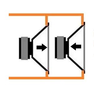

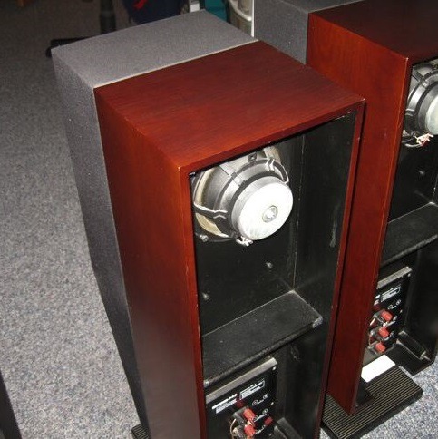

I had a read through other threads and I noticed some drivers seemed to get additional treatments. For example a sort of triangle shape across the entire cone. Can you comment on this please? I'm guessing it's driver-specific, but how do I work out if the driver needs it?
And a completely unrelated question, if I may - can the back of the cone benefit from the treatment as well? The reason I'm asking is I have a set of peculiar speakers where one the drivers is firing into the chamber as well as to the rear.
