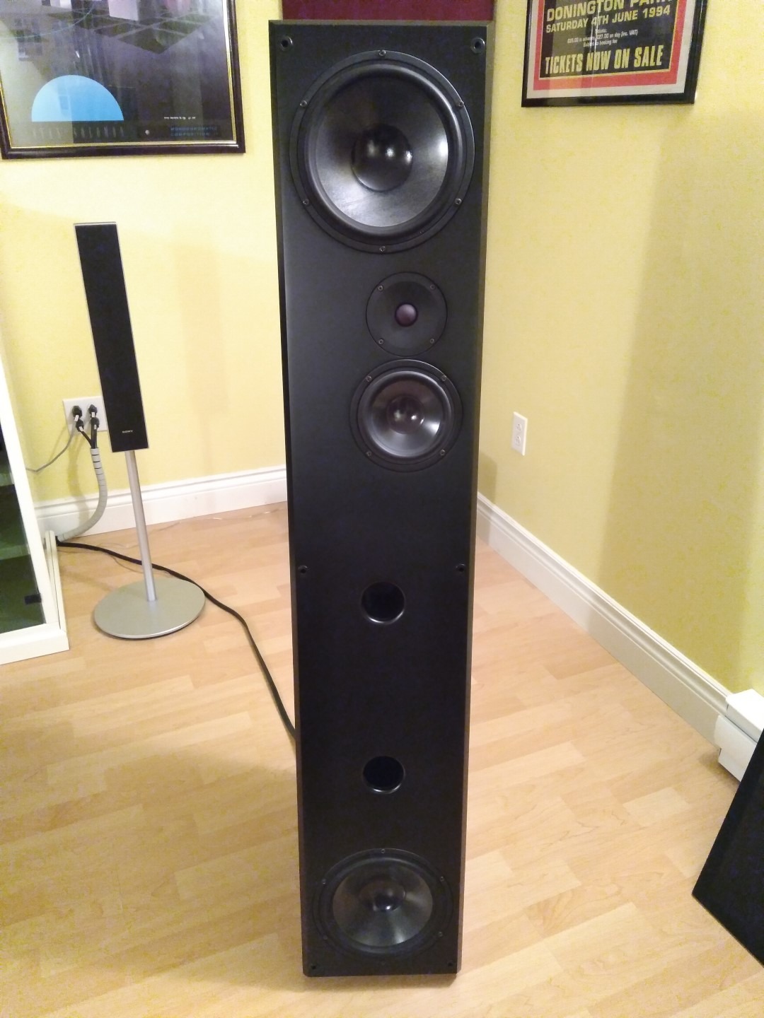

I have very basic knowledge of electronics, but 25 years ago, I built my hi-end speakers from a well know company who published their own kits.
The speakers are 3.5 ways: 2 woofers + 1midrange + 1 tweeter ( 2 x front ported)
The cabinet was very difficult to make, in fact, I was helped by a wood craftsman, and the speakers were lacquered.

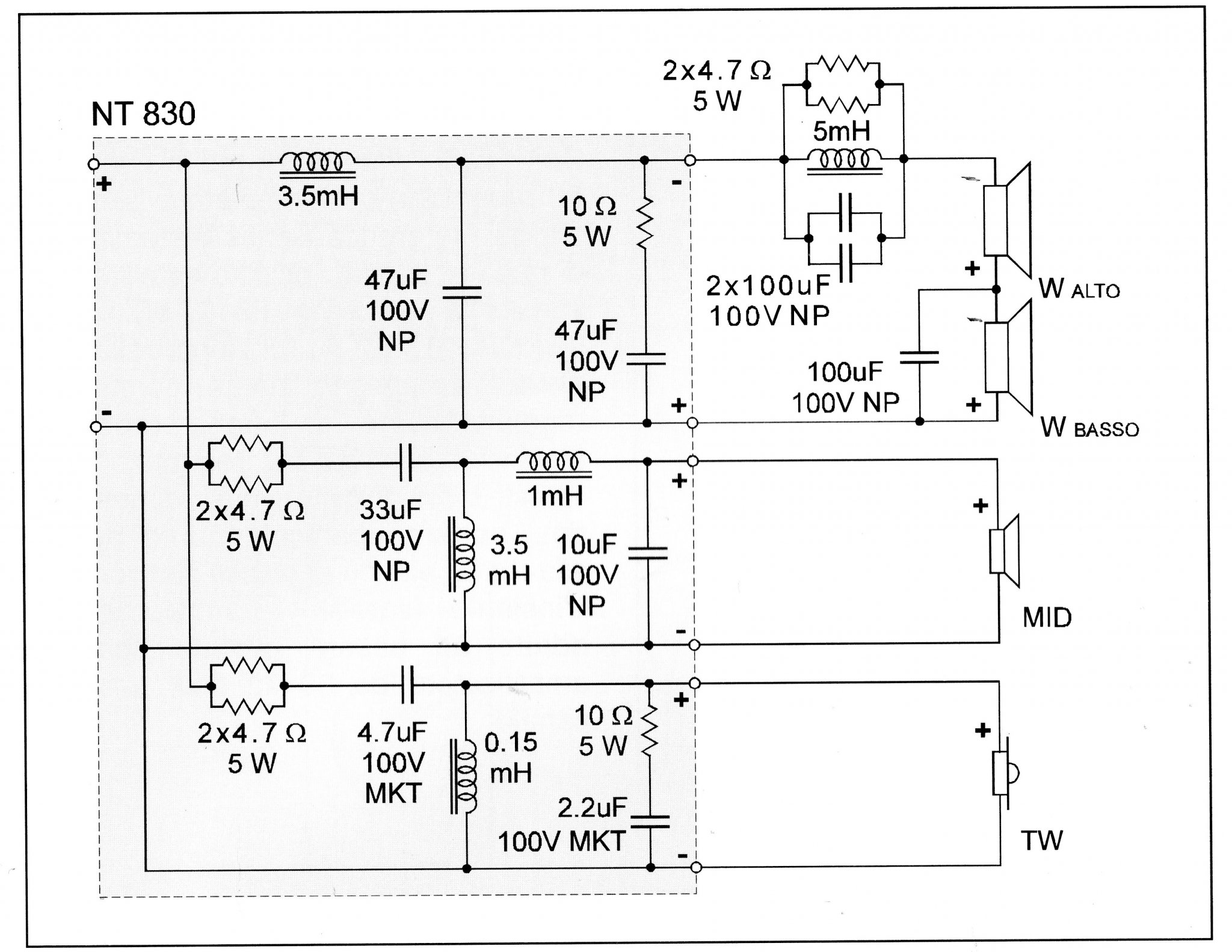

The company who supplied me with all the components, suggested to make a different (and more elaborated) crossover, compared to the one proposed in the original project.
Image is attached.
When I listened to the speakers the first time, I soon realized that the high frequencies were too bright, and therefore they suggested to change the value of the resistor on the tweeter from 1.0 to 1.8 Ohm.
That worked fine.
However, since then many things changed in my gear, I also moved to a new home and I have a much bigger room.
As a result, I find the need to apply a further cut to the high frequencies, and wanted to ask you if the way I should do this is the same, (increasing the value of the resistor).
If that is the case, which value should I use for the new resistor?
Thank you!

i can't help with your request but I'd be really interested to see the speakers that you built they sound interesting
Note that doubling the resistor halves the drive level which is -3dB in sound level, which is just about discernable.
So in your tests it's most efficient to double the resistor value, then if the sound is still to bright, double again, etc. Once you get in the ballpark you can backtrack a bit to finetune.

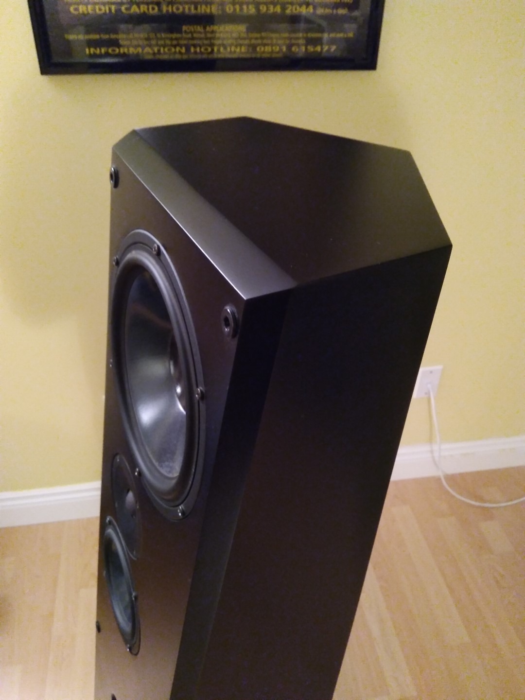

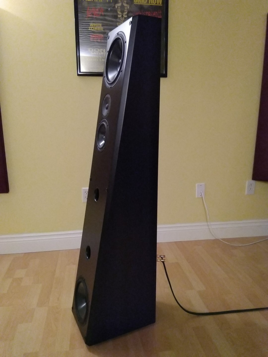

I have attached some images, so to give you a good idea 🙂i can't help with your request but I'd be really interested to see the speakers that you built they sound interesting

For convenience, I attach an image of the original crossover.
My question to you is the following:
Is there a way to know what would is the nominal impedance of my speakers, with the customized crossover I have?

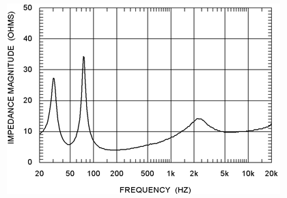

The impedance of the individual drivers, and of your loudspeaker system as a whole, varies widely with frequency.
The nominal impedance figure usually represents the impedance of the complete loudspeaker system somewhere in the region of 400 Hz, but the impedance will be found to be different at different frequencies.
You have nothing to worry about here.

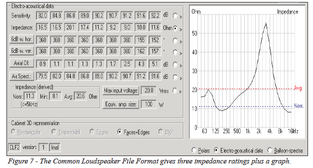

Here's an illustration of how a speaker system's impedance can vary with frequency.
The impedance is 6 ohm around 500 Hz and that could be described as the nominal value.
To be more technically accurate:
"According to IEC-268-5 the nominal impedance is found by multiplying the minima of the curve (within the pass band of the loudspeaker) by 1.25. Said another way, the minima of the loudspeaker impedance shall not be less than 80 percent of its nominal value."
https://www.prosoundtraining.com/2010/03/17/which-impedance-nominal-minimum-maximum-average/

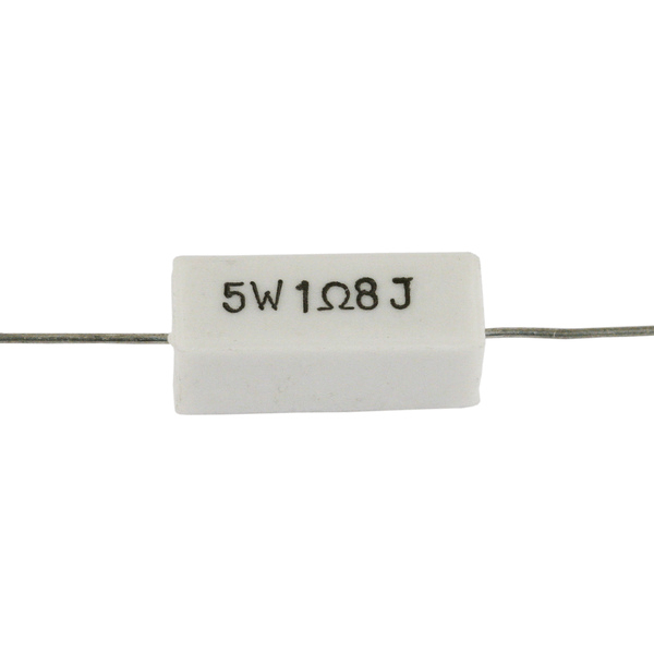

Any specific type of resistor is recommended here?
I wonder what type the present 1.8 ohm resistor is?
I suggest at least a 5 W rating for a tweeter.
I would use a ceramic (wire wound) resistor, but there are other types that some say "sound" better.

This is the Digi-Key page you are looking for: https://www.digikey.ca/en/products/...AIA8gAsAtpgMzGyQIACq-LwsXsgAstiomACu3NiiIiJAA
LOL so I can only choose among the first three as all the others have zero stock 🙂
Although you selected wirewound, the third one down seems ceramic from the image.🙄
