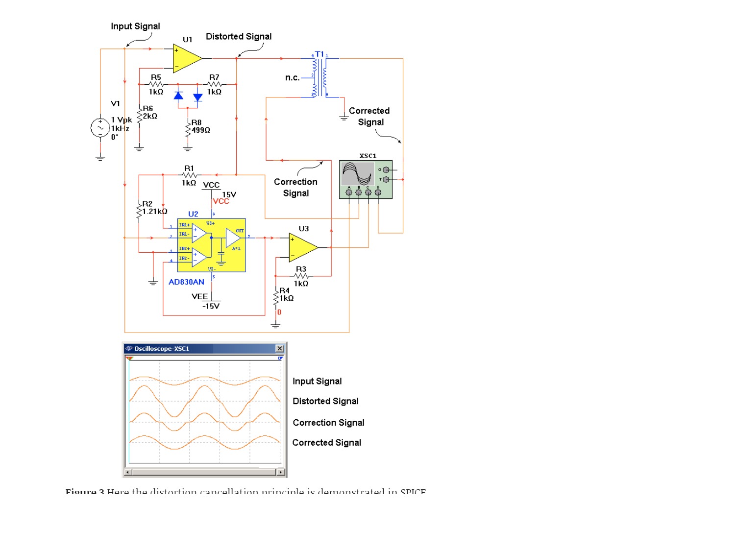

How do I couple the output of an op-amp to the high-power output of an output buffer?
Here they doing it with a Transformer:
In the Benchmark AHB2, they do it via an RC network, but the patent doesn’t explain it—of course not.
https://patentimages.storage.googleapis.com/87/3b/ca/b85fd90cbe2d2d/US8421531.pdf
Thanks in advanced!
Looks like this is feedforward to reduce harmonic distortion, and has little to do with noise cancellation. Noise cancellation, since noise is a stochastic process, will gain you a whopping 3dB improvement in S/N ratio.

Alright, let’s cut the noise (pun intended) and actually solve the problem instead of getting lost in definitions.
Restating the question for those who got sidetracked:
I need to couple a low-level signal from an op-amp to the high-power output of a power amplifier. The signal is a pre-inverted version thats made by the subtraction of the amplified signal and the reference signal. It will have some amount of the following components:1️⃣Amplifier-Induced Distortions

I am NOT asking for:
- A lecture on whether "negative noise" is a thing. I already explained what I mean.
- Discussions on whether noise is stochastic, deterministic, or generated by fairies in a vacuum.
- Explanations on why feedback-based cancellation exists—yes, I know, and I don’t want to use it.
What I need:
- Can I use capacitive coupling to inject this inverted signal into the high-power output?
- If yes, what capacitor values and voltage ratings should I consider for a system running at 100W into 8Ω?
- If capacitive coupling isn’t ideal, what alternative methods (inductive coupling, resistive networks, transformers) are best suited for this kind of injection?
If you just want to argue terminology or talk about patents without explaining how they achieve it, kindly start a new thread instead of derailing this one.
Thanks in advance to anyone who provides actual technical guidance.
For excellent articles on feedforward error correction, Giovanni Stochino in Linear Audio V8 and V9 (September 2014 and April 2015) first discusses ideal topologies, and then reports results from a 200W power amp that has 5ppm harmonic distortion and 1ppm intermodulation distortion at full power from 20Hz to 20kHz.
