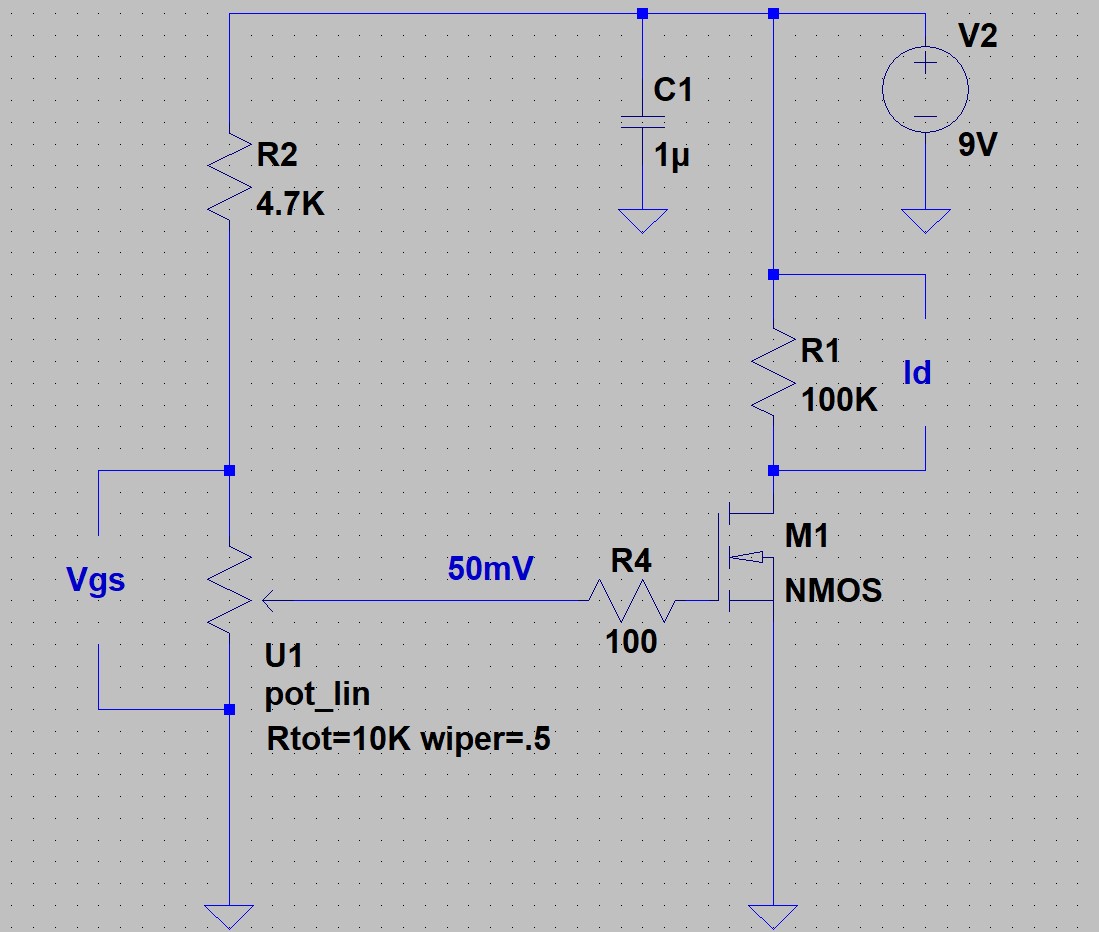

A friend of mine asks me if it is possible to measure the MOSFETs in order to get them matched, like we use to do with the Bipolar transistors. And of course, HOW to proceed...
The MOSFETs that he would like to get matched are the IRFP140N.

Here's a simple setup I use for static test: connect an amp meter to Id, a volt meter to Vgs, turn U1 to your target drain current (Id), and read the volts required (Vgs).
The MOSFet may need a heatsink, and you may need to wait until thermal equilibrium is reached.
Edit
The pic shows a NMOSFet. Reverse polarity for PMOS.

You could connect the gate to the drain, connect a current meter in series, put two of those circuits in parallel and force a current through the whole thing. If the two meters show nearly the same current (half the total current), they are well matched.
Using this method, when the total current is relatively small, you mainly check threshold voltage matching, when it is large (don't forget to cool the MOSFETs then), mainly beta matching.

Thank you very much for your detailed explanation and the schematiks !
I believe I should build a PCB with 3 appropriate connectors, in order to simplify the measurement of the Mosfets (and switch from a mosfet to another)...
