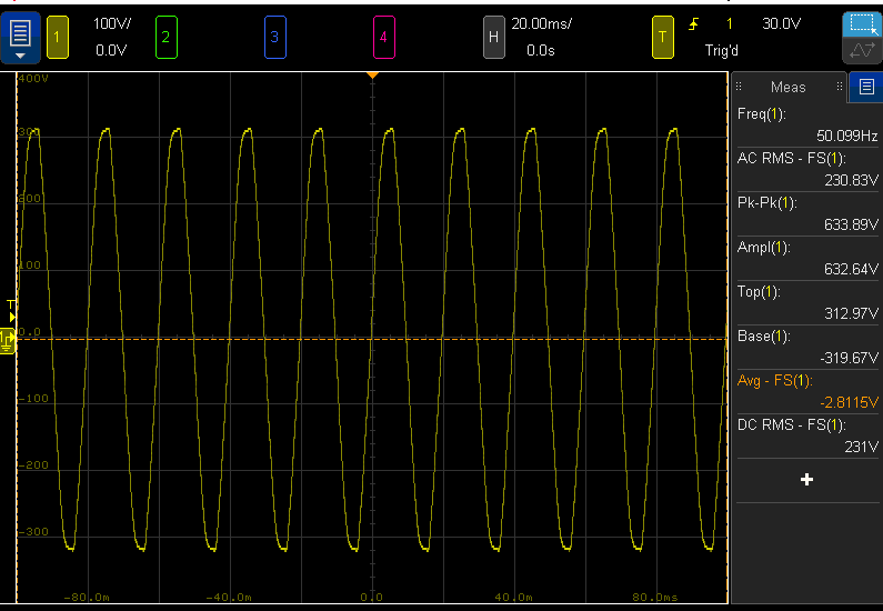

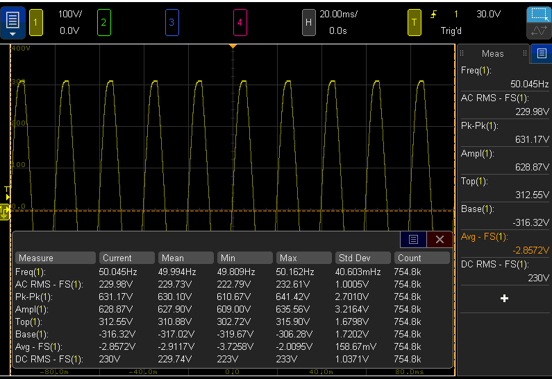

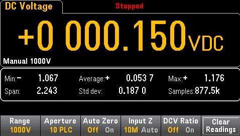

I have a problem with a transformer that is humming quite loud now and then. Out of curiosity I started logging the voltage with a multimeter and an oscilloscope. I logged the voltage for 48 hours. The problem is that the results from the meter and oscilloscope are quite different. The multimeter says that the DC voltage has been between -1,067 V and +1,176 V, the oscilloscope says the average voltage has been between -3,7258 V and -2,0095 V.
First, I am not quite sure how to measure the DC component with an oscilloscope. Most instructions on the internet for measuring DC component on the AC line are done with a multimeter. I did some basic test with a signal generator and the oscilloscope; I had a symmetrical sine wave where I adjusted the DC component and the AVG measurement at the oscilloscope gave me the correct DC voltage. I have assumed that is correct to use the AVG measurement. Unfortunately, my mains voltage isn’t very symmetrical, it is quite distorted.

- Is it correct to use the oscilloscope’s AVG measurement to read the DC component?
- Are there other methods that are better than using the AVG measurement?
- Why are the results from the multimeter and oscilloscope (very) different?

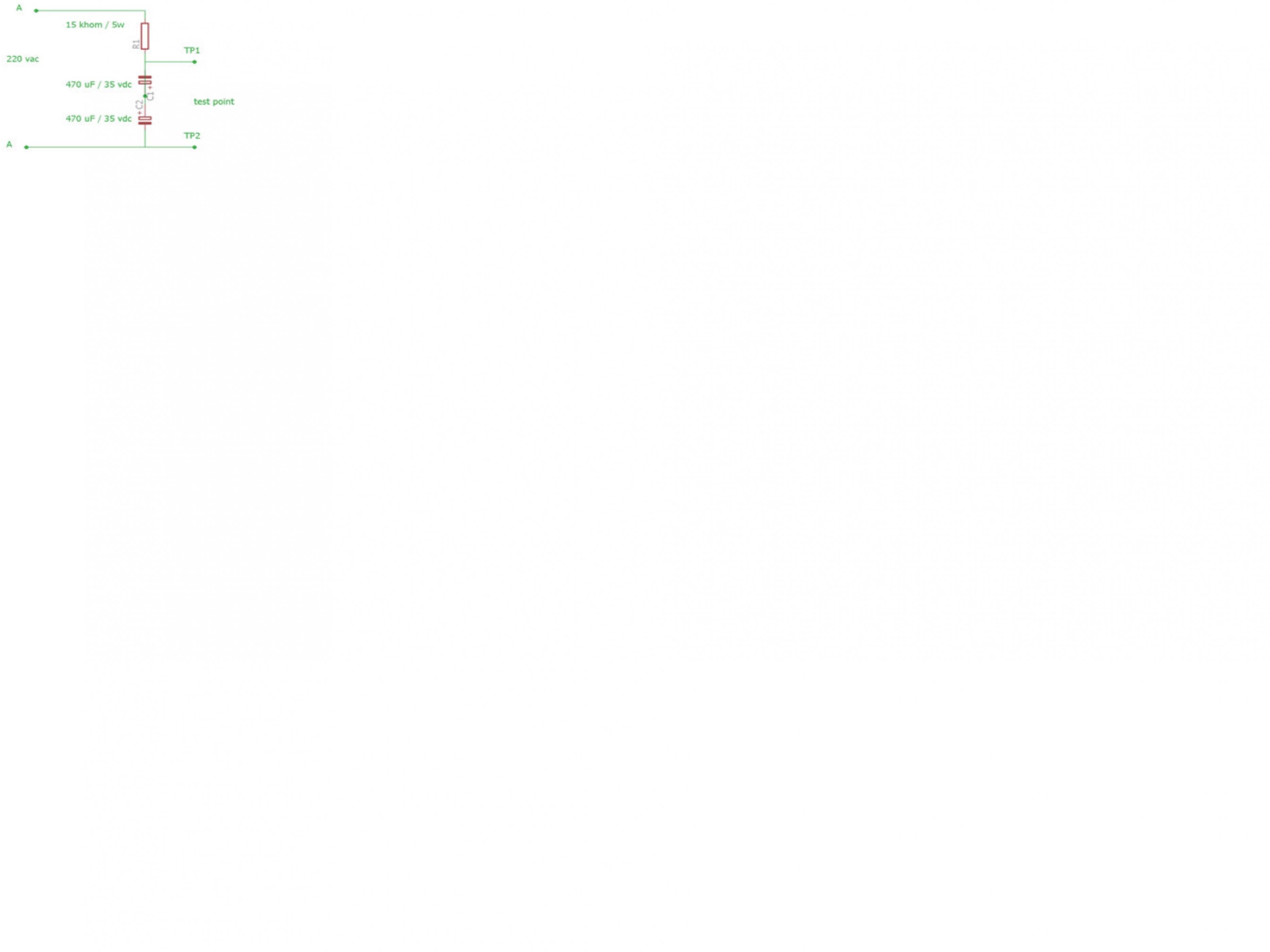

The oscilloscope is not needed/not suitable for measuring small DC on the mains.
A multimeter preceded by a LP filter is more accurate and much safer, example here:
How to measure DC offset on the mains voltage?
