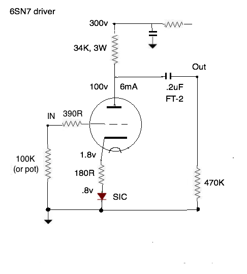

Several people have stated in posts that they prefer the E80CC to the 12AU7. This would be one of my tubes of choice, and I find it sounds better than 6N1P or ECC88 for instance. It's more expensive but not stupidly so. I prefer the Tungsram version with nickel pins to the Philips version with gold pins. It will require a higher value anode resistor since the Ri is 10K as opposed to the roughly 7.5K of the 12AU7. It also has a heater current of 600mA instead of 300mA so the heater specs need to be checked. Mu is 27.
For higher gain my choice after trying several alternatives would be the E180CC. Heater current 400mA, Ri=7.5K so that's the same, though the operating point would be different. Both tubes have the same pinout as the 12AU7.
I personally don't like or use active loads - I prefer a simple resistor load. For a B+ of 300v you are looking at around 4 to 6mA through the tube to get a sensible value anode resistor of 27K to 34K. You can use a cathode bypass cap but another trick which makes life easier is a SIC diode in the cathode which gives you 0.8v to add to the bias. I use a single diode to ground with a resistor on top of it of 180 ohms which gives a bias of around 1.7v or 1.8v. So no cathode bypass cap. A single SIC diode seems relatively smooth with an added resistor, though I find SIC diodes are prone to a slight edge without a resistor and sound better with some tubes than others.
Attached a circuit which I use, and I use this same circuit for 6SN7, E80CC and E180CC tubes. So I have the possibility of mu=20 for 6SN7 up to mu=46 for the E180CC. Sound is pretty good to my ears, and it drives my 2a3 outputs in a 2 stage SE.
This is just one way of doing it but it may interest you in your experiments. I also like the concept of a modular build where you can drop in different alternatives, and I found this circuit to work with each of the three alternatives above plus various 6J5 types which can sound very nice, in addition to 7N7 and 7A4. So I have a few different socket types wired together which all use the same circuit.

I agree with everything Andy has said about the sound quality of the various tubes he mentioned. I've used the E80CC as driver in a PP 2a3 amp and the E180CC ( or its equivalent the 5965) in a preamp ( I also dislike active loads with transistors as they affect the naturalness of the sound of instruments compared to resistors).
I'd like to add a few more good sounding tubes here. Instead of the E88CC use the 6BQ7 6BK7 and ECC85 which have the same pin out. Only as cascode the E88CC sounds all right but not as a single triode. The ECC 40 (mu=33) is very good too but has an 8 pin socket unfortunately. Then the 6211A (mu=27 like the E80CC) and also the little used ECC 84 (mu=24) only this tube has a different pin out
I once made a simple test apparatus to compare the gains of double triodes which can also be used as a line or driver stage. The reason was that there is no 100% correlation between gain and emission. It can also be used to judge the sound quality of tubes.
It consists of a chassis with 9-pin 7-pin sockets one anode resistor (100k) and one cathode resistor (1k) plus 220mu Ck. The 100k goes to the switch with 12 contacts where all the anodes go to. All cathodes are connected. So are the grids with one Rg= 470k. A 1: 10 resistor divider is placed over the 6.3v (10k and 90k in series) resulting in about 0.6v ac. which goes to the grids. Connect your dvm with an output C of 0.1 muf apply the hv (200v or more) switch from one anode to the other and you know the gain in that particular situation. Of course it's relative but it's very useful especially in stereo amps without nfb. I hope you can do something with this efm 7.
