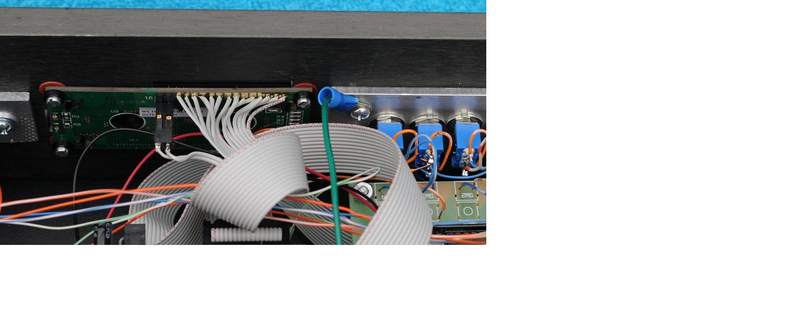

Mounting an LED/LCD display on a 10mm front panel is easy and looks pretty. I used Front Panel Express to install tapped blind holes on my Aleph P, and the project turned out very well. The first photo shows the mounted LED display in a HiFi2000 Slimline chassis. You are welcome to my FPE design file, if that would help.

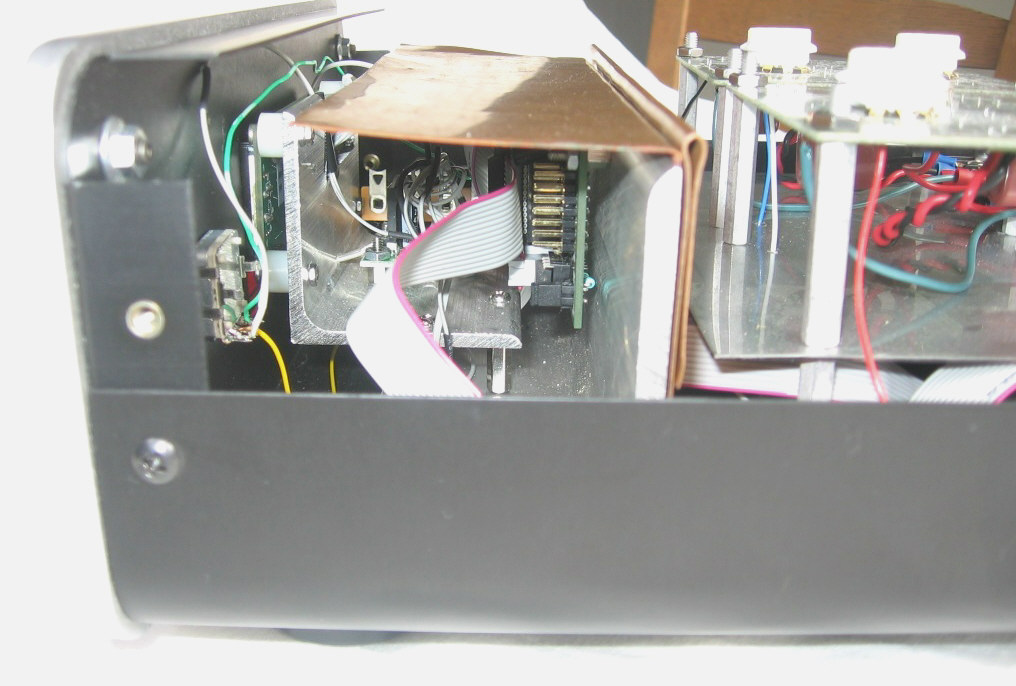

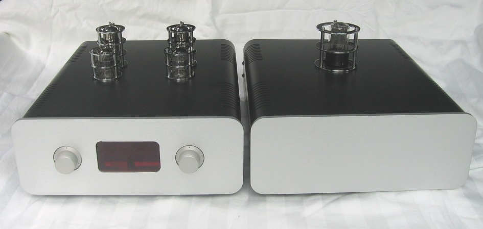

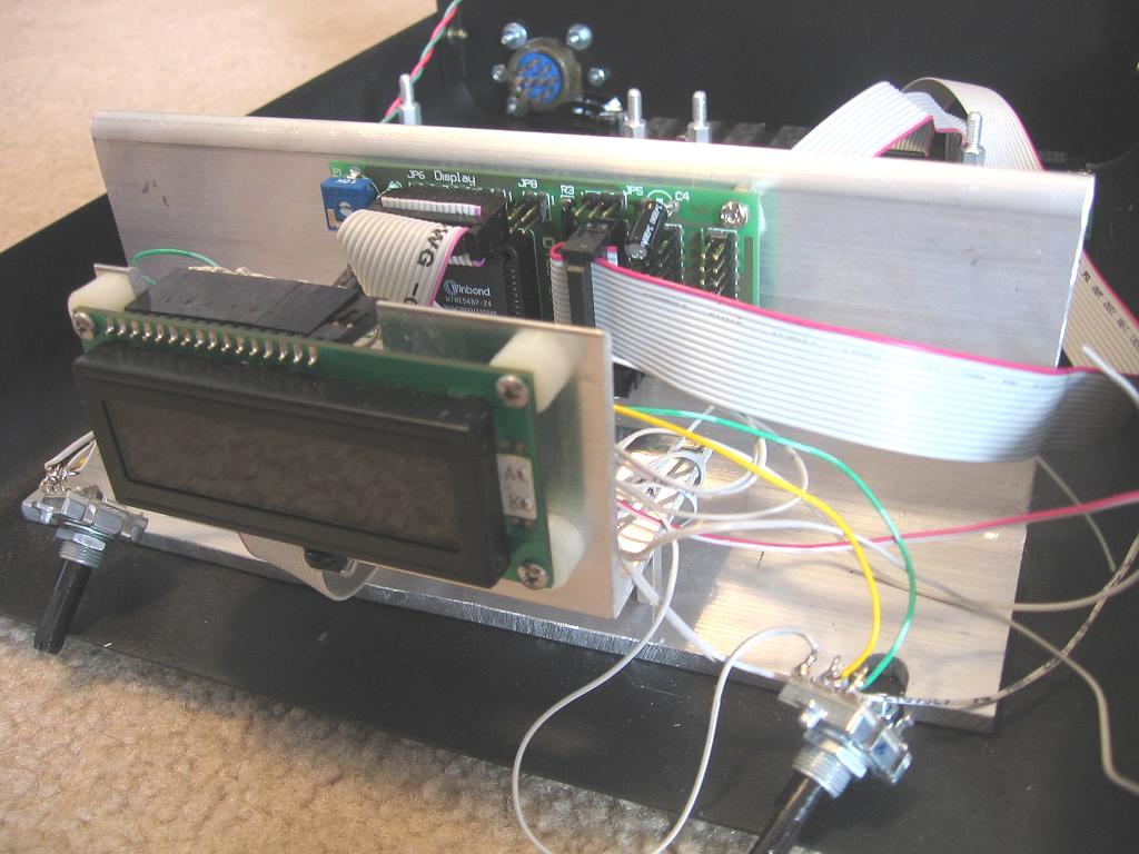

My Aikido preamp was built using ATI Research enclosures, which included 6mm front panels. Instead of mounting the display to the front panel, I built a simple mounting frame using 2 different sizes of aluminum L-brackets: The LED display was bolted to a short length of 1.5" (or perhaps 2") aluminum L-bracket. That piece of aluminum was then mounted to a short length of 3" aluminum L-bracket using standoffs. The 3" piece of L-bracket was used to separate the front panel controls from the rest of the preamp (the signal area). Once the display was positioned properly in the front panel's display window (which included space for the red plexiglas cover), the 3" bracket was bolted to the chassis base. The photos aren't very good, but they may give you an idea as to how to proceed in your situation.

I used Dantimax's RelVol1, Input1 and Control2 kits in the Aikido to supply attenuation and source selection, and Mikkel Simonsen (Mr. Dantimax) was able to supply the small piece of red plexiglas. I think it cost me $1 US. You ought to be able to find some scrap plexiglas locally.

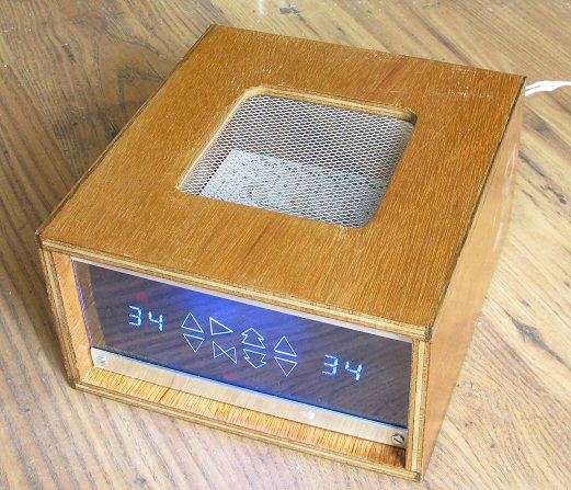

My touchsense panel:
The control symbols are etched on the back of the plexiglass and picked up by LED light shot in through the narrow edge. You can just see the (red) 'channel' and 'buffer' indicator LEDs, theyre a lot more obvious to the eye, or straight on.
IR goes straight through.
It's an constant impedance attenuator with channel selection and switchable buffer.
