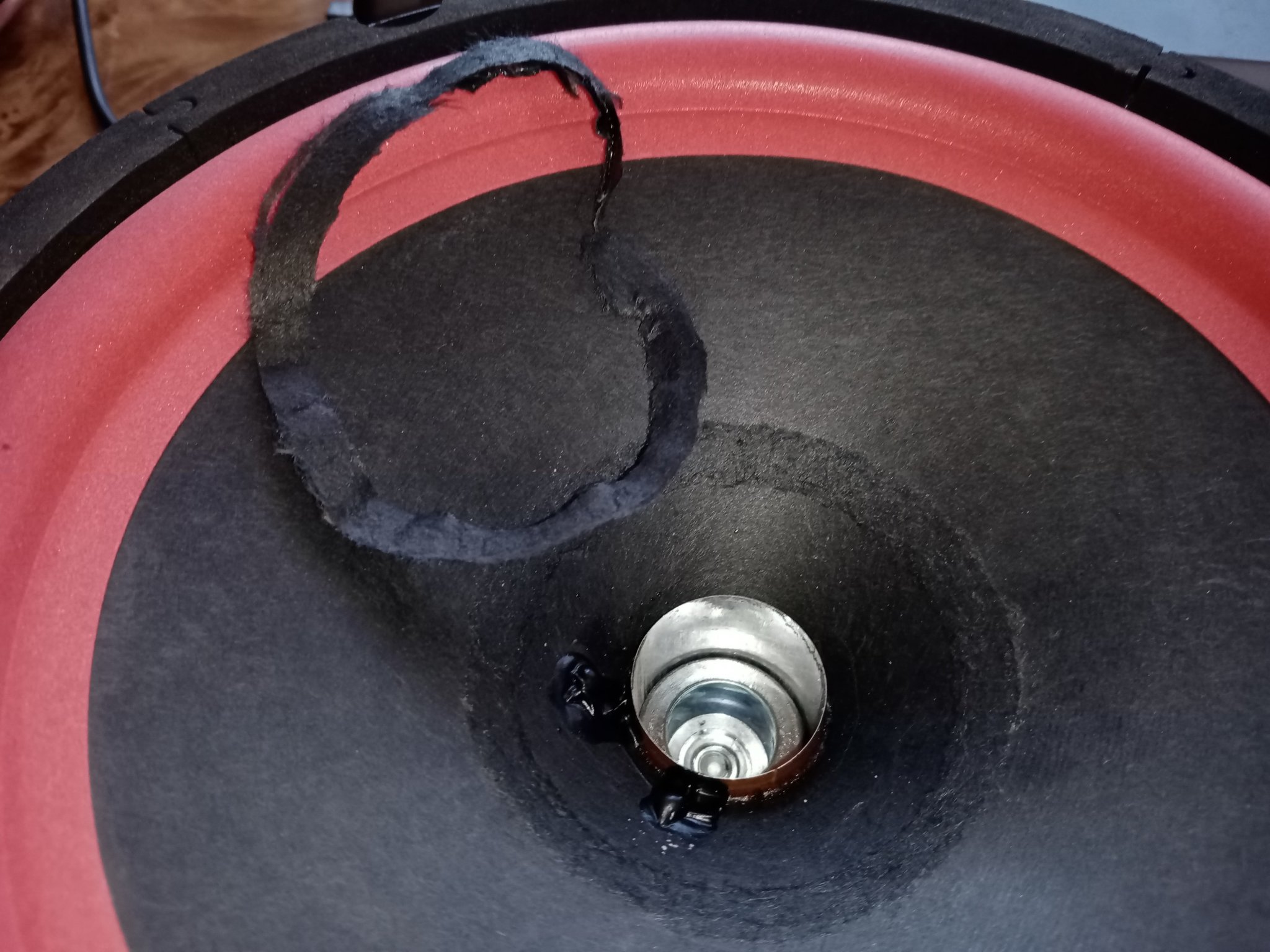

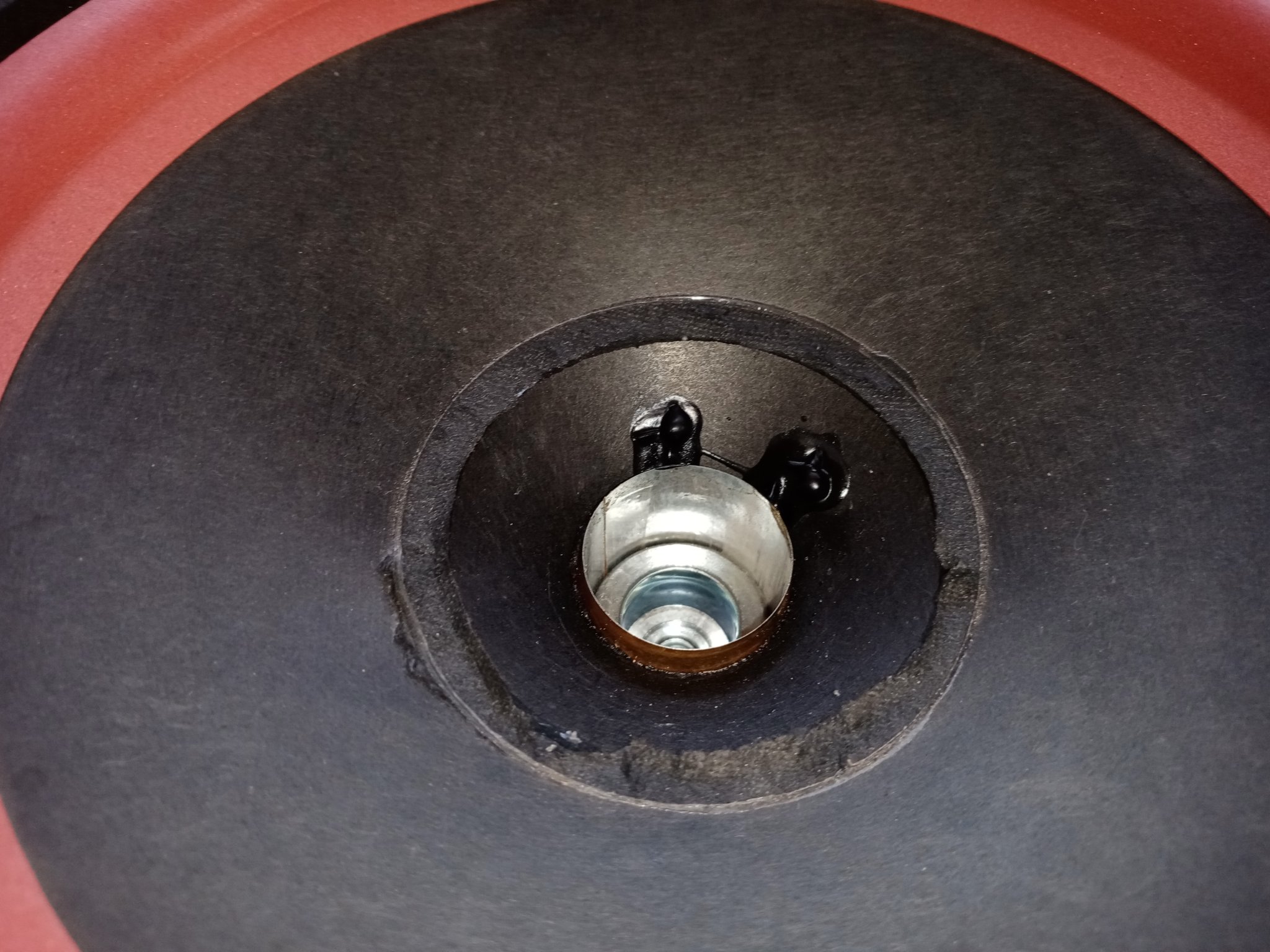

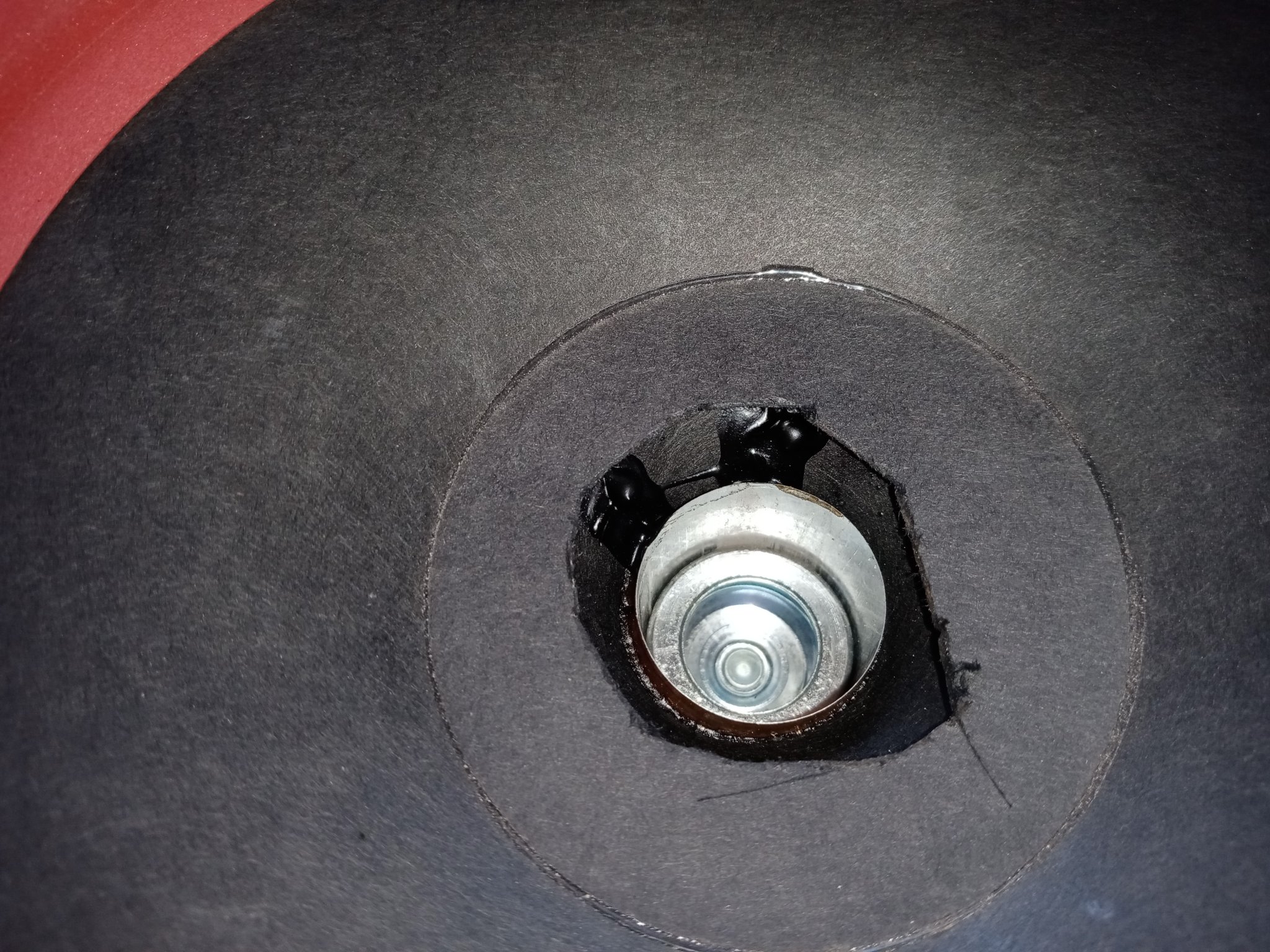

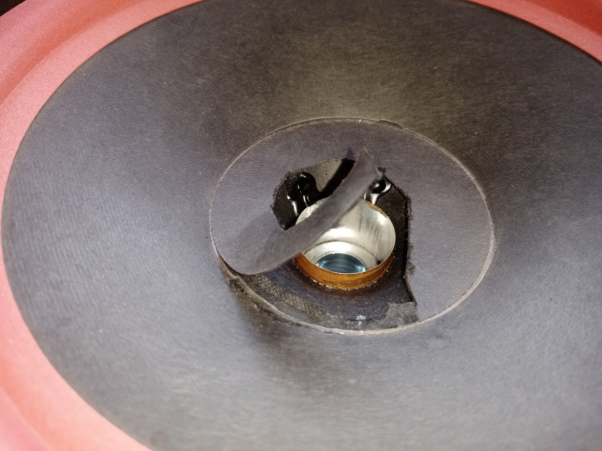

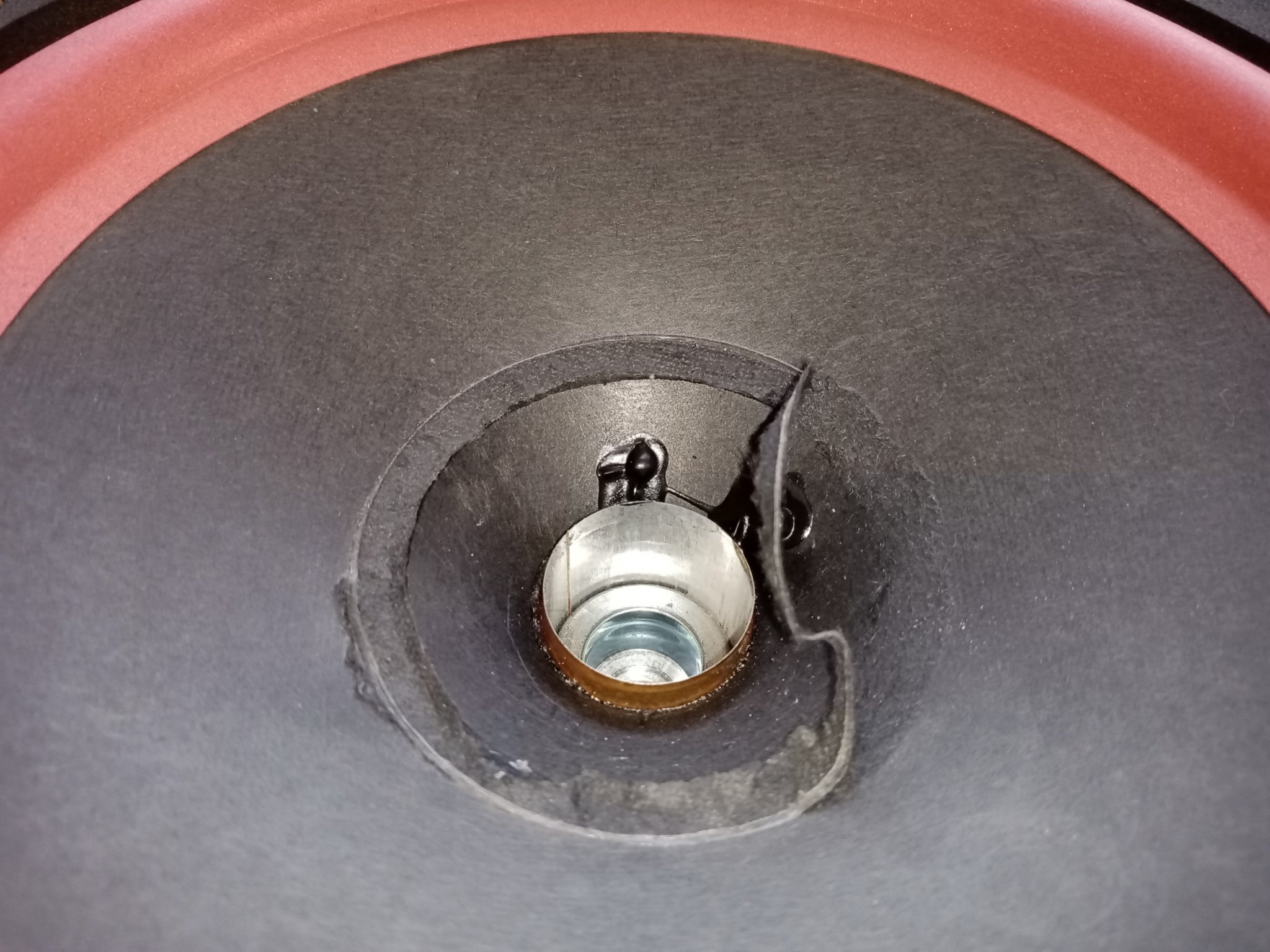

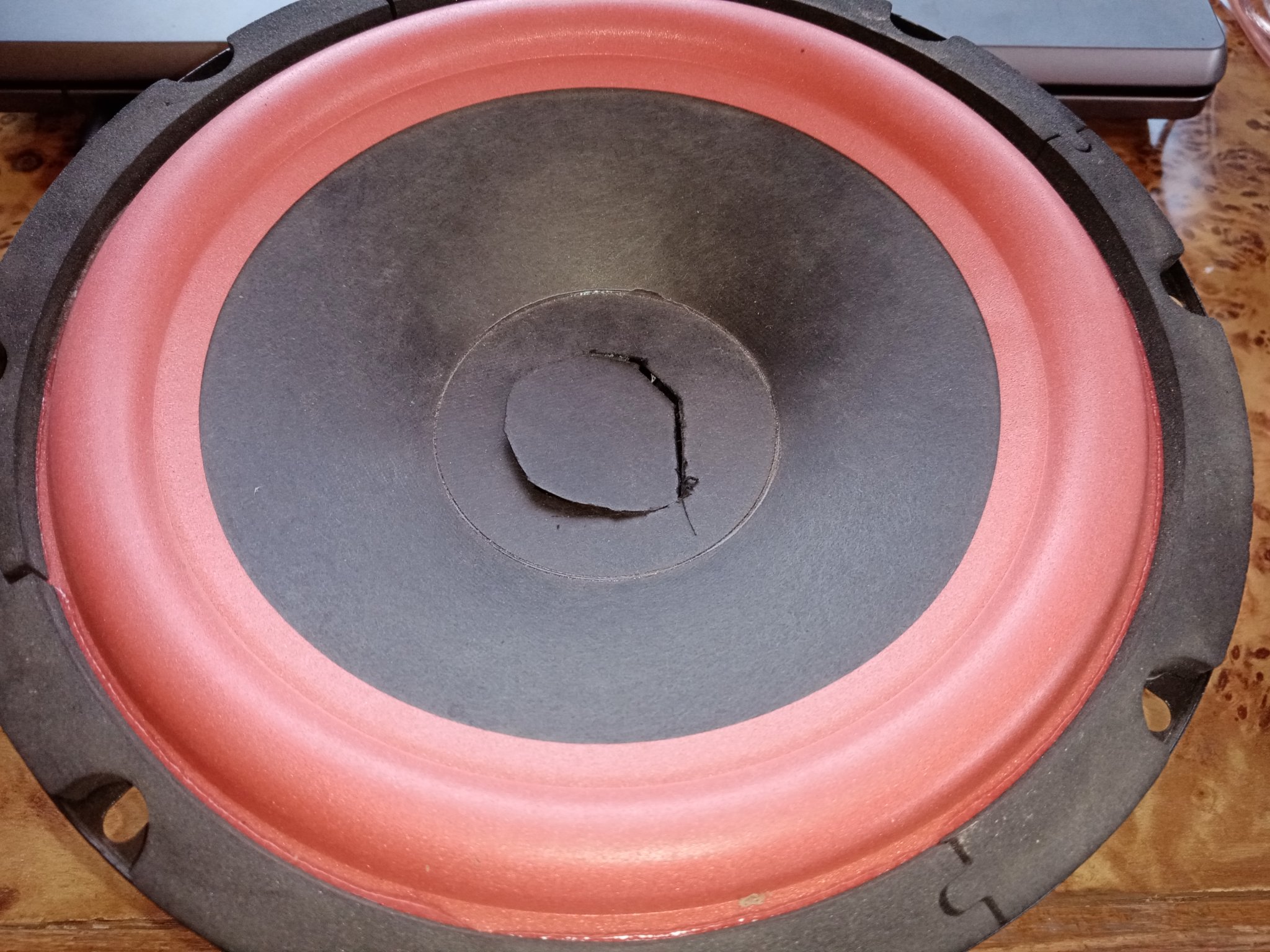

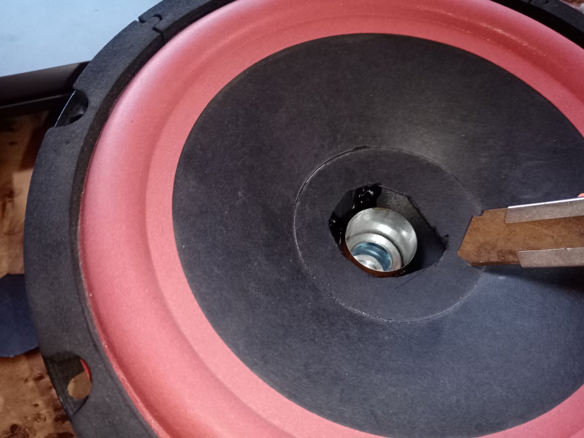

Here in pictures if you ever wondered how to remove a dust cap without damaging a driver.
With this tweak I changed a "bass driver" to a fullrange driver. Got approximately +4 to 5 decibels above 1.5 kHz.
The aluminium voice coil emanates a lot of good high frequencies usually getting lost being buried by a dustcap.
I use further dsp correction together with a current drive amp to lower distortion and get linear response.

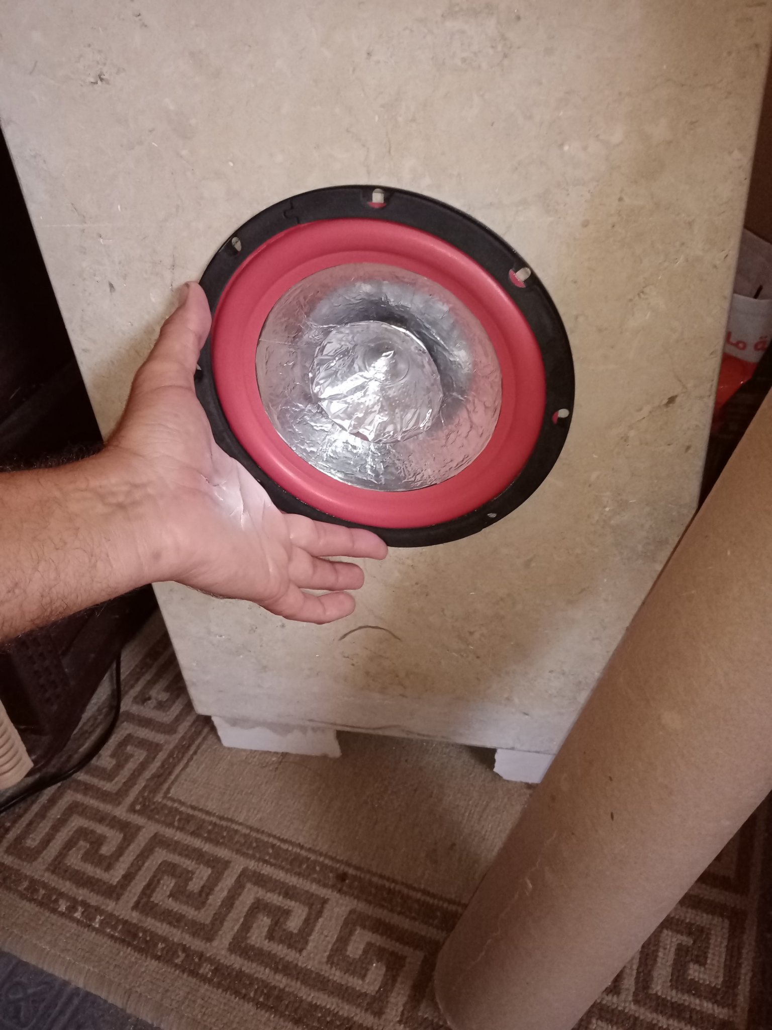

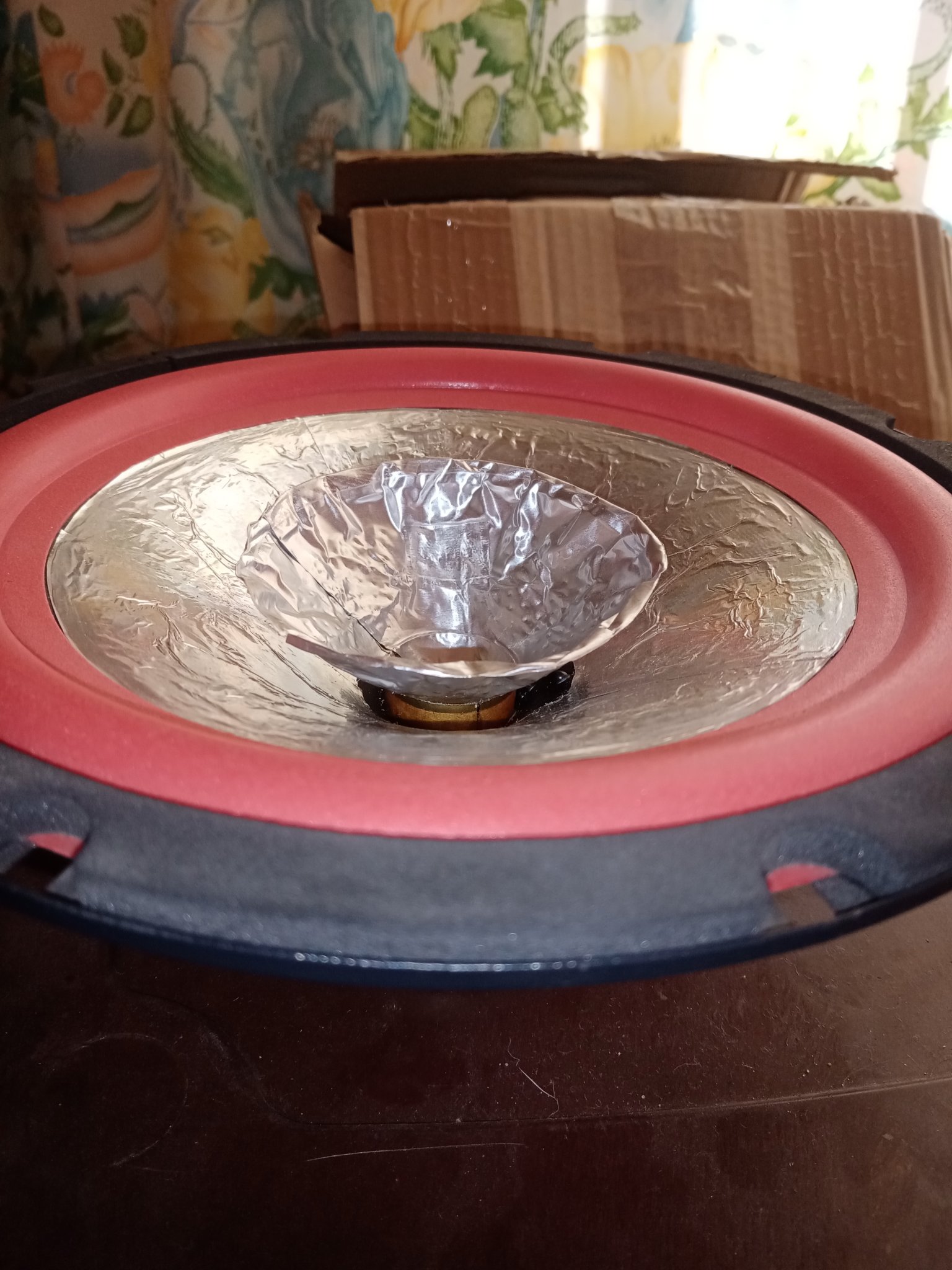

Usually I cover both sides of the diaphragm with aluminium foil to get a sandwich cone as DIY "for free"

Or you form a metal dust cap and put it directly onto the voice coil.
From measurements I know you lose some decibels on axis again but you gain some decibels out of axis as a dome emanates with wider dispersion than leaving it completely open.
If you want to keep it simple just leave it like this. Beaming in the highs can be lessened with indirect reflecting tweeters behind the box, the sides or on top.
