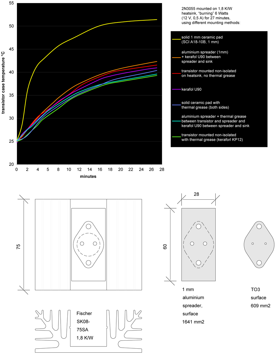

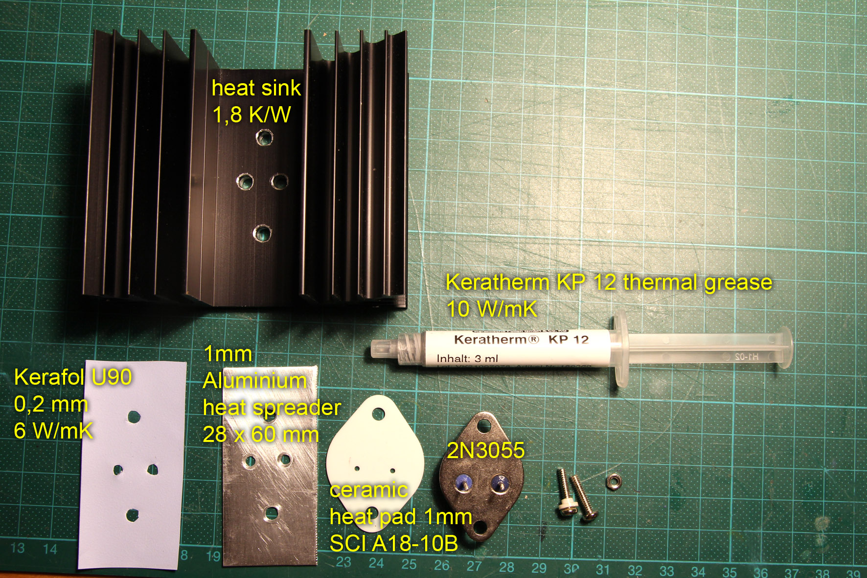

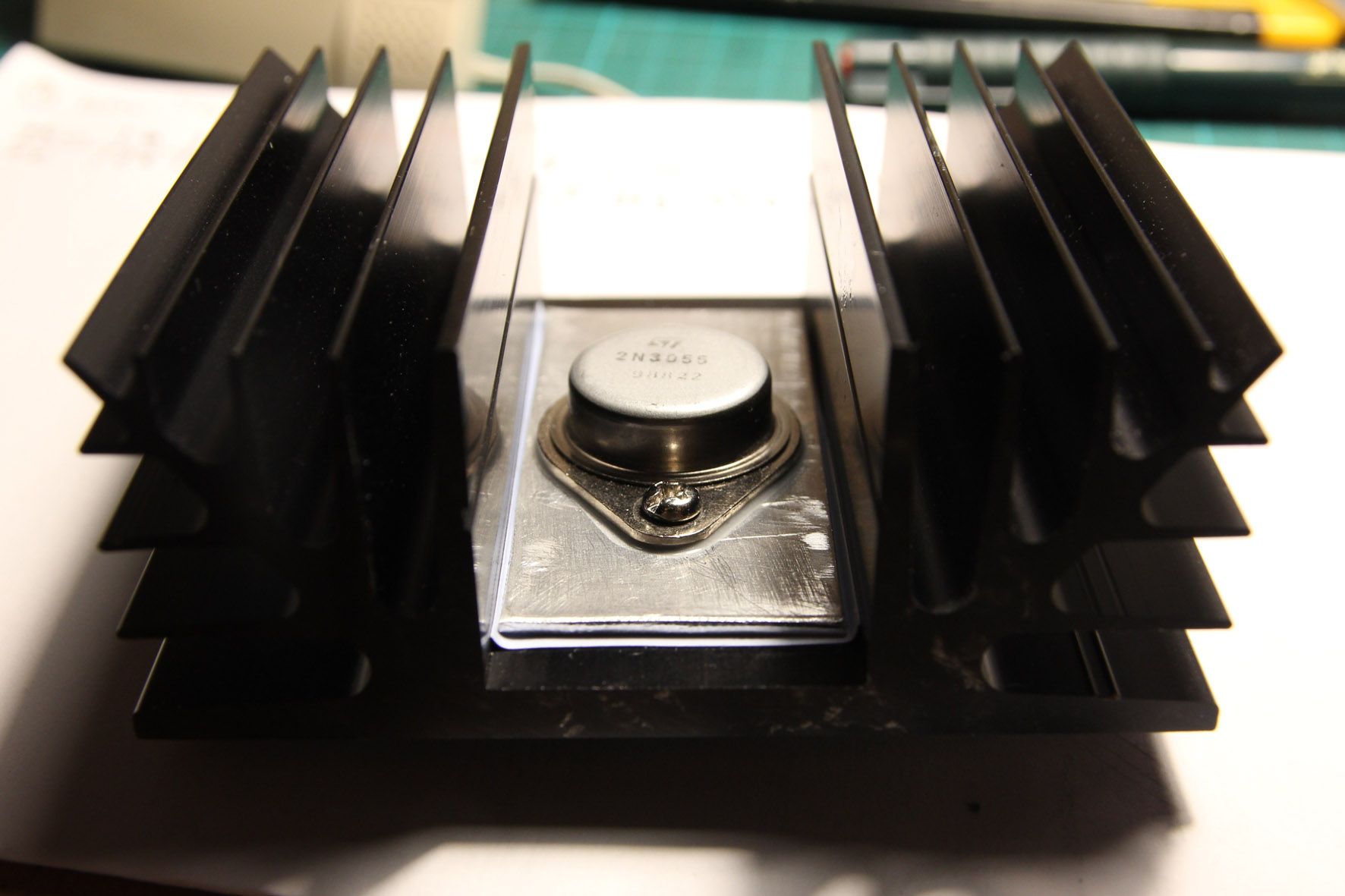

measurements
i did some tests and measurements some time ago, that may be useful.
pictures should be self-explanatory.
some findings, that may be obvious 😀:
  • any imperferction between the surfaces will hugely degrade heat transfer. this was probably the case with my ceramic pad without thermal grease. resulting total thermal resistance was 4,9 K/W of which only 1,8 K/W is heat sink to air - pure waste of heat sinks!
  • surface imperfections will be filled out using either thermal grease or soft thermal foil. in my case not using kerafol and direct mounting was worse than using kerafol thermal foil.
  • best method for isolated mounting in my test was using thermal grease, big heat spreading aluminium and corresponding kerafol film on the heat sink (total Rth=2,4 K/W). improvement was not huge, but could probably be maximized by adding more (isolated) screws and using thicker aluminium

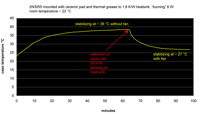

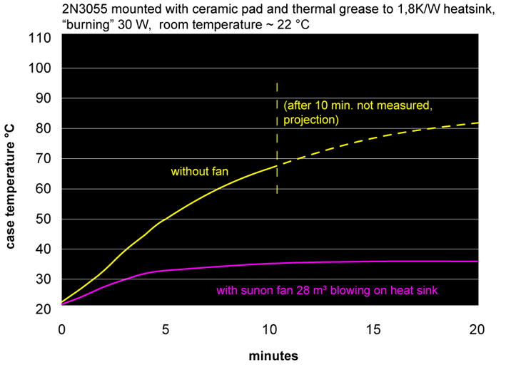

  • a fan obviously improves the thermal flow between heat sink and air. i did not expect it to be so much (total Rth was lowered to about 25%)

The mounting variants are especially telling!
The yollow, blue, and green trace!
(I shall reconsider the method I‘ll use for the connection between heatsink and spreader of my ongoing project, mighty ZM‘s old soul…)
