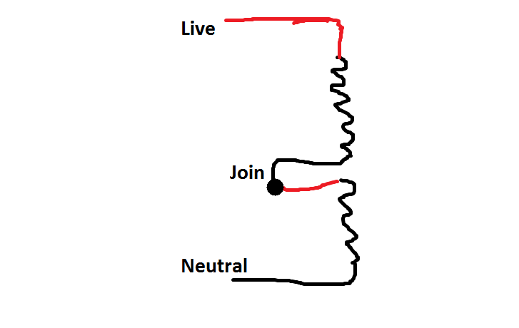

I have 2 sets of primaries and 2 sets of secondaries.
The primary is 110/220v. I understand I need to connect them in series to work with 220v, which I have.
Meaning that I'd get one red, one black and one with red+black. This red+black should be wired together and nothing else, correct?
On the secondary I need v-0-v. I was thinking doing the same there (series) would be correct, giving me v-0-v, but looking at a schematic it looks like it doubles voltage?
The primaries are (most probably 😉) wired as you say.
The secondaries also go in series.
We remove ALL doubt by using a bulb tester in the primary mains feed. This allows the transformer to work correctly if you get it right, and lights the bulb if you get it wrong.
With the transformer powered up you measure the AC voltage of each individual secondary and confirm they are as expected.
If that is good then you join them in series and measure the voltage from 'end to end'. You should see double the voltage of what you just previously measured because both are now series connected and the voltages add.
If you see little or no voltage then you reverse the connections to one of the secondary windings and retest.
Once more just to make it clear in my tired mind; I take that primary red+black connection and dont use it for anything else. The only wires I'll be using is the red from one winding and black from the other winding?

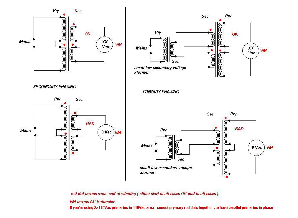

maybe this will help
