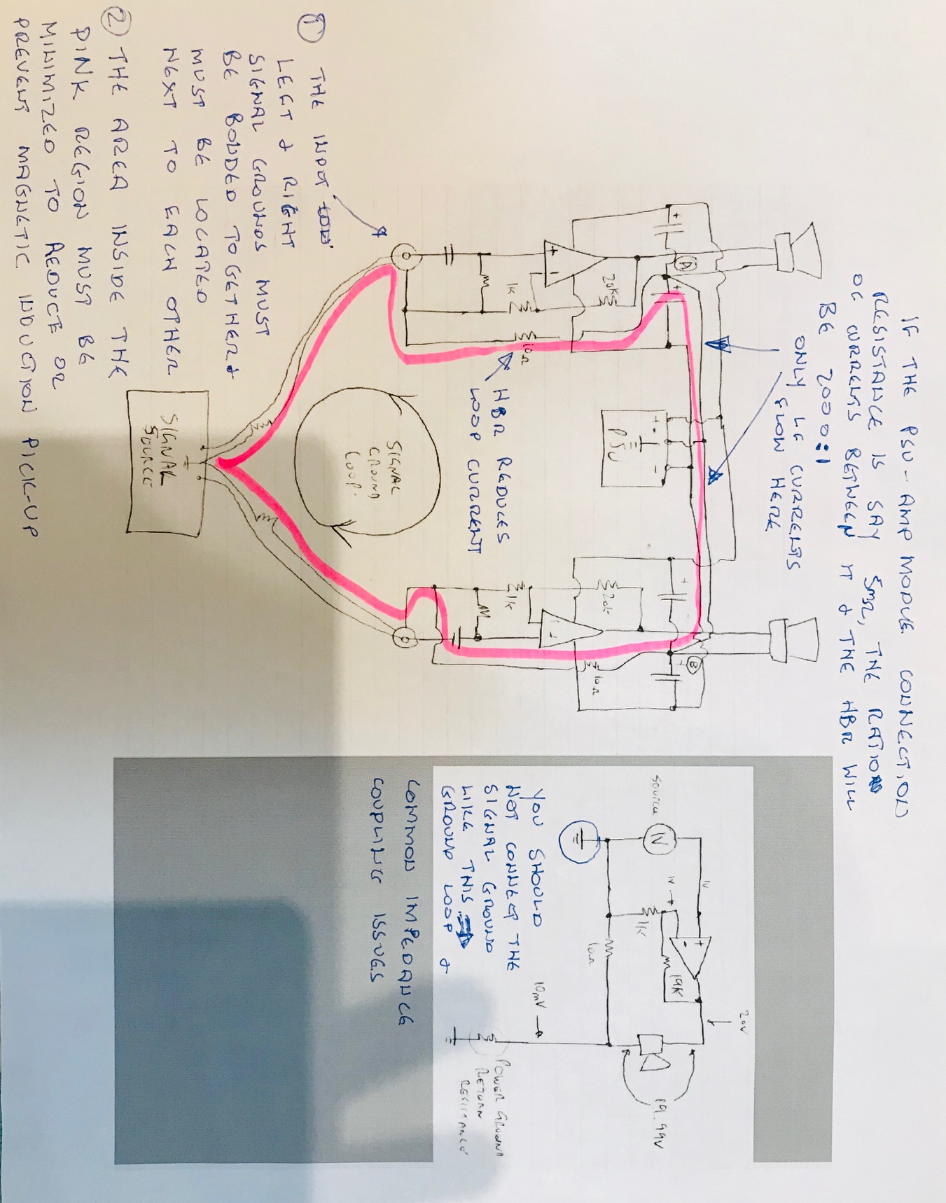

I hope you aren't thinking about the diagram I posted in Cordell's thread, because I'm not. I was just answering your question. That diagram was something totally different from what I'm discussing here. I am assuming you mean a typical amp, where you just move the speaker return off the PCB. I didn't expect you to carry context over into a new thread without explicitly saying so, that would just confuse everyone.
Here is a look at Poldaaudio's set-up and how I'd approach it.
I have an amp with a similar set-up to that shown in the diagram. But, I located the input connectors next to each other and bonded the connector grounds together and then ran the screened cable directly to each amplifier module input - so the shortest route from connectors to modules. If I ran the screened cables together to the fist module and then continued the second screened cable around the front of the amp all the way around to the second module, it was much quieter (talking -110 dBV vs -90 dBV). In the second approach, the loop area between the two amp modules in minimized, so the cross channel loop current is minimized. I use 15 Ohm HBR's but also got good results with a 3.3 Ohm.
If you bond the input connector grounds together, and locate them next to each other, you trap cross channel ground loops inside the amplifier. In the attached diagram, having them separated and not bonded means you have a large loop area for noise pick-up.
