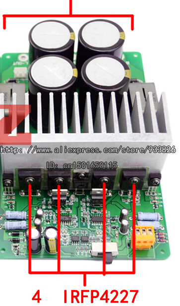

Btw, the graphs show this is a 200 watt amplifier, not a 2kW amplifier.
It wants +/-70vdc max, although it appears to make the same power with only 50vdc.
I think it wants +/- supply.
Not sure where they are getting the higher power specs - so either the spec or the graph is wrong - best to check that out first. Ah, I see bridged mode is higher power. Ok

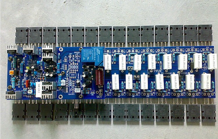

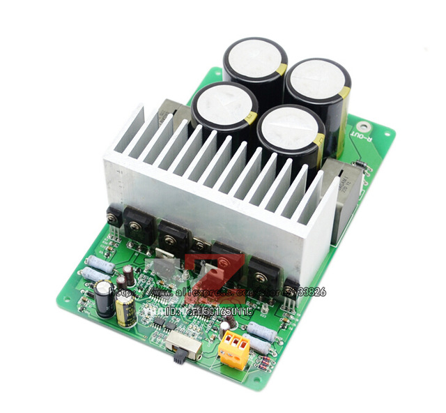

I have 2 option only either Class AB or the Class D
For 4 Ohms 1000watt Subwoofer use which amplifier should i get?
Class AB in the screenshot ?
Or
Class D in the screenshot
Why do you think you want to bridge that amplifier??
Suggest you run it first and see how loud it goes??
Also, I only see a picture, without specs it is impossible to know what it is capable of...
You also need to specify the load/speakers... number of speakers, specs, how many per channel?? etc.
450watt@8ohms %1THD
800watt@4ohms %1THD Capacitor required +-40mf rails

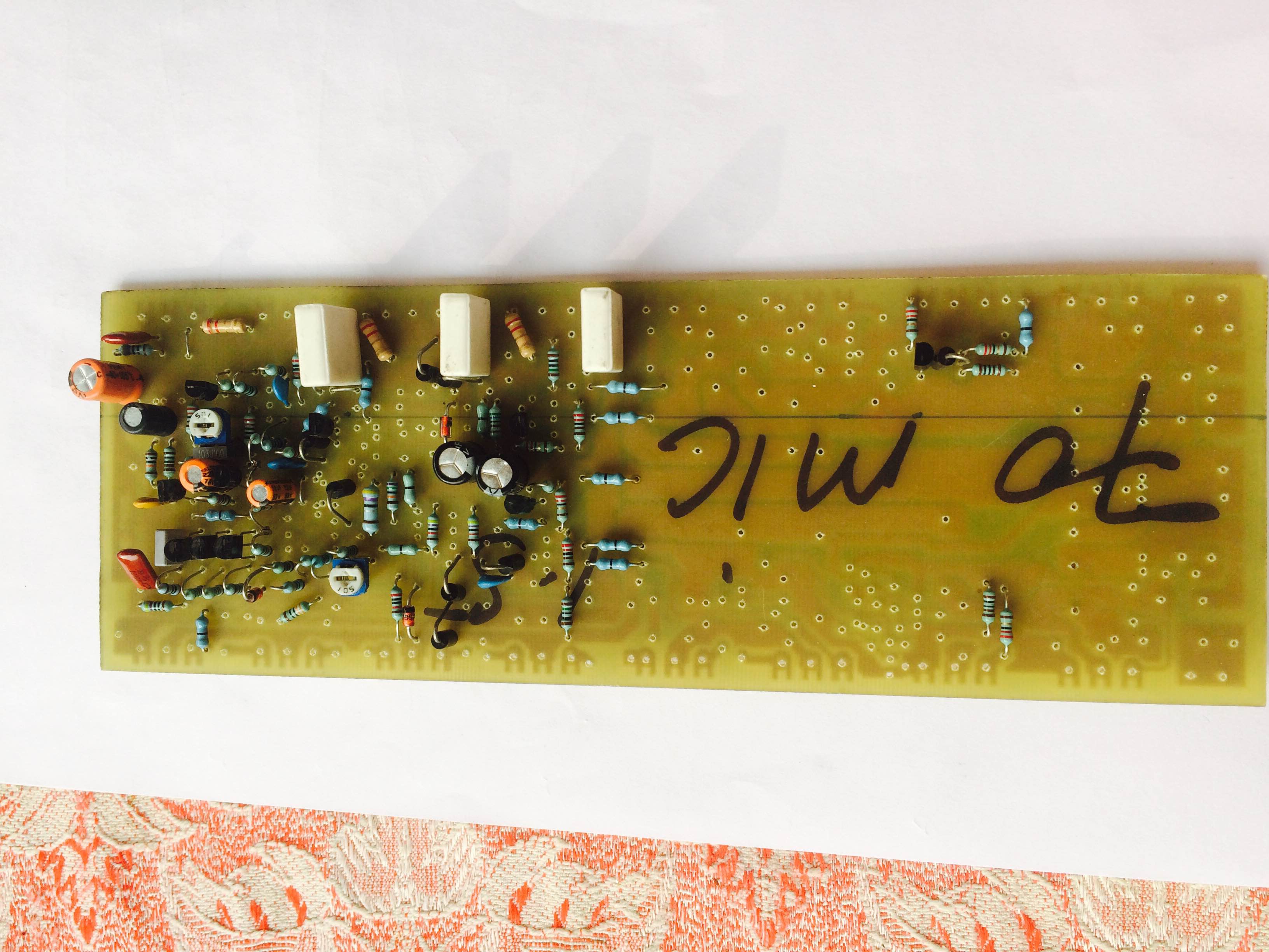

Hello Friends
I am getting a hum noise when i combine both the input together "Input++" and "Input Gnd,Gnd" when you raise the volume the hum sound can be heard.
But when i connect each amplifier board to different sources there is no noise.
The amplifier runs on a single dual power supply Ac 80-0-80 Ac
How can i connect these 2 amplifier boards to 1 source without a crossover?

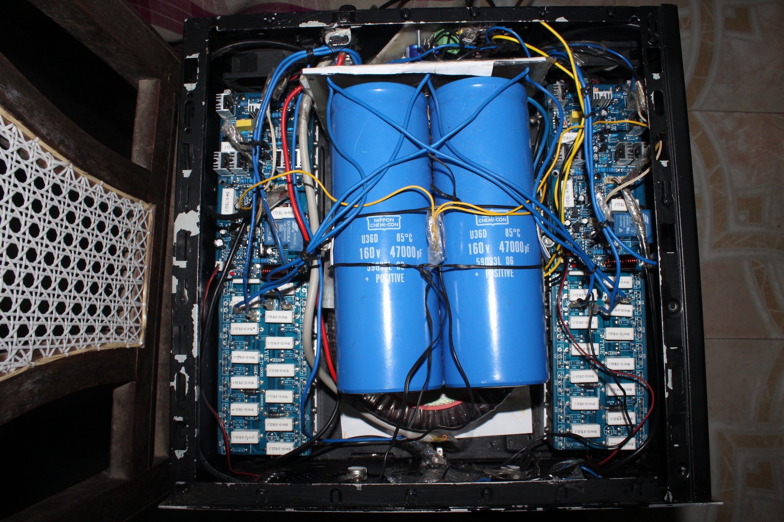

TN5 HD AMPLIFIER
Hello Alcino
greetings AB class at such high voltage rails is disaster try HD class
fewer output pairs and less heat dc rails 150 DC+/- NO low voltage
rails
warm regards
Andrew😉
