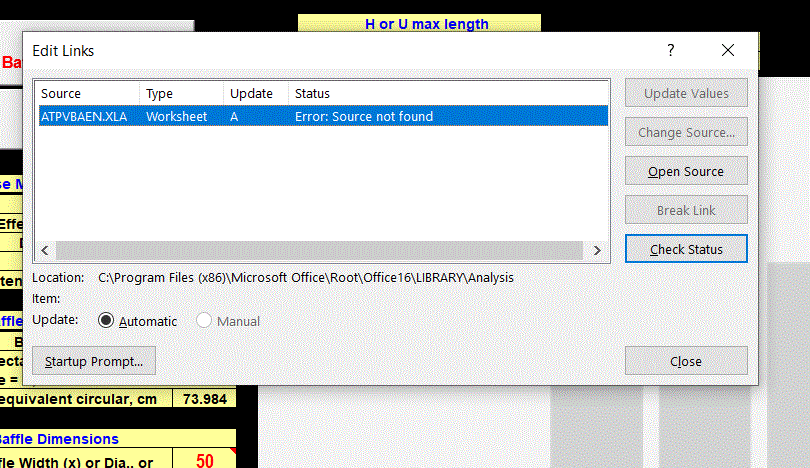

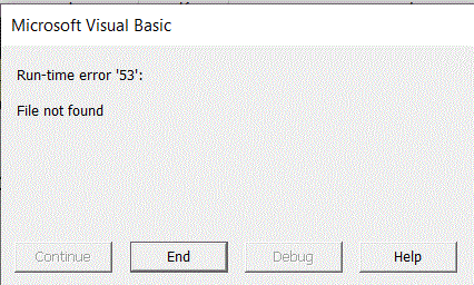

I'm going off a long memory here but can you install the analysis toolkit.. eg File>Options>Add-Ins
I did do that but there was another problem. The .CHM file was not showing any text in the right pane so I couldn't see the install instructions but I spotted in the word document that the generated .TXT file needs to be in the same folder as the .XLS file. I fixed that issue and now it works fine.
