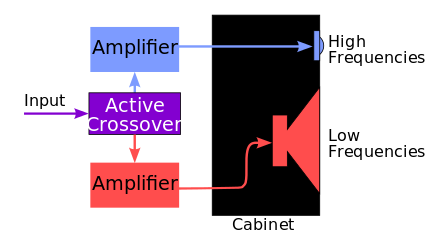

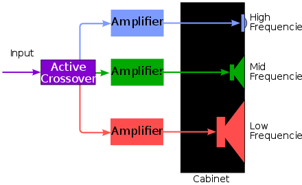

I am working on a 2.1 "active" 3 way setup where both the front speakers are each a 3 way Speaker. But instead of having a traditional hardware crossover, it is completely controlled digitally, with filters and room correction.
I can fully control 2, 3 way speakers because my Xonar U7 MKii has enough outputs. (7) I can not fully control a 5.1, or 5 speakers, each being a 3 way, needing 15 outputs, for example.

E.g. Benhringer UMC1820 can do 20ch out.
But the question is if you want to take 3 analog cables (presumably balanced) to each of your speakers. IMO you could benefit from Charlie's project synchonized streaming to multiple clients/loudspeakers - RPi by each speaker with 5.1 USB soundcard, connected via ethernet or even dedicated wifi, running the xover for the given side. But it would take a substantial bit of configuring in linux.

When you say active speakers does that mean you control each driver in a 3-way speaker from your PC (or a separate 3 channel DSP) individually?
I've heard that called bi-amping, even though your speakers are tri-amped or quad amped with a four-way speaker.

It sounds like the reason you want so many channel connections is because you're running three separate wires into the back of one speaker. In that case, your crossover might be on your PC and you want to send the output to each driver in your three way speakers.
